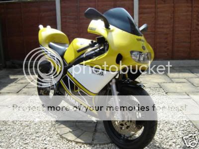

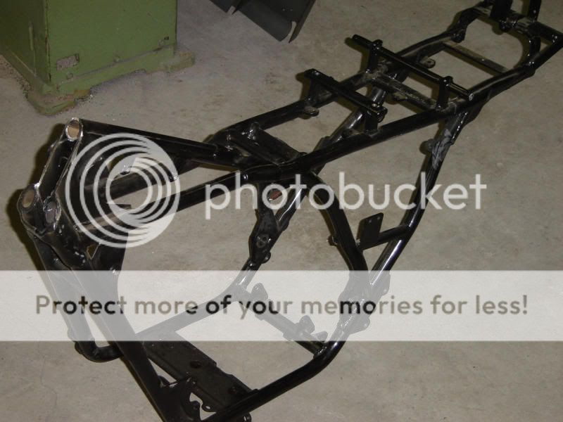

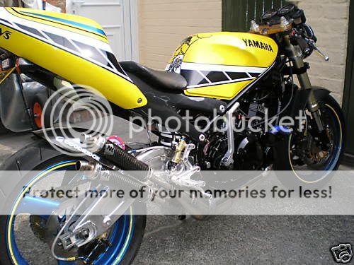

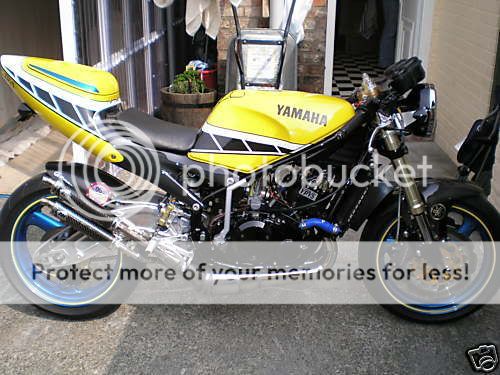

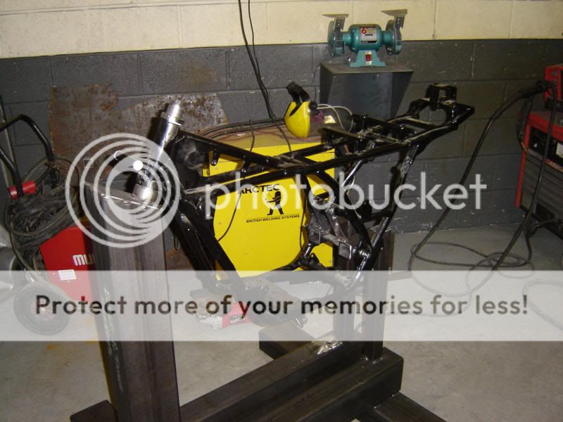

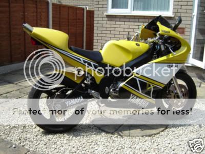

Basics, one of hand made frame, one of pipes etc, one of reverse cylinder rd 400 , one of extended lc swing arm. Loads of FZR, TZR,RGV bits and some more one of bits here and there.

the back end looks a bit too jacked up for me but apart from that it looks really good

Looks like you done a great job looks good
Dunno about the backend though otherwise awsome Thumbs Up

Interesting place to mount the "rear" shock! Also... are the exhausts coming out the back of the engine?

Reverse cylinder Thumbs Up

Im not totally up for the rear end, think im going to turn the pipes upside down which will lower the end cans, make them a bit flatter. I also think im going to get rid of all the plastics and put straight bars on the front. Ill have to just go to a local breakers and try new rear plastics etc to see what will fit.
All that isnt so important, whats important is all the great one of stuff thats been made for this bike and how it handles, which is mad. We recon its making about 55-60 bhp as it all polished and ported etc. Not bad when the 400 only had 40 when Yamaha produced it.

I agree about the rear end, a set of USD forks would look the tits.
What sort of power is it putting out?
How does the rear suspention work?

The rear end is not very nice at all, just a bit too high otherwise it might look ok, i'd also have the end of the cans cut back so they dont protrude past the seat line, maybe just the ends of them but no more.
But saying that, the bike is possibly the best project i've seen on here.
Very nice! Thumbs Up Mr. Green

Please don't get rid of the fairings, they look amazing and it's the ultimate RS sleeper. What did you get the rear-end off of?

I know it's ben said, but it's mint apart from the tail. It's at completely the wrong angle. Bring it straighter so that if you extend a line from the top of the tank it would line up with the top of the tail. Thumbs Up

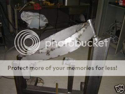

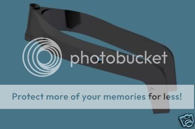

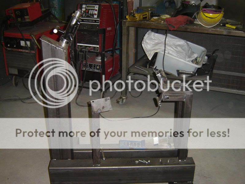

The insert was his first go ten years ago, he then fancied a change and had the kind of job where he could spend some time on a cad system to sort a modern frame. The first thing was to put the old frame in a jig to get the geometry right. The he cut the head off TIG weld onto the CAD steel frame. Some images below that walk you through this stage, i have to say the guy is amazing.

So all the angles etc are just right, I was told about 30-40 days were spent just designing the frame and getting it all ok before spending one and half days building the frame.
