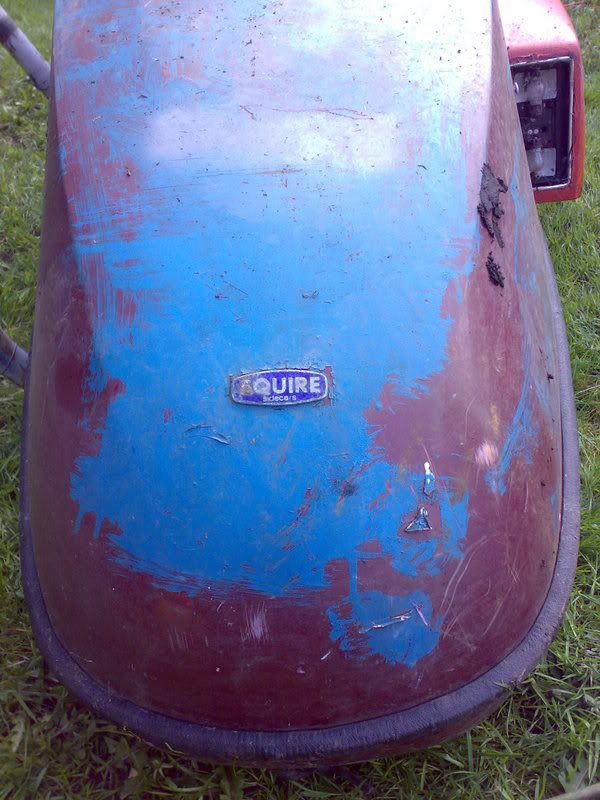

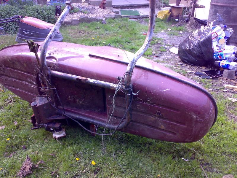

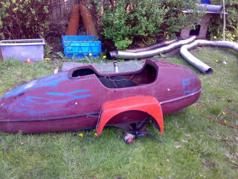

https://i12.photobucket.com/albums/a229/Yambabe/15042007053.jpg
https://i12.photobucket.com/albums/a229/Yambabe/15042007054.jpg
https://i12.photobucket.com/albums/a229/Yambabe/15042007055.jpg
mr.z
Joined: 04 Feb 2004
PostPosted: 21:54 - 16 Apr 2007    Post subject: Reply with quote
Wow the really is disgusting, i really like it.. how long is it from end to end? + do you have any pics of the original mounting bracketry?
(must say I'm sevearly tempted)
yambabe
PostPosted: 22:16 - 16 Apr 2007    Post subject: Reply with quote
It's been off the bike for over 15 years so sorry no bracketry!
Himself says he thinks he used scaffolding clips last time he had it attached (it was on an XS500 at the time). It was clamped on near the back shock (2 clamps), near the front of the frame and he says he thinks somewhere near the top yoke. He says all the brackets he had were "swivelly" so they could be adjusted and they were all home-made.
He reckons it would go on a CX no problem....... Wink
