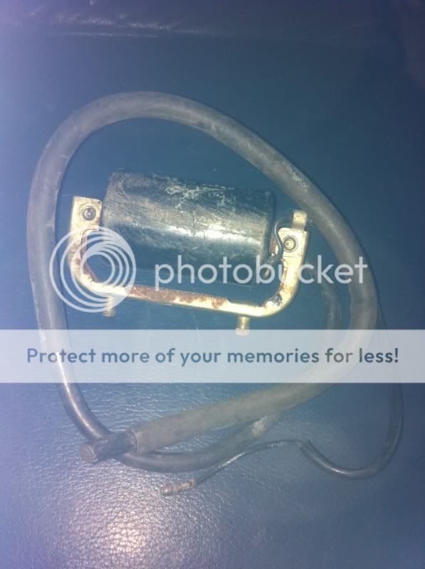

Alex_
Joined: 30 Jan 2011
PostPosted: 19:35 - 03 Feb 2011    Post subject: Reply with quote
no mate this one doesent Mad just one wire black and white, i thought the c50/c70/c90 6 volt coil were the same?
https://i34.photobucket.com/albums/d129/ll_sarah_ll/IMG_0146.jpg
