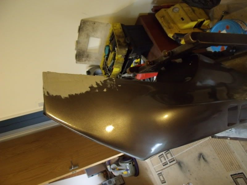

some moding on the custom rear end
https://i31.photobucket.com/albums/c357/satelliteone/TZR%204DL/GEDC1241.jpg
https://i31.photobucket.com/albums/c357/satelliteone/TZR%204DL/GEDC1252.jpg
https://i31.photobucket.com/albums/c357/satelliteone/TZR%204DL/GEDC1259.jpg
https://i31.photobucket.com/albums/c357/satelliteone/TZR%204DL/GEDC1233.jpg

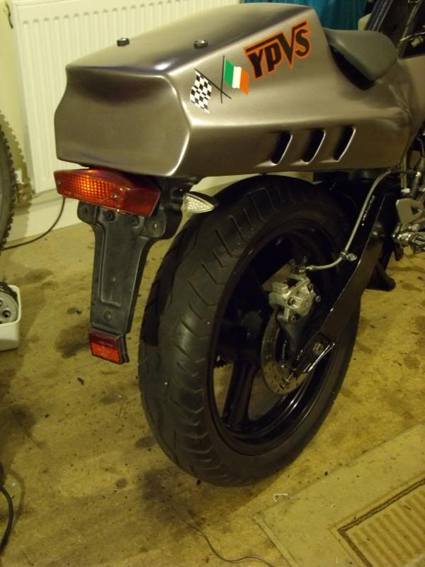

finished spraying up the rear end today, got it more flush to the tank.
https://i31.photobucket.com/albums/c357/satelliteone/TZR%204DL/GEDC1414.jpg
https://i31.photobucket.com/albums/c357/satelliteone/TZR%204DL/GEDC1403.jpg
https://i31.photobucket.com/albums/c357/satelliteone/TZR%204DL/GEDC1417.jpg
just need some speed block decals, and a custom rear light. R1 looks or even a twin square stop and tail.

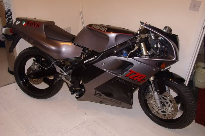

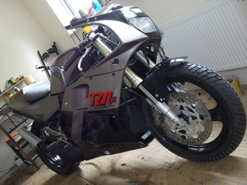

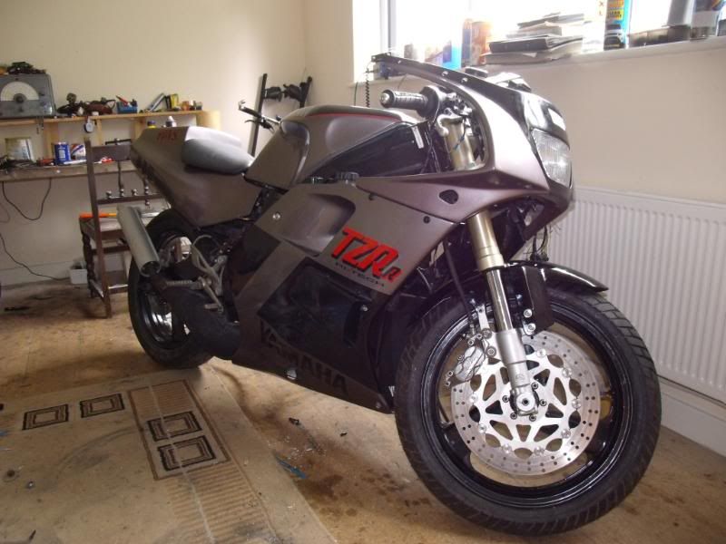

trial fitted the fairing, rad scoop also
https://i31.photobucket.com/albums/c357/satelliteone/TZR%204DL/GEDC1459.jpg
looks great, two brackets missing for the bottom, iam going to make that up tho.. easy peasy..

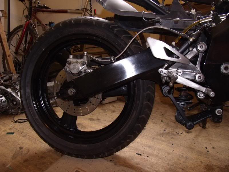

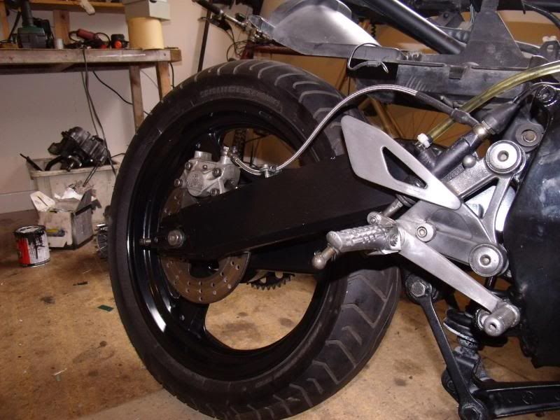

fitted the brake line, bled the system, caliper is on feels great, nice!
https://i31.photobucket.com/albums/c357/satelliteone/TZR%204DL/GEDC1481.jpg
https://i31.photobucket.com/albums/c357/satelliteone/TZR%204DL/GEDC1474.jpg
clipped up the fairing with zorst, making sure its not touching anywhere..
https://i31.photobucket.com/albums/c357/satelliteone/TZR%204DL/GEDC1477.jpg
bottom braket to fit
wondering what lights and plate holder to buy,..

Hmmm! sub frame looks twisted Smile and f*ck me! your chain is loose Shocked
satelliteone
Joined: 08 Feb 2007
PostPosted: 23:03 - 09 Sep 2011    Post subject: Reply with quote
i knew somthin didnt look right!...lol..

cleaned up the rear end
https://i31.photobucket.com/albums/c357/satelliteone/TZR%204DL/GEDC1610.jpg
https://i31.photobucket.com/albums/c357/satelliteone/TZR%204DL/GEDC1609.jpg
rear end lights fitted
https://i31.photobucket.com/albums/c357/satelliteone/TZR%204DL/GEDC1654.jpg
https://i31.photobucket.com/albums/c357/satelliteone/TZR%204DL/GEDC1642.jpg

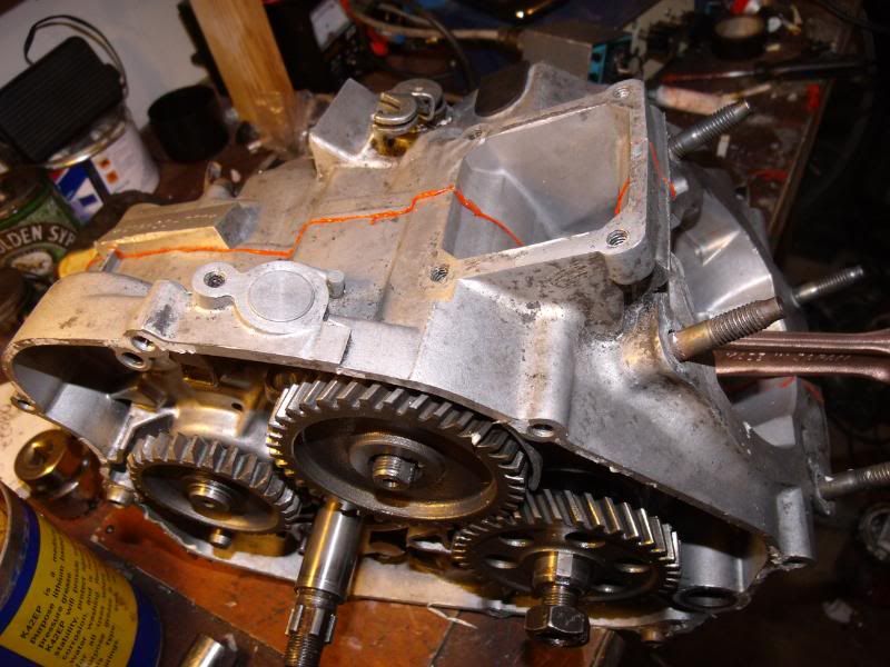

crank came back from PJME, new conrod kit and balanced.
https://i31.photobucket.com/albums/c357/satelliteone/TZR%204DL/GEDC1669.jpg
new seals
https://i31.photobucket.com/albums/c357/satelliteone/TZR%204DL/GEDC1668.jpg
https://i31.photobucket.com/albums/c357/satelliteone/TZR%204DL/GEDC1667.jpg
cleaned all the faces.
https://i31.photobucket.com/albums/c357/satelliteone/TZR%204DL/GEDC1670.jpg
now bolted back toghter
https://i31.photobucket.com/albums/c357/satelliteone/TZR%204DL/GEDC1673.jpg
https://i31.photobucket.com/albums/c357/satelliteone/TZR%204DL/GEDC1674.jpg

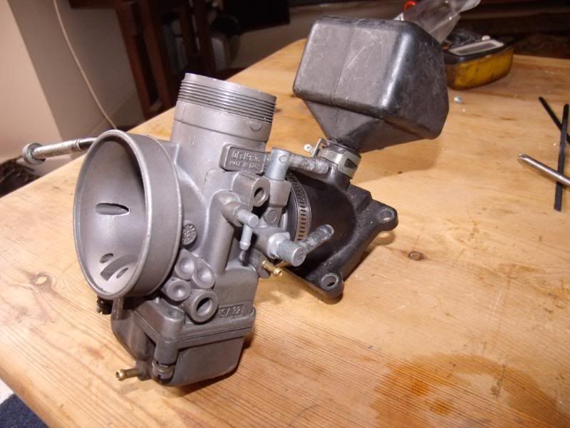

reeds reset
https://i31.photobucket.com/albums/c357/satelliteone/TZR%204DL/GEDC1585.jpg
carb rebuilt.
https://i31.photobucket.com/albums/c357/satelliteone/TZR%204DL/GEDC1583.jpg
standard inlet vs 4DL inlet..
https://i31.photobucket.com/albums/c357/satelliteone/TZR%204DL/GEDC1581.jpg

Rear light would look a lot less like an afterthought if you cut it into the tail fairings.
Or even get a sexy little LED tail/brake light so you can just bolt it on top of the rear fairing.
It reminds me of when people import an old Jap car and have to bolt a fog light under the bumper, and it just looks shite.
Bike's looking good though.

Looks very similar to an RGV250 rear end, RGV lights would look good on that;
(Not an RGV but an RGV rear end none-the-less!)
https://i258.photobucket.com/albums/hh258/JoeSnowden/Bros/6dab2be9.jpg
Seems like a steal for 250 quid, I bet the front end alone is worth that!
Joe
satelliteone
Joined: 08 Feb 2007
PostPosted: 11:43 - 10 Sep 2011    Post subject: Reply with quote
I was going to go down the custom look, with LED idea, and i think some of the older tzr`s had the light in the tail. I might change it in a later date. I am off to the bike breakers soon ish, and have a scat around to see what looks best to suit. Iam not too happy with the rear. as is, just making it road ready MOT friendly for the min.
I do admit, that the uglyist part of the bike.
Plus i have a flat place for the L plate to sit.lol
thanks for the feed back tho..and i do like that twin square rear end bandit.. would suit my bike.. mmmmmmm...mmmmmmm nice.

and my new rear tyre.. sportsmax 150/60 17 sticky..
biggest i can get in the swing arm.
https://i31.photobucket.com/albums/c357/satelliteone/TZR%204DL/GEDC1695.jpg

put the fairing back on, put the bike away in the corner, now tidy the workshop. looking sweet so far..front indi are now on..the fairing bolts up perfect.
https://i31.photobucket.com/albums/c357/satelliteone/TZR%204DL/800-600.jpg
next is to get the head rebored, new piston on order too.. gearbox oil. and fuel in the tank... wayhay!
