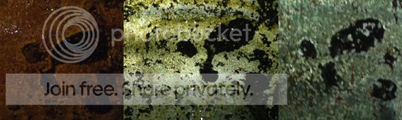

And the final shot of the tank.
https://i1148.photobucket.com/albums/o574/_Iain_/8C917C55-063A-4C05-95F1-1C512672EDD3-2568-000003006C25B3BA.jpg
Whilst it's not perfect, from start to finish, the whole process has taken 5hrs & cost me a pot of tesco's cheapest table salt. I'm impressed to say the least, and have edited together three pictures. The shot from the beginning, the shot from halfway through, then the shot after final rinse. Something of an improvement.
https://i1148.photobucket.com/albums/o574/_Iain_/beforemidafter.jpg
That black mark had been in the tank from the day i got the bike, perhaps someone dropped something in it in the past. I dont know tbh.
Now carb cleaning, and hopefully a few months of trouble free running  ____________________ Please be aware that the above post may be full of complete nonsense.
