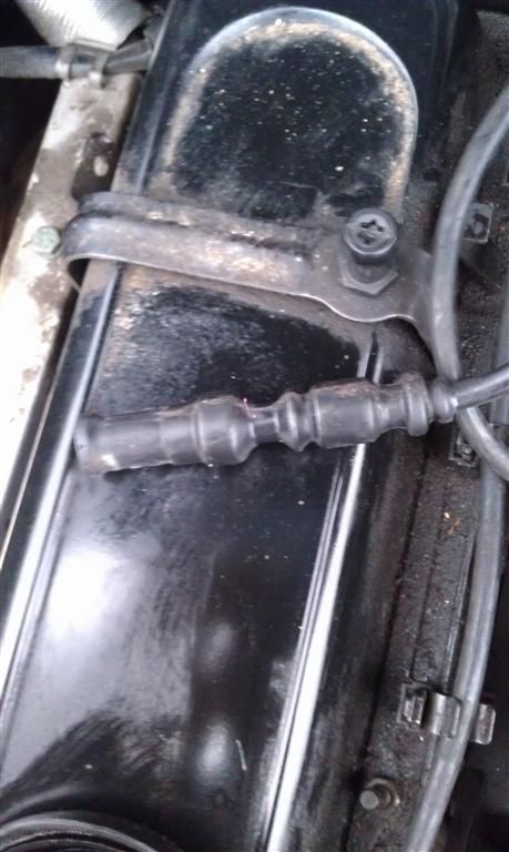

right i think i cracked it,
i thought since its a wasted spark system, it would fire on both 2 and 3 at the same time,
so swapped lead 2 on to plug 3, and if still was running on 3 cylinders then it was going to be lead related,
if it started running on 2 cylinders then it was not, and was definite issue with cylinder 3 by itself,
what do you know it ran the same, (cylinder 2 was now dead, but cylinder 3 was running fine) also noticed that the metal surround of the lead was sparking on the rocker cover, hmmmm
i pulled the cover off and tried again, and spied this
https://i58.photobucket.com/albums/g257/hmmmnz/IMAG1154Medium_zps6deb81d5.jpg
you may not be able to see it, but in the center of the plug top there is a pin prick and a spark is escaping and earthing itself, thus taking the easiest way home rather than through the spark plug,
ive wrapped it insulation tape popped it on cylinder 3, started the car,.... ran perfectly
so there you go, f*cken metal surrounded plug ends, dumb sh*t,
