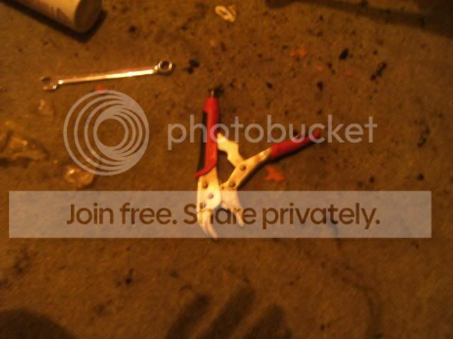

Molegrips (not sure if they are called this in other countrys, I will post a picture of them when needed)

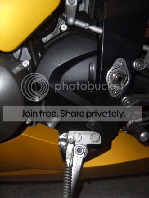

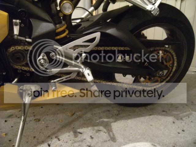

Ok, so first off, you need to remove the sprocket cover -
https://i6.photobucket.com/albums/y209/angelgrinder187/DSCF1910.jpg
Remove the one bolt from the top, and 2 from the bottom. Once these are out, you need to wrestle the cover out - it can be quite awkward, but the plastic is strong and flexible, so don't worry about being gentle!

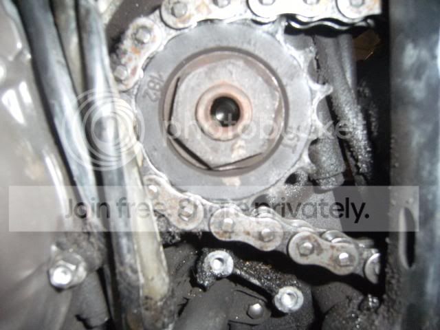

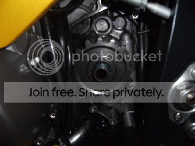

Now, you can see the front sprocket, and behind it, the locking washer with a folded over edge. On this picture, it is on the bottom left hand side. Use a screwdriver/pliers to get this folded back out.
https://i6.photobucket.com/albums/y209/angelgrinder187/DSCF1912.jpg
Now, get a friend, and your 36mm socket. Get friend to stand on otherside of bike, pushing down on the front and rear brake to stop the bike moving. Make sure the bike is in neutral - you don't want to damage the final drive systems....I can't imagine any of that is cheap to fix!
Now, undo the nut on the sprocket. Not all the way, just loosen it off. (Note - You can do it with just yourself, I managed to tighten it myself. Sit on the bike, on the sidestand. With your right hand and leg on the brakes, use your other hand to use the wrench on the nut).

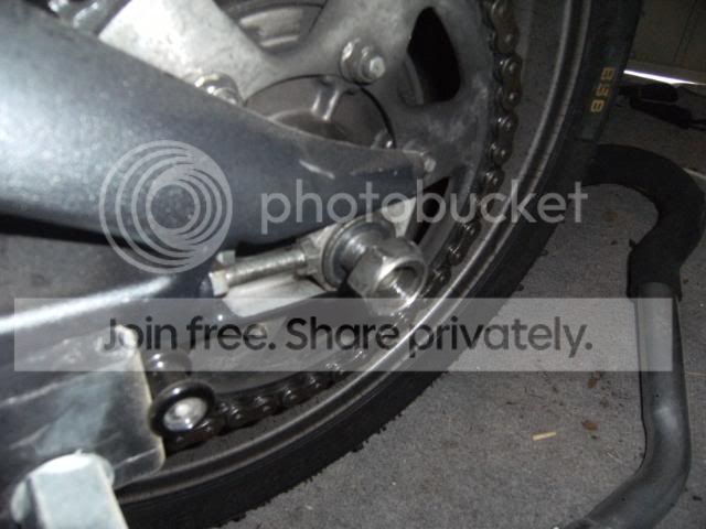

You need to get the rear wheel out, first, back both chain adjusting bolts right back to the front. Now take off the 27mm nut, and remove the washer and adjuster block....
https://i6.photobucket.com/albums/y209/angelgrinder187/DSCF1913.jpg
https://i6.photobucket.com/albums/y209/angelgrinder187/DSCF1916.jpg
Unhook the chain from the rear sprocket, if your chain was as stretched as mine....this will be easy!
Now, gently with a hammer tap the end of the axle, it will start pushing it through to the right side. As it does so, start supporting the wheel. Remove wheel as it comes out, and the rear caliper will come free also, hook this over the swingarm for now.

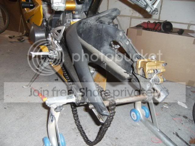

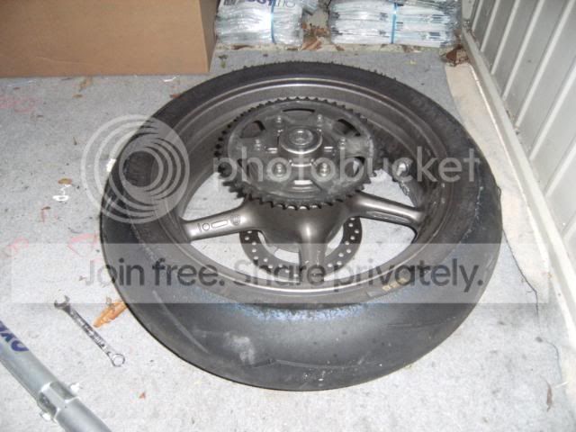

Once you have the wheel out, slide the axle back through to support the chain and caliper while you change the sprocket.
https://i6.photobucket.com/albums/y209/angelgrinder187/DSCF1918.jpg
Now, you need to remove the 6 8mm bolts from the sprocket.
https://i6.photobucket.com/albums/y209/angelgrinder187/DSCF1919.jpg

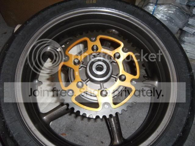

And just pull the sprocket off. I took this opportunity to clean behind the sprocket on the wheel, and I also cleaned the chain runners and all around the front sprocket with de-greaser.
Put new sprocket on, and put the bolts back on. I used thread-locker on these for extra security.

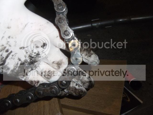

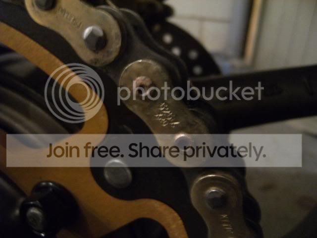

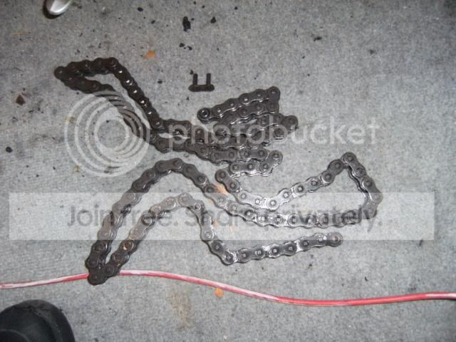

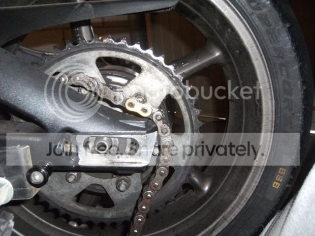

Now, to get the old chain off. Get out your angle-grinder and eye protection (I used an old helmet). Find the master link (it is gold and the pins will look hollow rather than a big metal rivit as the normal ones do).
Grind off the 2 hollow rivets.
https://i6.photobucket.com/albums/y209/angelgrinder187/DSCF1927.jpg
Now, get your screwdriver in between the rivets, and hammer it. Hard! Eventually it will come apart... Now, just pull it out of the bike.

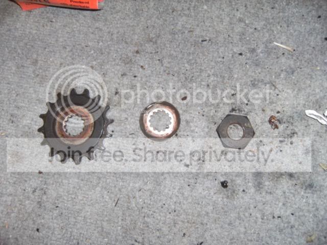

Now, take off the front sprocket, the washer sits behind the nut, but infront of the sprocket. Here is the order they sit in on the bike -

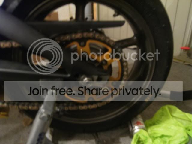

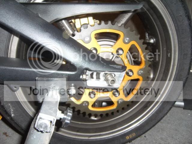

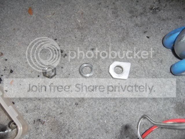

Now, put the rear wheel back in, using the reverse of fitting. Here is the new sprocket on, and a picture of the order the spacer, washer and axle nut go on. Don't do the nut up tight yet - you will need to adjust the chain when fitted.

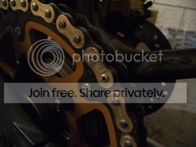

You now need to push the new master link from the bag your chain came in, from the back of the chain, so the rivets face the outside of the chain. Make sure you put the rubber x-rings or o-rings on as per the instructions with the chain.

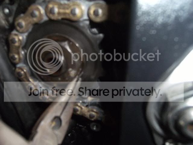

Now, push the new gold link over the top of the link, and use the mole grips to clamp it on.
https://i6.photobucket.com/albums/y209/angelgrinder187/DSCF1950.jpg
Take your time with this. Just get gradually tighter and tighter, until the 2 rivets begin to show through. Keep going until you have 1 or 2 mm showing through.
Then, using something metal on the back of the chain to hit it against (I used a second hammer) hit the front rivet until it squashes. In this picture, the top rivet has been hit, the bottom is how it should look after being clamped on.
https://i6.photobucket.com/albums/y209/angelgrinder187/DSCF1952.jpg
Hammer both until they are flat, and you are happy there is no way it is going to come off.

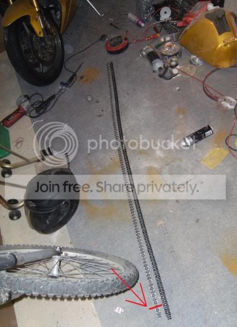

I took a picture of both chains lined up so you can see how much they stretch. The dark one is obviously the old one. The new one has an extra link on it when I took the picture, so have marked with a red line at 116 links, which is the same as the old one!
Laughing You counted each one? Laughing
Anyway, awesome write up, hopefully it will teach some youngsters a bit of DIY and save a few quid.

Bishbash wrote:
I'm a measure twice, cut once kind of guy....plus I was bored Laughing
