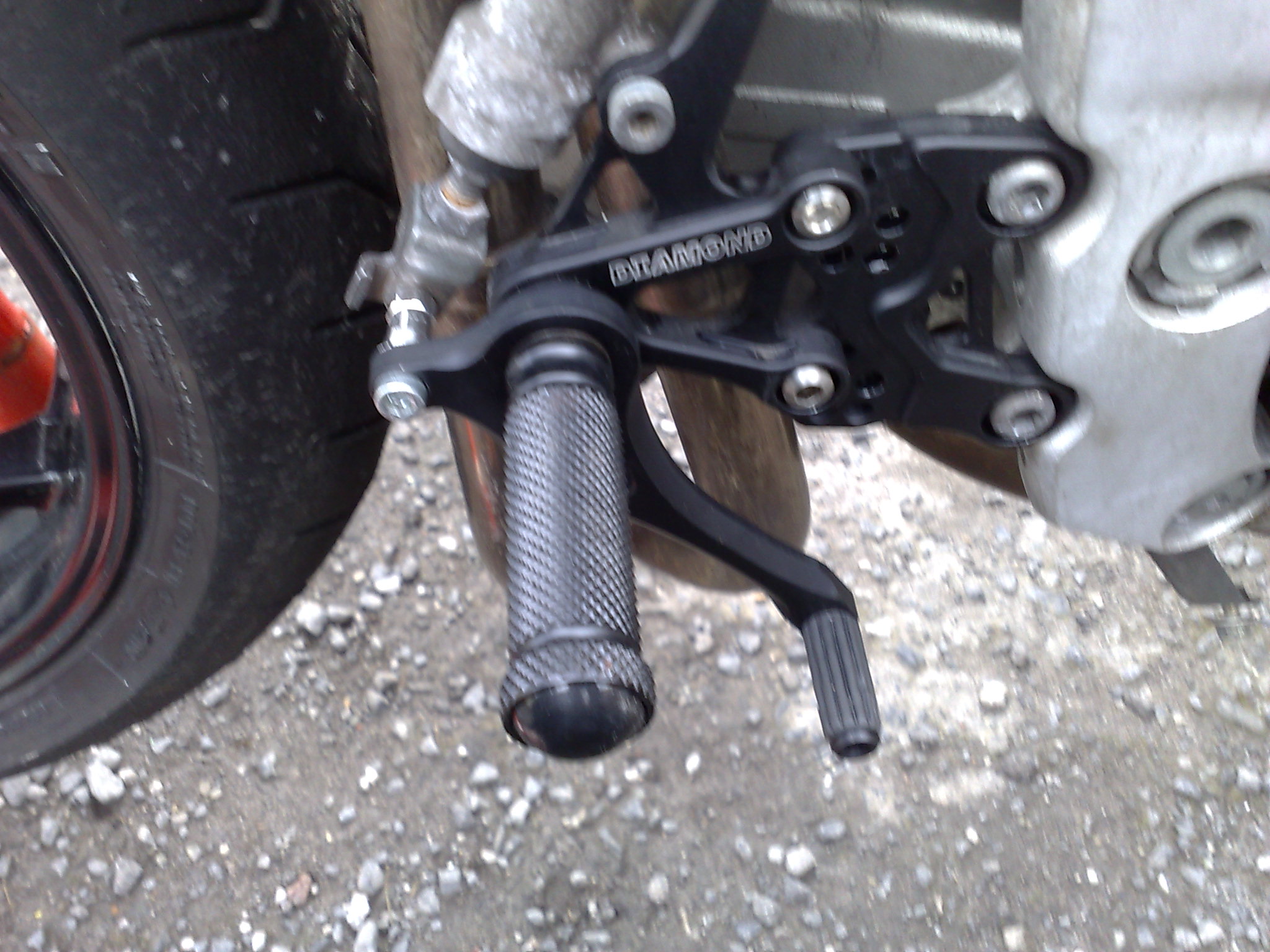

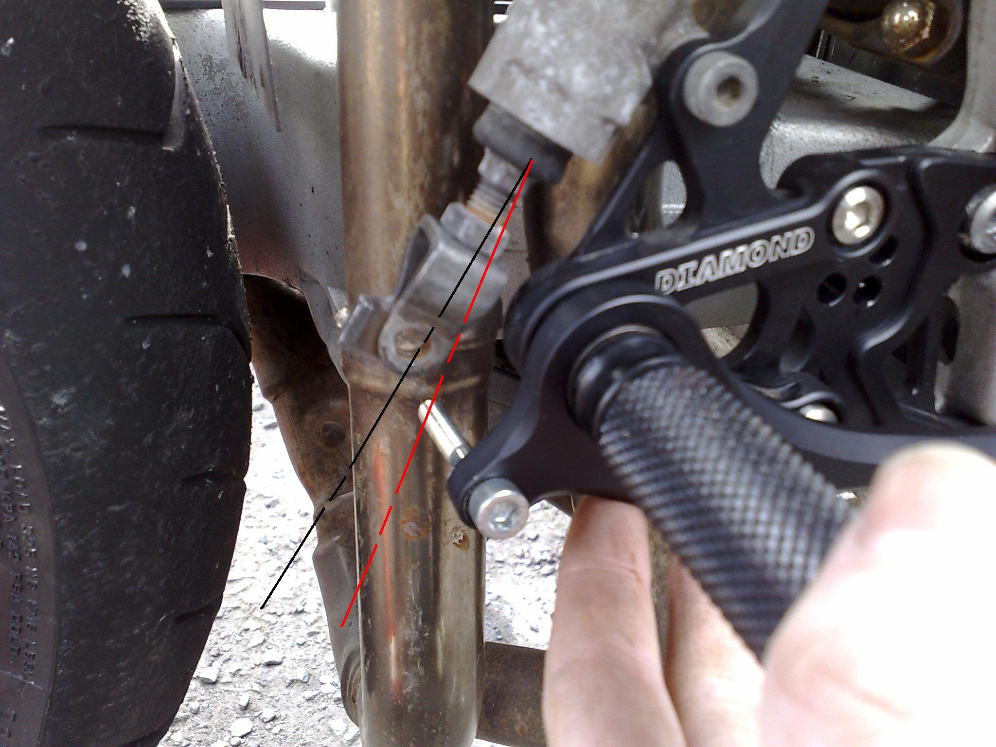

Erm, well I went to fit my rearsets to my bike a few weeks ago, and the brake pedal doesn't line up with the master cylinder AT ALL!
I also can't seem to find the Diamond Race Products website, even with the aid of google!
Heres some piccies:-
https://www.bikechatforums.com/files/23032008147.jpg
https://www.bikechatforums.com/files/23032008146.jpg
Any help would be greatly appreciated as I'm rushing around trying to get my bike ready for a trackday next saturday!
Cheers, Daz.

Use the nuts to adjust the length of the bit sticking down from the brake unit.
Deano
Joined: 17 Feb 2003
PostPosted: 16:56 - 23 Mar 2008    Post subject: Reply with quote
what he said^^^^
the bit the screw attaches to you should be able to unscrew it and therefore making it sit lower and getting the pedal sit higher.

the sticky downy bit is at full unscrewdedness Sad I might just have a bit more threaded bar welded onto the master cylinder.
Even still, the master cylinder isnt at the correct angle for the pedal when the pedal is in the right position, shown in the quick doodle below:-

Cant you flip the pedal over? (So the part with the screw points up, not down)
daz_d_biker
Joined: 01 Aug 2007
PostPosted: 19:03 - 23 Mar 2008    Post subject: Reply with quote
Wouldn't have thought so, as the pedal is all shaped and curved so it fits right that way. It may be possible they aren't actually for an rvf or vfr Sad they do fit on though!
Looks like it'd all line up if the actual pedal was flipped like you said, The sticky-out pedal bit should screw in from the other side, And the steel 'prong' on the bottom of the master cylinder should go over either side of the pedal.
Edit: Oh and it looks like the master cylinder needs to bolt on from this side so the said 'prong' lines up properly. (Bolts on the other side coming through this direction)

cant you have a fiddle with this bit?
https://aycu21.webshots.com/image/47820/2001724145665636420_rs.jpg

mattsprattuk wrote:
Erm, it doesn't look like it from the picture, it appears the master cylinder is mounted to the very same bracket.
Current Bikes - Kawasaki ZX-6R (636) | BMW G650GS
SM.Morgan
Joined: 04 Apr 2007
PostPosted: 12:04 - 25 Mar 2008    Post subject: Reply with quote
I'd of thought about swapping the part that mounts onto the frame over with the other side, this should raise the peg/lever up higher. (think)
But will not change the master cylinders position in relation to the lever.
Are they definitely the right rearsets for the bike?
SM.Morgan
Joined: 04 Apr 2007
PostPosted: 12:15 - 25 Mar 2008    Post subject: Reply with quote
EDIT: looking at the first picture can you not just mover the top screw on the adjustable bit forward one place? that might line up the bolt as it'll make it higher?

the adjustable brackets that mount to the frame are on the wrong sides Wink

J.K.R wrote:
Still irrelevant...
actually it isnt as the holes then sit at a different angle,they may or may not line up better,but you should fit something the way it has been designed.....so my post was relevant and informative...and yours was an un needed post.

Stiffler wrote:
the master cylinder is on with 1 bolt, meaning the lever can pivot.
if the rearset is lowered, because of the pivot, the operating lever raises.
It is. No matter what you do with the mounting brackets it will not change the position of the master cylinder in relation to the lever. They are both attached to the same solid unadjustable plate.

sorry to bring up this old thread, but i recently installed the same rearsets and I just thought i might contribute...
this is how i hooked up my master cylinder:
https://farm4.static.flickr.com/3270/3060541731_caea149670_o.jpg
the operating lever is at a really odd angle though, and i sometimes have difficulty reaching it.

daz_d_biker wrote:
rc211v wrote:
the differance if these are the same rear sets on the same bikes is the op has bolted the master to the back of the mounting bracket whereas the second pics shows it bolted to the front with the bolts going in from the back.

PostPosted: 07:29 - 27 Nov 2008    Post subject: Reply with quote
yep, i had to bolt the master on the outside, that's the only way i could get it to align with the lever. its just a temporary workaround, but i'll see if i can mount it any better.

Are you positive you can't adjust the length of the rod coming out the bottom of the master cylinder? It looks to me as though there's a locking nut and an adjuster nut.
