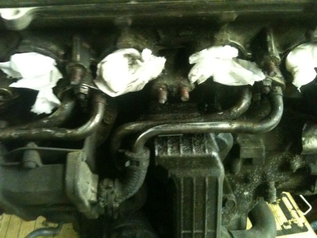

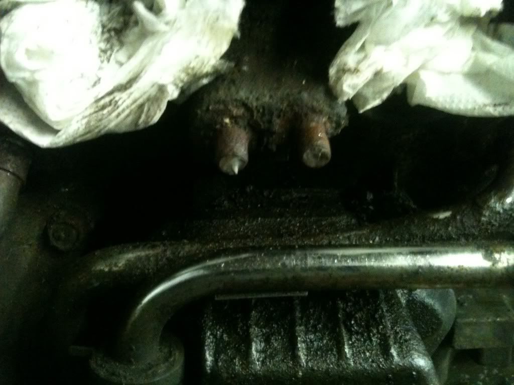

Any help on getting them out. Got the plates off, just left with 4/6 studs in the engine.
They were properly rusted in.
Any tips on getting them out? Drill and Easy-outs? Or is it a case of taking it to Re-Bore to get them sorted?

If they are so rusted in they snapped off then an EZ out is the LAST thing you want to use - they will snap and you will cry.
Get some penetrating oil (not WD40) on the studs, then some heat and have at them with the mole grips... drilling them out is possible if you have a steady hand and some decent cobalt drill bits but if it were me and my attempts of brute force had failed I'd be taking it somewhere to get it sorted.
Good luck Thumbs Up .
kt
Joined: 21 Jun 2010
PostPosted: 20:18 - 29 Jun 2010    Post subject: Reply with quote
Op they look a mess, if you are really stuck and have enough space a last option would be to weld a piece of flat bar onto the studs than wont budge to act as a lever to remove them, Ive done this in the past and it has worked but only as a last resort. Good Luck

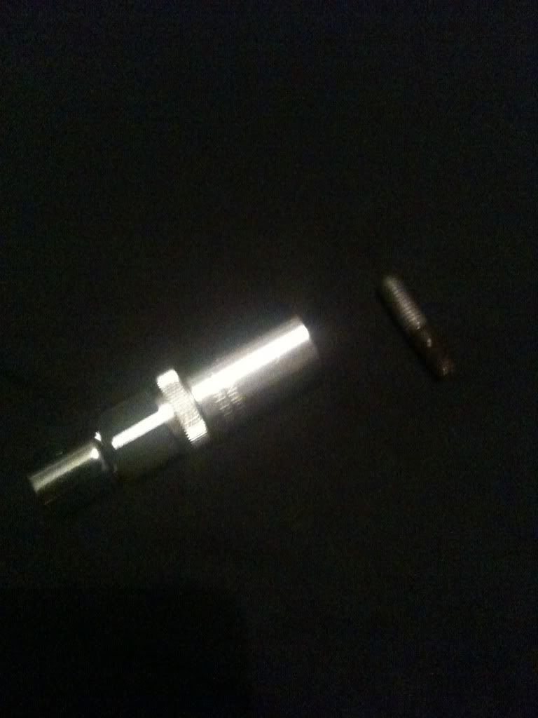

Woop Woop, Stud extractors to the rescue!
All out, used the 8mm stud extractor and it rounded it off, then tried the 6mm and because i rounded it it fitted on just! Then undone it, very slowly making sure not to fuck it up.
