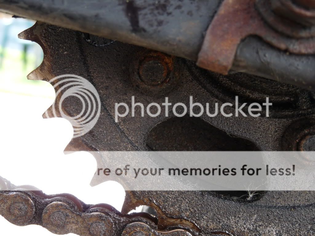

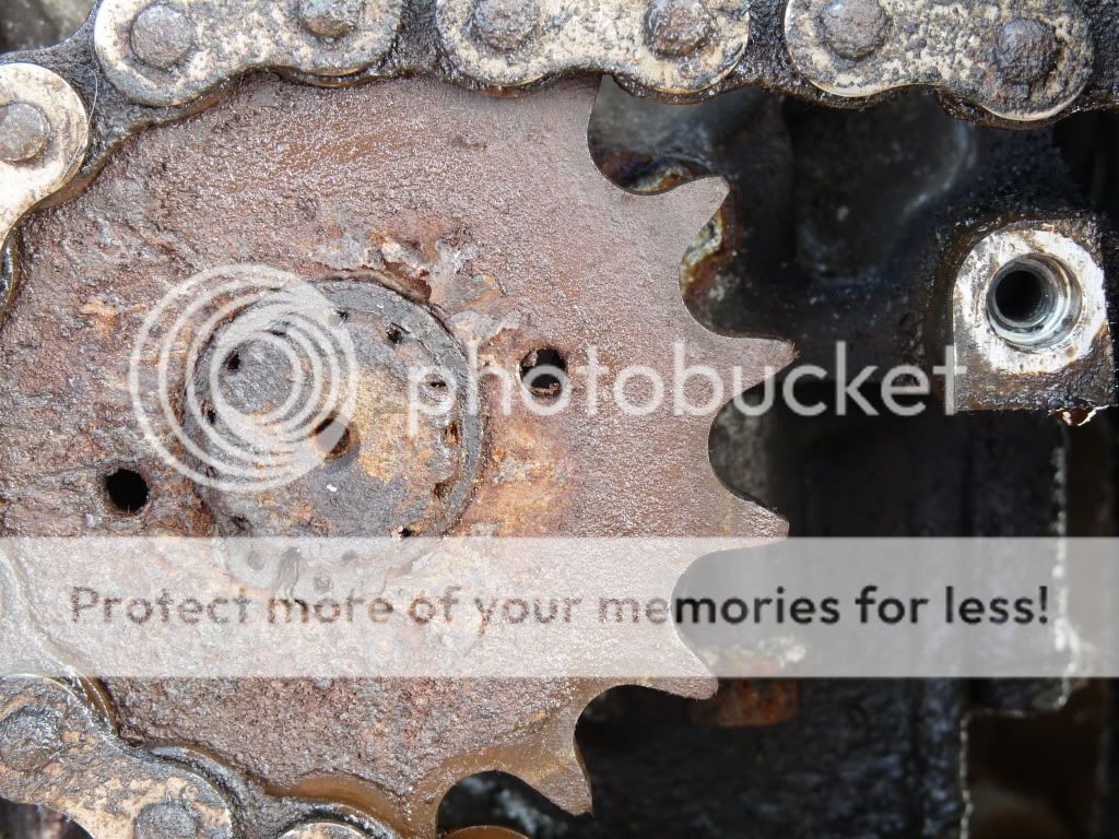

I have uploaded a photo of my front and back sprockets. Do you think they need replacing?
https://i226.photobucket.com/albums/dd39/dx90_photos/P1050627.jpg
https://i226.photobucket.com/albums/dd39/dx90_photos/P1050618.jpg
The bike was left standing over the winter by the previous owner and I have notice that several of the rollers in the chain are seized. So it looks like a new chain. Just wondered if the sprockets were Ok.
Thanks

The pics aren't coming through. Try uploading them again.
PostPosted: 12:01 - 16 Jun 2010    Post subject: Reply with quote
They look alright, but if you where getting a new chain I would get new sprockets anyway.

There is a bit of wear, nothing to worry about if you weren't replacing the chain but as they arent that expensive it is worth replacing them anyway.

Bloody hell, there's years of life left in those sprockets Laughing

Oh the sprockets looks fine to me.
