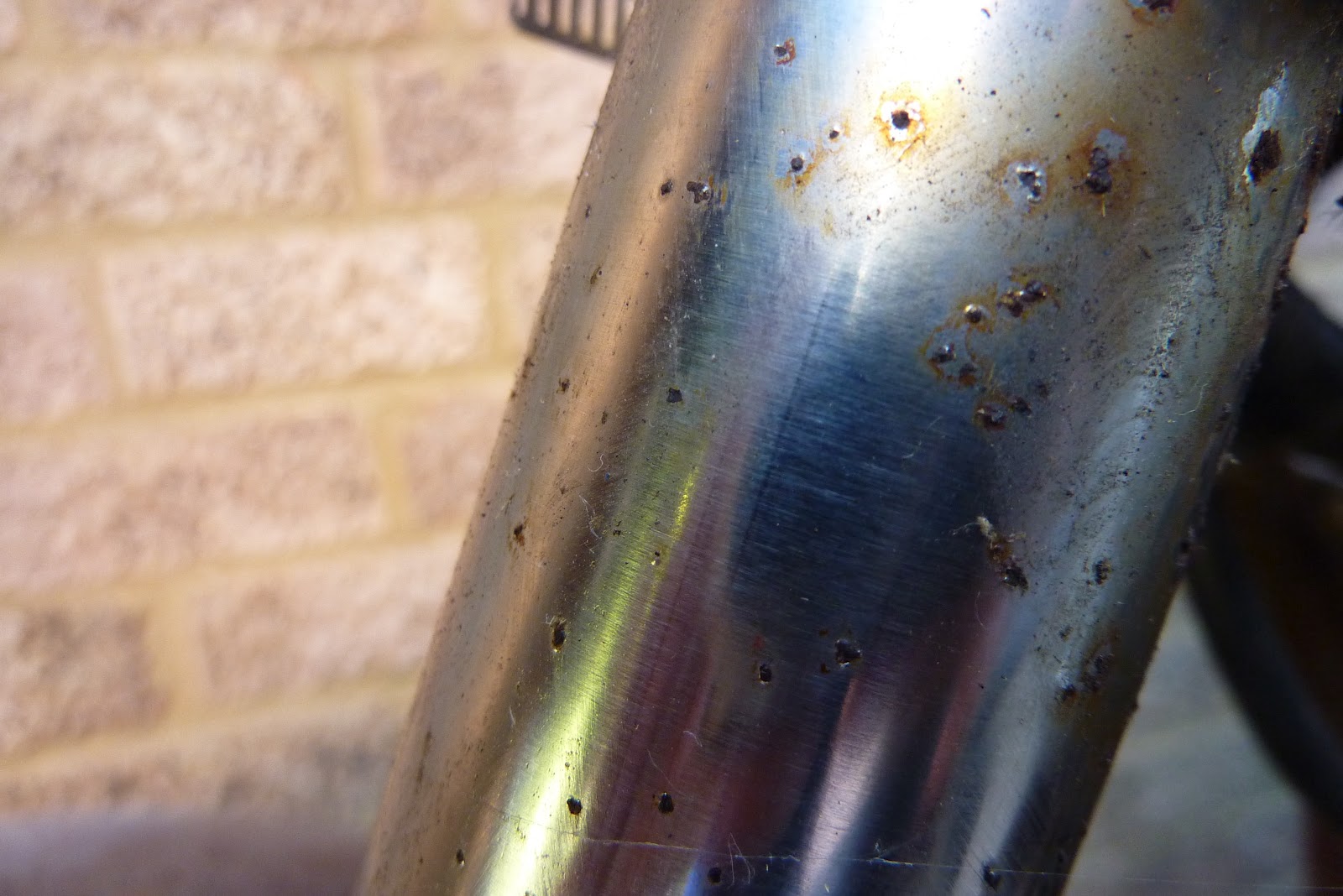

What would stop me buying this?
Nothing protecting the fork legs & being chinese the coating simply isn't going to be as strong as a premium bike that'd still stuffer the same issues if the legs were that exposed.
Few stones in winter ought to see em looking like this;
https://1.bp.blogspot.com/-AB8dnb7C7fk/UFJN_FLV-YI/AAAAAAAABA4/Iw12Sqa_dG8/s1600/P1040335.JPG
Lack of protectors was a known issue on the Dukes USD front end when converting to an EXC headlight.
Put RWU forks on it with gaiters & you're onto a winner. The brackets on the bottom of the USD's also look really fugly and don't fit with that mudguard at all.

These are coated well to be honest. That looks like the sort of rusting on older chinese bikes that were around 5 years ago. Some importers still sell them as the quality is cheap, and there-fore the price is cheap. We dont

I'd be inclined to agree, however it still doesn't change the fact that if stone chips will destroy a pair of WP forks on a KTM that those forks stand absolutely no chance on UK roads Laughing
Look at any other bike with USD forks, the legs are all protected to stop that from happening...usually by the mudguard.
