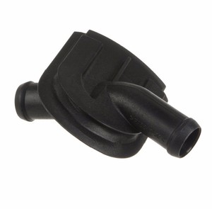

EDIT: One more place to check. My w202 and w210 and I do believe the CLK would be the same, when you look at the firewall in the engine comparment, on the left hand side (where the continentals would have the wheel and master cylinder; I do believe it's the head intake side), there is a plastic bit in the firewall that connects 2 hoses. That is the return of the engine coolant from the heating element in the cabin. Some cars develop cracks in that plastic part, which result in the coolant leak. So check for wetness there as well.
This bit, the leak is mostly very slow. The answer to the constant losing coolant mystery. (not expensive, easy to change):
https://i.ebayimg.com/images/g/3RMAAOSwxp9W7RFz/s-l300.jpg
https://www.benzworld.org/forums/attachments/w202-c-class/190263d1218523369-please-help-me-identify-coolant-leaking-img_0043.jpg
