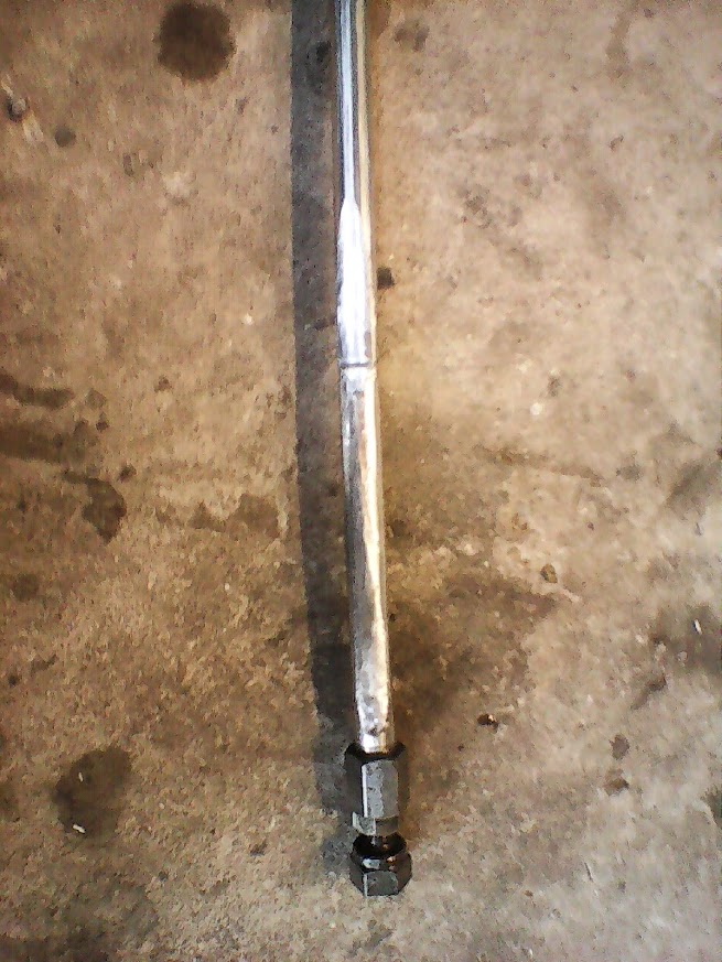

Umm, it turns out the slight clattering noise under power was NOT pinking!
I went to check the tappets and found this (inlet pushrod).
https://lh3.googleusercontent.com/Lnb7NOhmmHeIVNK-6kf24N-sgAjAHBkAxsgzkyhWuix9KivxuHmeFZA_W7Sr1F0zegfalsEbSyeZ2zz8A5si36Luu8VkOyIfp-79GT6iGnGjQkMBarocKg2TaAJyZ8BRv9OQHdShBw=w655-h873-no
https://lh3.googleusercontent.com/tGa--8HvcXusLeaQ5oxfk6c1yI4dzcVv2CPhTrA-3LnFKfK6UVpaFWKtUh4-U0rhciL5jCZn2ysBgU3_0J__s_2jDj0xzXskI1117uimouMo6vHWD7z6t--KgdpuPMd9ALt3gQrmUQ=w655-h873-no
https://lh3.googleusercontent.com/qeFc79rApKnERXFiULLBHVPBdtSYuBv97_Xufkvp3nfBCCYFGgPLXMcwfj0fDWzEXYwE6Ies5PHjQSs272TKkOwYzqGotDegKIC4sojs-bQ0KhtEGlahrXfd_6JXac0NbzFKG5iqAg=w655-h873-no
Minutes away from disaster. I'd be able to snap the end off with my fingers!
Luckily, the filter seems to have caught all the bits of alloy it shaved off the edge. I've checked the rocker blocks and there is no residue in there, the oilway gauzes are clear and the oil has only a slight metallic sheen (I was kind of expecting that anyway following the first oil change).
Next question is how did it happen so I don't do it again!

After a large degree of head scratching and further trespassing on the good nature of people on the enfield forum (who were already upset by the idea of me doing 90mph on it before it had covered 50 miles, and said that's why it happened but couldn't come up with an actual mecchanical reason why thrashing it would bend a rod) I think I have it puzzled out.
Basically, the rod jumped the follower when I overrevved it having fluffed the gearchange. Normally, this would just see the bike stop but the edge of the (concave) adjuster seems to have landed square on top of the rising (convex) follower. That's a pretty unlikely happening but explains how I can have a crack in the metal rod on the INSIDE of the bend.
https://lh3.googleusercontent.com/tfRNIN0NhALJ4PRTgMGA-F-fD5knyTyuEB7GNDcHe_t086OF0c5ZQl5G9WytJbHjpTiuStELHQlrV-WoCt0HLFGD1m8NYB1LLretMHJ0YipBPACNo0uLnF7tDOZbZvjfksKVh-z6Rg=w524-h698-no
Good. I can sleep now.
I will order a different adjuster in the morning which incorporates a metal collar that slides down over the adjuster to prevent them jumping off the follower. More reciprocating mass, buy hey-ho.
