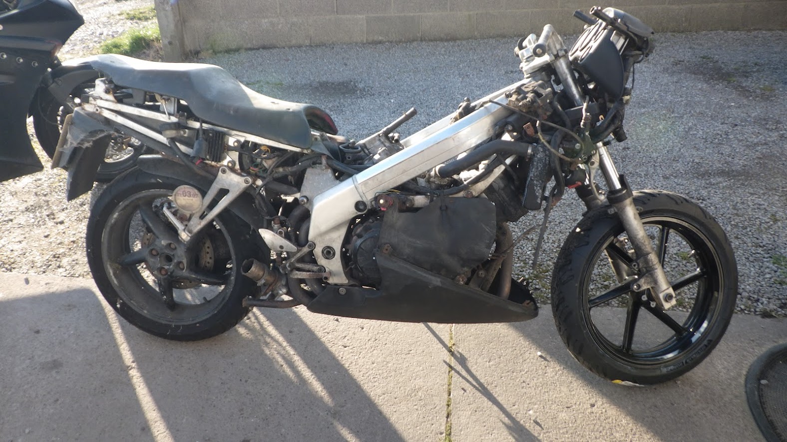

Weekend off so plenty to do.
Cleaned up the road dirt off the headstock.

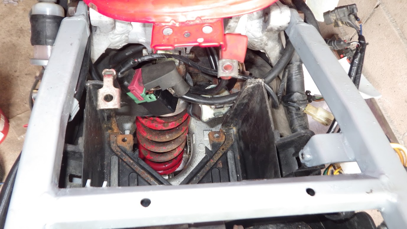

Finally got the tank fully fitted. I'd lost the two rubber grommets and steel tube that go inside the tunnel on the tank. Typically, a non-standard size of top-hat grommet. I landed up paring down a larger pair. This took way longer than it should have done. The tank is entirely rubber mounted.
https://lh3.googleusercontent.com/pw/AM-JKLW286B2xSY_Qf_6TlDxKF-pTtj2eZmMd5g7TEFegqD1IOKzfoNA8htFuBT6yk454cczuoBvu8nlP7cNEEJEkwYJMmRAhnTpD4BJM5lHQbPPgESRBuFJj6vzufkblhwy6-c1A16E3UZ2oxTePO-_r7rg=w1378-h776-no

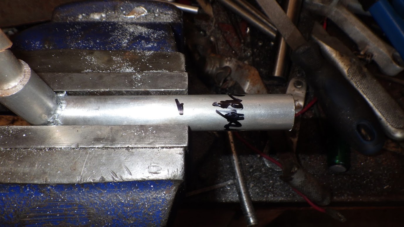

I've got some steel tube the same diameter as the subframe. I reckon the best way will be to make a couple of bends for the bottom fixing and slug them into the subframe.
Similar for the top fixing but I'll use a munsen ring (a pipe clamp which has a threaded hole attached for fitting water pipes to skirting boards or above hanging ceilings). Might get away with a bit of aluminium flat bar for the top fitting.

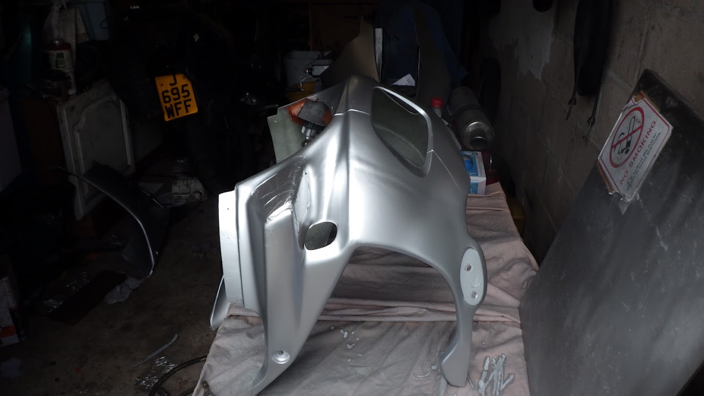

Some bigger jobs out of the way today on my day off to let me do some smaller assembly jobs in the evenings.
Stripping paint yesterday. New paint stripper sucks, I tried nitromorse and it took the plastikote bbq paint off the fork legs with the assistance of wire wool. Didn't even soften the stuff on ther calliper or front sprocket cover. However I have a secret stash of starchem.
Doing the calliper silver. It was black on this model, silver or gold on others. Silver because I have a can of silver VHT paint.

Two bits of alloy tube.
https://lh3.googleusercontent.com/pw/AM-JKLXknA-s4KhWnST2kGGH0HdsfFwDr2p6back9yVadLjslyNVsAxYuAjpkS-mC1gAP-PWRdJE6mfvLP_F_EwSZBptM2v7MUAnAL07FZYgZeZFXfJQkqKbS1ZGBO7IskiY6a6JJ6GmrxTYMI9j8i37FaIE=w1378-h776-no
Joined them together with aluminium solder. If you try to get it too neat, you land up melting it all off again. Neatness will come with practice I think. Using a reducing flame with the MAPP made this a lot easier than last time I tried to use the stuff. You have to have a conventional blowlap roaring hot on a high oxidising flame to get enough heat into the metal.
https://lh3.googleusercontent.com/pw/AM-JKLUNGWXonRjSnQkYlvtvTAO4Bxp7bkBiOcDIj_-_EhUoFLw1Z-_S102xYEvgadSr6dw5b0DY5UM53UVG4vd4Jp95Bqv1XrmfLUIKSFD3ylievy9ud9294m4bV8um43a6lp9WRUdR5NqVcdCiOr-lVBvG=w1378-h776-no
Also needs a bend in it. The trick here is to heat the aluminium to just above the temperature where sharpie burns off. It then becomes quite plastic and bends like rubber.

One more job at the tail end then I can put the plastics back on. I want some switched, fused power outlets for the front end. One for heated grips, one for a USB socket and a spare. I'll also hook the voltmeter into these.
4-core multicore cable to run alongside the loom up to the front. three power and an earth return, the current rating is way more than I'll be using even with all three feeds sharing an earth but I might loop each device to a frame earth at the front anyway for redundancy.
https://lh3.googleusercontent.com/pw/AM-JKLVj4_V0w_H-uD0nAzUZpy7u89-xIR0qlxRgw2NpQn4xxpxhkQRI6H8Atb3Flnny7NjREj07uBWZ3K7M23nNwuiWqc2lU9PnzaGnS0ZFQQVQpusueQxaURnmKSV9N16Ct9jhTowBwYHx3o2omBvXYUwS=w1378-h776-no
You can buy little plastic fuse and relay holders quite cheaply that hold 3 fuses and a relay so the three bits of multicore clicked into the fuse outputs and an orange cable for the switched live feed looped along the inputs.
https://lh3.googleusercontent.com/pw/AM-JKLUAe31rh8Vu83px18I1X2PIHjW3szdV0yRetwCzO62xo-8xEm5rKYvFEOxxWhcoKOvULsLgVxtbAqAxh-htywRPPRs2DpzQIG1SuogykKMN39gXP4jULjAkQV2qrXjARKppD2VfUPiLRnnOoEzfPI0P=w1378-h776-no
Switched live to terminal 87 of a 4-pin SPNO relay. A red live feed from the battery to terminal 30. The multicore earth and a green earth wire to the battery earth in terminal 86. A black flying wire for the switching input to terminal 85 to be connected to the new rear brake switch when it arrives.
https://lh3.googleusercontent.com/pw/AM-JKLXH7biO3KfTRgiGcB1TgcbiKO3pdZv5W_i4tb_G3Q1p4exsdPXKhr1979RVXTRgeD4MS_2UBblbiZsVp_ZN2Zc_mf1uwZlpCGFJlZB3YTfK61LytfZNrfWBvU7aPGLpEdhrAhSYEVSQLbHu5PcXQbIy=w1378-h776-no
This seems a neat and out of the way place to put it and mounts with a simple L-bracket.

I've put it off for long enough, these plastics need painting. As I said, I'm using epifanes yacht enamel which is tough as old boots and designed to go onto gelcoated GRP.
In an unusual fit of organisation, I decided to read the instructions for prep and thinning and watched some youtube videos on setting up my HPLV spray gun. They give you detailed instructions on the pressure, nozzle size and viscosity to use for best results. The jam jar with a hole in is my ersatz viscosity cup. 100ml should run through a 4mm hole in 20-22 seconds when it's properly thinned. I also ran it through a filter after mixing.
https://lh3.googleusercontent.com/pw/AM-JKLXl40OM2UIwyDHN9upruHJAaDmsn9btuAAf8HIjv7SZ9iVAyXBKGj-gO5YCn34UoQYubMMx3ORnF9DP3sLIaAXgVWwjb85QgjiRqAcDH0hUZ2uO74G8U3NEZ2wEgvJLSnew2dMgAm16Rpciszf3blCv=w1378-h776-no
Correct viscosity seemed to be the magic bullet for getting a decent finish. just the first coat and I've put it on a bit too thick in places but it's to rub down and recoat 1 or 2 times more anyway. It's a matt finish so no need for laquer.
https://lh3.googleusercontent.com/pw/AM-JKLXf8xWJmPNDI3rOA8RHLJ681dp_lJlTX3vCRLIH8ooS3EAd9ERE9a8ABuCZU8YEK06gsW2ge4ZCHvhSlybL3aiP5HbSpk_ATguhhtI0paIlOeVXOHALHy9w7v-S6uxVd9SZbQ4oRWz5G3Y15c3-Rdbr=w1378-h776-no
https://lh3.googleusercontent.com/pw/AM-JKLVOV6y_xzpT1s3e_M3ptdUDGLoN7NQh4npRZmWmkgZKd_e55OZsSDTcgg6NKmcDnyXTBr7JP117TS6NMdZOTD5lUmYIwusB2mEtXHU-RPzLaDMg_F0quvebVmPdqmIKk4TrnNxWneD54TbIghvsbMf6=w1378-h776-no
https://lh3.googleusercontent.com/pw/AM-JKLU_o5WzTGsZBsTY2jJvjNEbmdvYcOxbfRIPwwsHgzjuayXQR1oCDuh4Ndzrw7rvU4SMdu_T28gCiHlxwG-nOryemsU9MNyayADqkPIgukQxkhzMFgw4a8h3CroIkp7E2Z6_MdxX6jbD4-JDsRFIfGlK=w1378-h776-no

https://lh3.googleusercontent.com/pw/AM-JKLUUjasUlv8_9DWUsBNG_hLQygx82GN2qO1eeJbLEH0pGa4PDINmk8jRiwRBDvEnn9Kc9G-w4bI2DPM1dP5BPGUK0wdRtY5ueaiJPcUlAbMdpjcluBpec4Ed4RJLpgA6Ij3-nAdsx0ifxWGcrhJ1pLgf=w1378-h776-no
They need to sit for at least 24h now before they can be sanded.

Photos as promised, although I should probably have taken it somewhere more scenic to take them...
Just a reminder that this is what we started with:
https://lh3.googleusercontent.com/pw/AL9nZEVRwodZIaruDV7cz4xKHRzGvZbsoAr5fQTa73gu048pJWyznabDRXfnWGdbuWdd9aoV-du6E6DJdYgp49l81iJUdDJDsiRMf9Ld6G9b-tEEltqOety5I7OuF3LXSbYw6iBnqmsXfeUvBajD0GME9w48=w1576-h886-no
https://lh3.googleusercontent.com/pw/AL9nZEW5Eogsza2EW-VFslLelqOR70rC2onlsDckj-RUXvzdoaHYRP477E3TIizi8JjFdXf8nfxapVyH6CQb6SiFSgksWpINxHigQDKswpyaJsMgLjqmzep6iKIJh2Xqk1OHAetwQWgW5Rto3xxIAl1HTae_=w1576-h886-no
So while tatty, this represents significant progress. it also goes properly so cosmetics are fairly low on my priority list in this respect. I think the silver looks ok, probably better than the wrong shade of red. Already started a new fly collection.
