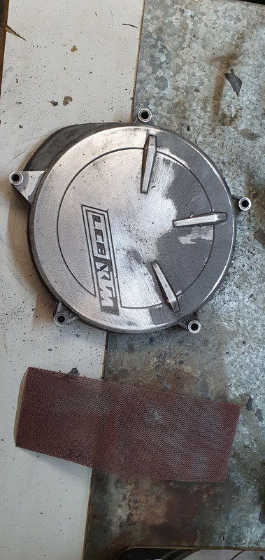

The clutch cover on the RC8 was looking a bit tatty because the paint had started peeling off.
Sanded it back.
https://i.postimg.cc/rFn1vcBx/20230319-144831.jpg

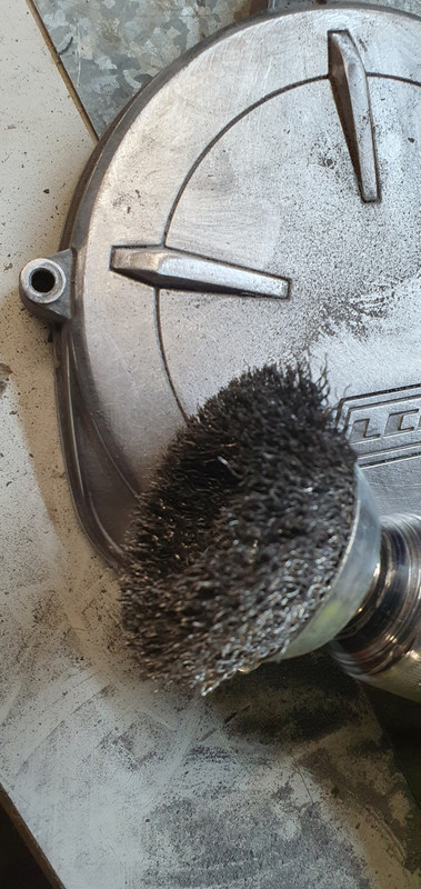

Needs more elbow grease, can't be arsed so get the drill out.
https://i.postimg.cc/5yqSTCwm/20230319-150418.jpg

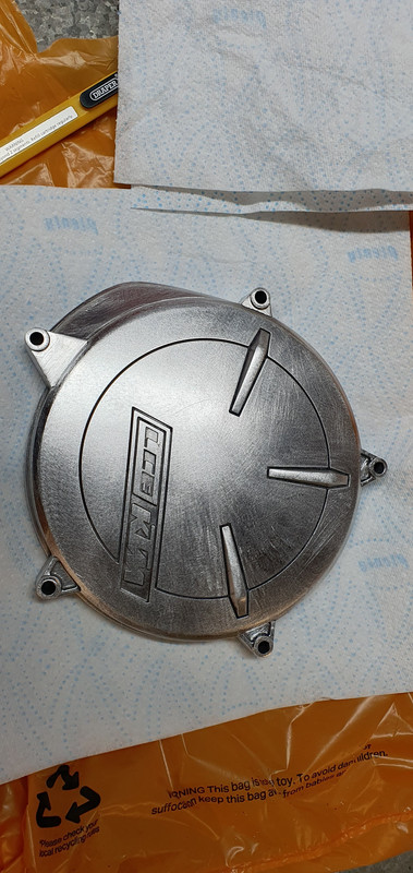

After hand finishing it was a shame to cover with paint but it wouldn't last if left uncovered.
https://i.postimg.cc/W4yVqDqS/20230319-162907.jpg

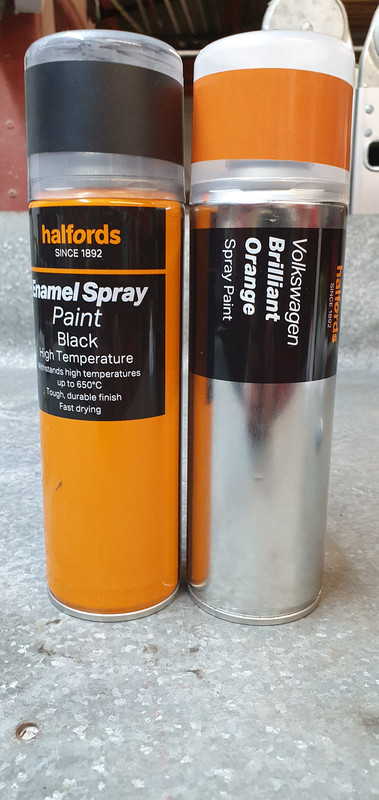

Got the paints nice and warm in a bucket of hot water.
https://i.postimg.cc/PrH4YTZk/20230319-175109.jpg

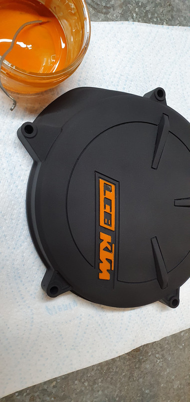

After a few coats and 350c with the heat gun the black was done and ready for the orange highlights...
https://i.postimg.cc/XqftLLQN/20230319-172259.jpg
Might be passable from afar.
https://i.postimg.cc/jdQLnr6m/20230319-173635.jpg
https://i.postimg.cc/DzCC2DYb/20230319-180647.jpg
