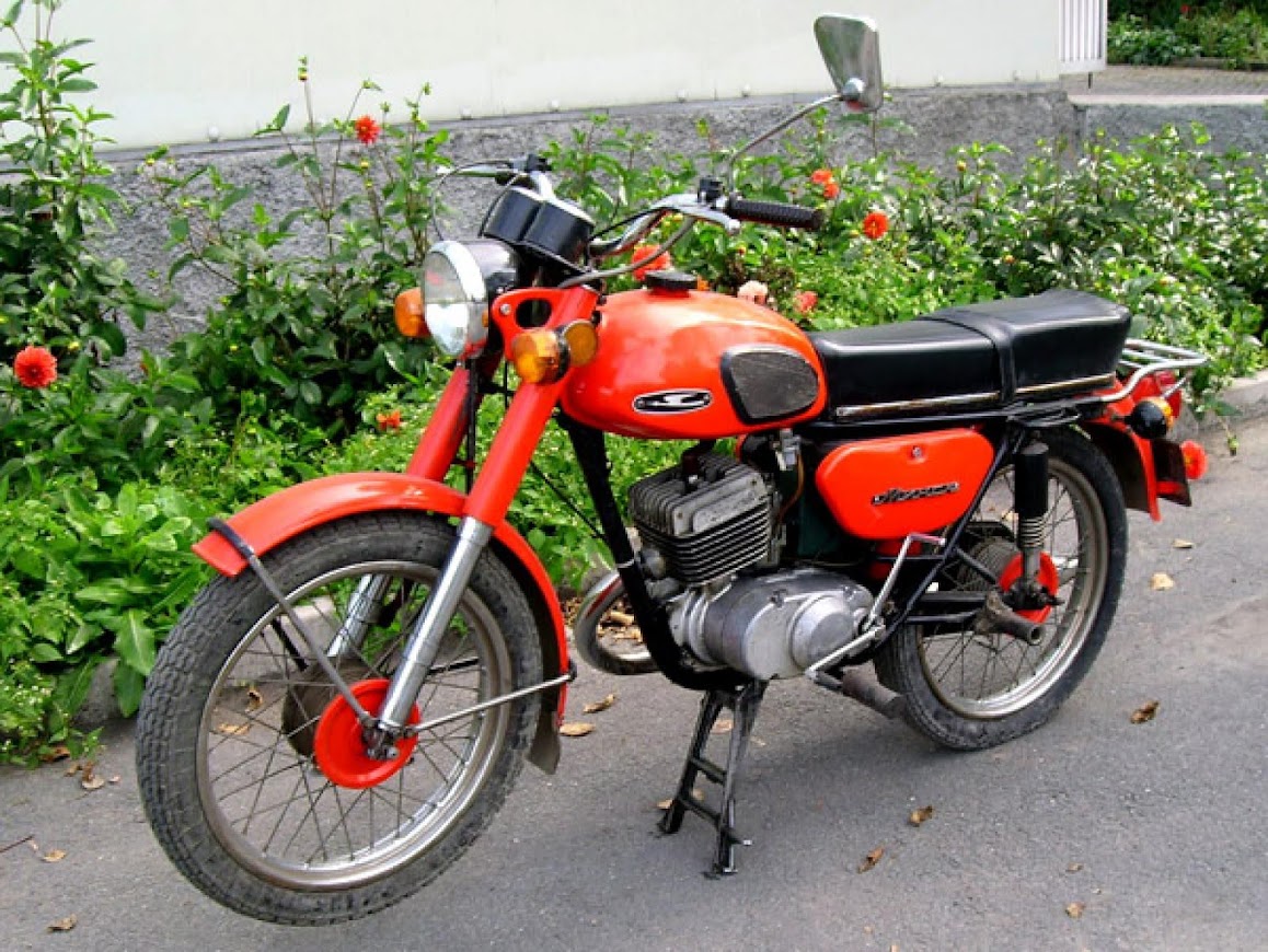

I had one of these as my first bike. Cost me £500 brand new from Lossiemouth motorcycles in 1994. I rode it for 3 years and passed my test on it then two of my mates had it and passed their tests too. It finally died when a lorry driver missed his junction and reversed over it.
Mine was a dark blue on badged as a Motobeno but they also sold them as Regents cossack and I think Nevals. Looked something like this:

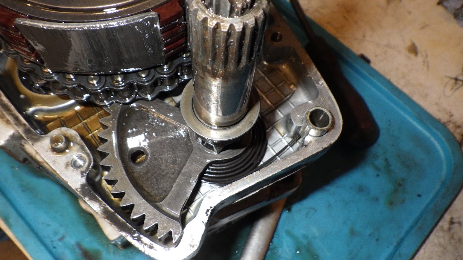

Note to self, kickstart spring goes under the dowel.
https://lh3.googleusercontent.com/pw/ADCreHdA06qjxAnQP-xwuy1rwS8erGXb7I6EAY0P-zYyeK6qHNoceZPLky_1QBS3qVMHsS0Bm1TKPJ1EaPLx0rFlONGlHCW-v_sippZdCoGMhVsT00PWa4PXx74uI_V_YXfxso7cGUXHt_bZryp6xtjl0RO7=w1547-h870-s-no

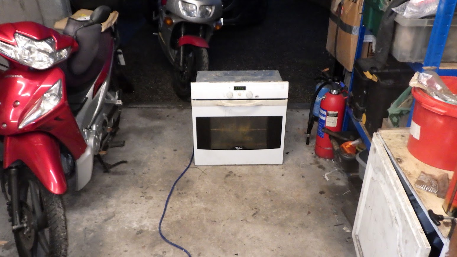

Dragged the garage oven out. This vastly increases the level of marital harmony. i got it free off a neighbour who was throwing it in a skip and I just plug it into the cooker socket in the kitchen. Ideal for bearing fitting/removal and curing paint.
https://lh3.googleusercontent.com/pw/ADCreHf2rdjoENim_qxTZ8CS3cilpArT4yh9zI_EmkPcbtYJFruNTDR2Gbm_ZF2Nu074npSGsO3ef8fzm4GpbVVP6WKN6ZnD95UHbjP4yqEQP2Mx3c234PIV9wPdjN_Dh2E4cpClIGT_D9ElgbWW5X6PCA43=w1547-h870-s-no

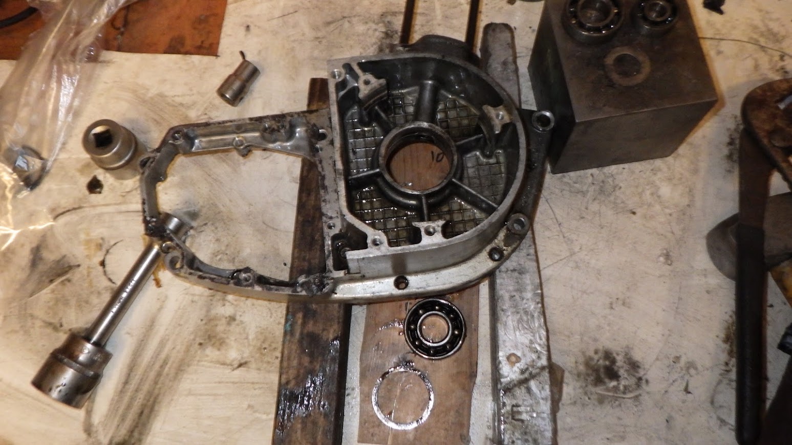

This made short work of extracting the bearings.
https://lh3.googleusercontent.com/pw/ADCreHcMb0Pa8e0MzKwVuycQ7muSkJ5wab5BwumEiaUR3cVcM3aFW71gEAkgl8h8z9nqqq9jR5exQP2tu2_eGxvEFOj13G1YFFUL-xMWnuZpeVsk-tiDQOR8JR3a0H80mzYXIe3O9Sz8aU_Qb0Srpp0on7ZH=w1547-h870-s-no
https://lh3.googleusercontent.com/pw/ADCreHfZBSKnTqab2atlcUtAx4ERkmj3bWoLwrK1ZyO-JEEisF8rRNXv-KM3aWS5jVvNKdPwYbe7gl4-89fWFKUnK4RnlKSTZM7bQiyKtVIHvc8AKHVTyScbxtUnIfPs_sS7GgVrYE_n3XTjQnoaj_jvXIjF=w1547-h870-s-no
https://lh3.googleusercontent.com/pw/ADCreHcd9MZHCEFqZ54gq4o71x7Bz3MsO2lQxkJSDq-zDDTaNLWwIhAvsWK28ax4LpC2mBJ6FcqRJMJYZtwrGfqJXo95tyc9LkiFyS_ipWRt5NY03NfONdkleqC9T96OpAvyP2YIKxN0VooY_RW5p3nAiMt0=w1547-h870-s-no
Now they've cooled down, I'll make a list of bearings, seals and fasteners to order.

Engine painted. Paint needs 24h to dry then I can seperate the cases and bake them off to cure the paint.
https://lh3.googleusercontent.com/pw/ADCreHdm_gg_9wNX1EmpIUbRJHJNWkUmPJINxkNb6qV4vTkY7PTE_6kvFeJDsKUijUBrBb2X9xe5WGWprztHdpRVmifiKbQEqWgucNnTJNFw3USDOmj3b4eCvcB6jAOYIwLq5YagFqxDleGBk70s_gwIcS1Y=w1547-h870-s-no
https://lh3.googleusercontent.com/pw/ADCreHd1ZwtNniWbethVc3aAHpkrC3VLRwOJLf6Lz8w3DQEMlG2aU6wh2OmAPImqAsTvnXGwT89T4dsJ2IdXkcZiHHWmboXJHliBOgroSz7KXbMbZB-OPjncBpkqaLhrGG6Qb7oDOOX5z0qFljOqXqkhm7pQ=w1547-h870-s-no
I'll leave the head for now. It'll need lapping into the barrel spigot which will make a mess.
