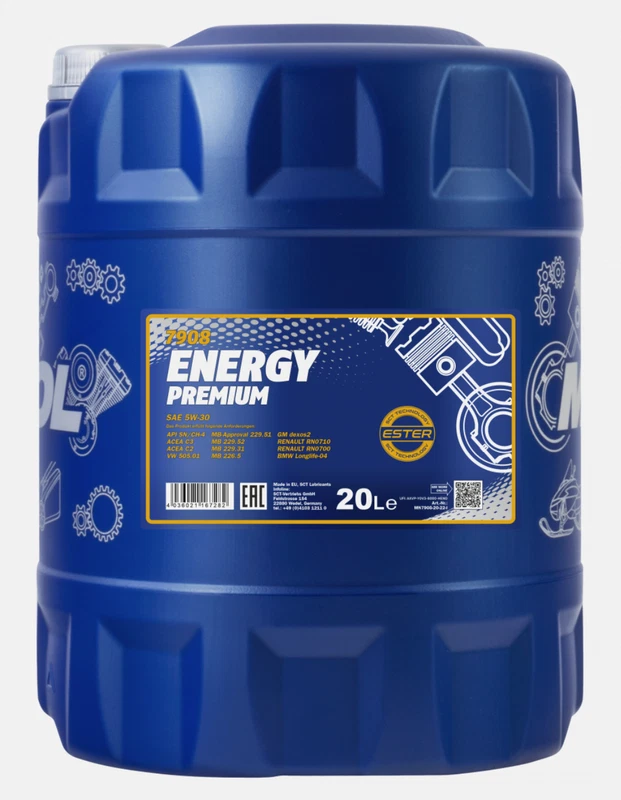

https://www.ebay.co.uk/itm/176696779167
https://i.ebayimg.com/images/g/rvsAAOSw-i9nNp0m/s-l800.webp
Looks like it fulfills the reqt of my 2.1 litre diesel Sprinter van AND my 1.0 L Seat petrol car!
If so I can but this one can for both and few litres left for top-ups.
Thinking
Thoughts?

Time for yet another oil debate Smile
I wouldn't worry so much with older vehicles as long as the weight's correct. The sales blurb says it's for all modern diesel and petrol engines but I suspect they are assuming the engine's already "broken in".
PostPosted: 20:07 - 06 Jan 2025    Post subject: Reply with quote
If the API rating is equal to or better than the vehicle requirements and the viscosity is correct, I'd put it in.

Normally I'd not bother.. but on the Seat and the MB they have extended 20k change recommendstions so it has to be good stuff. I've also seen soem horrors of congealed scum from mixed ingredients clogging pick-ups and oil-ways. The handbook on the Seat is quite strict about it too.

Yeah tis what I think. Just a bit wary as you used to get specific oil for diesels, back in the day.
PostPosted: 00:12 - 07 Jan 2025    Post subject: Reply with quote
Diesel specific oil has a higher detergent content to help deal with carbon fouling.

Meh.. I bought it. It seem to meet both tech requirements and my own req't that the best oil is clean new oil.
