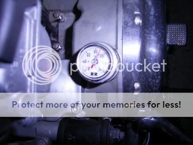

I bought "RR Oil Temperature Gauge"
https://i21.photobucket.com/albums/b295/kawashima_/RR-3.jpg
Normal temp is 80-100 degrees(day).
So I tested dustbin lids at cold night, it was 80 degrees after I run at 80miles/h for 20mins.(photo is 70 : 10 downed)

Before I cut center part off, I felt strong and uncomfortable swirl around my legs, but this time wind stream from outside and inside the fairings seem to be equalized and the swirl disappeared. I tried various speed from 100-160km/h, there was no problem. Oil temp. was below 90 even after 160km/h ride. So I could check overheat tolerance, don't have to remove them lots of times.
https://i21.photobucket.com/albums/b295/kawashima_/finaltemp.jpg
After I got off the motorway, I felt a little bit warmed wind flow at my legs. This warmth and wind flow balance equally and I don't feel hot or cold. This enables me to ride for a long time without a rest.
