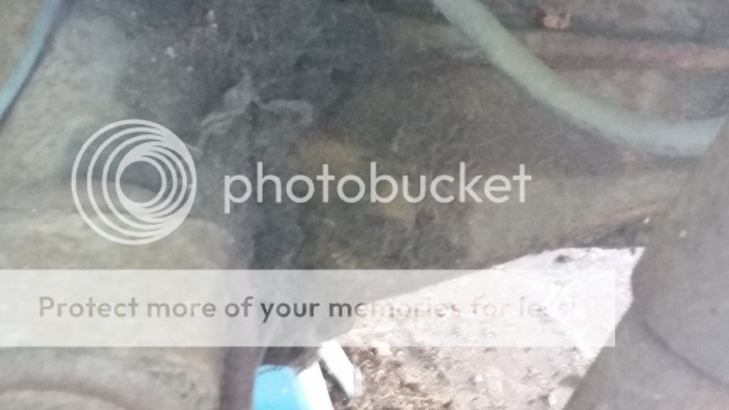

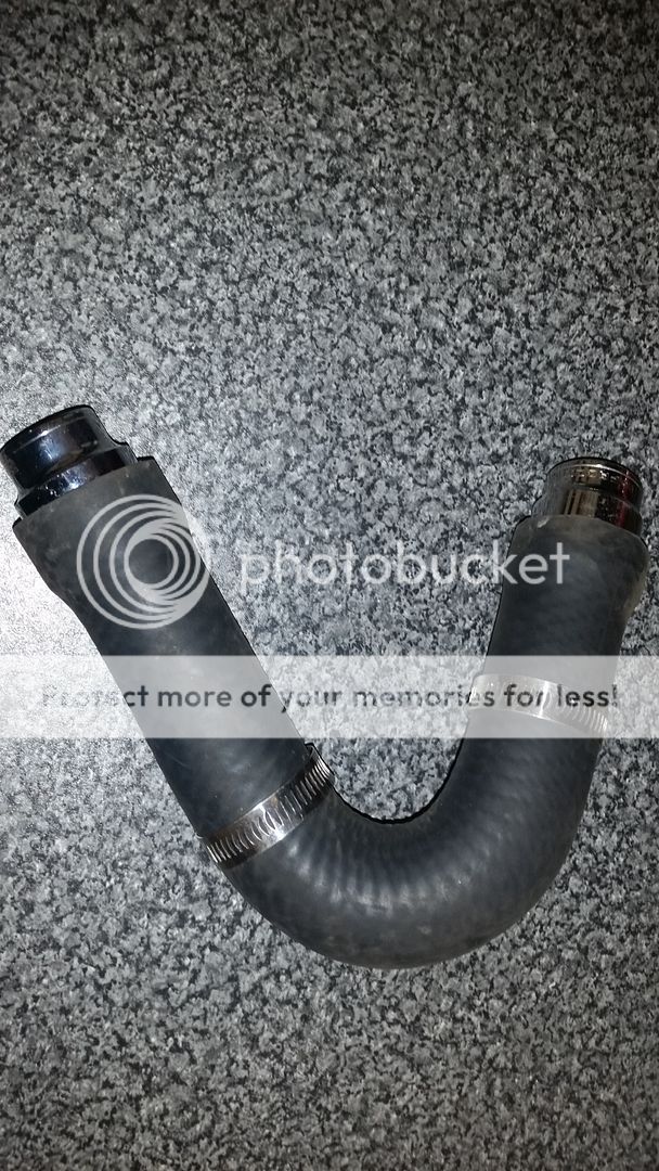

trying to replace the bottom radiator hose is becoming a bit of a nightmare. removal was easy, I just cut it off but fitting the new one is not easy.

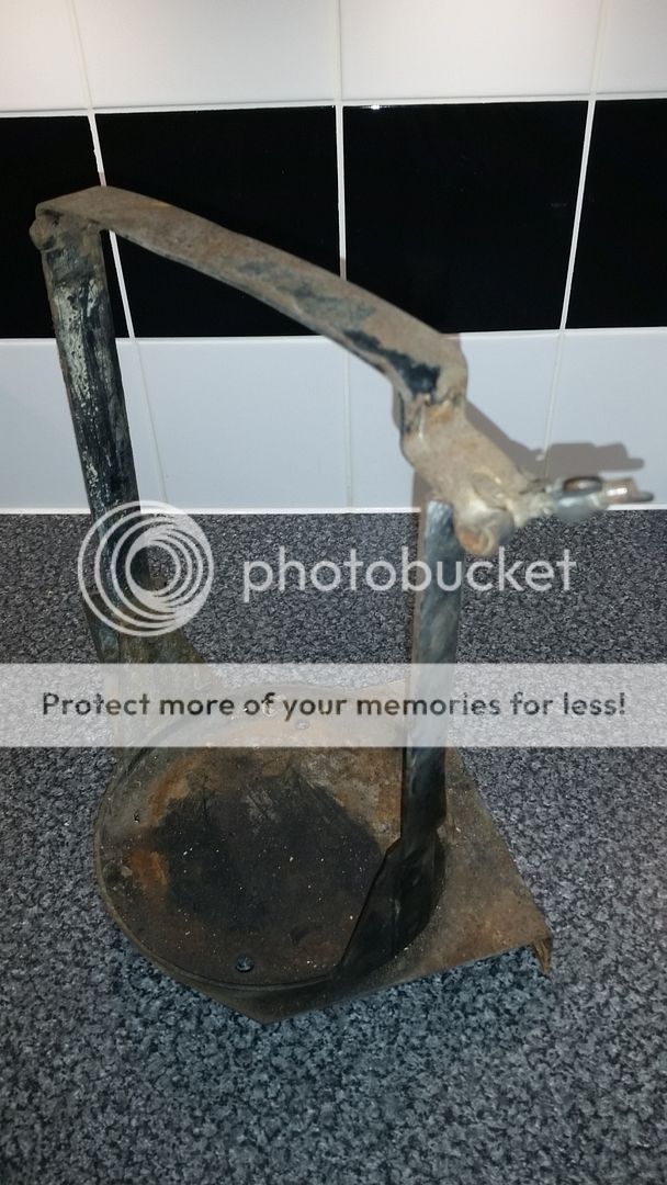

So far I have had to remove the two belts that run the 90amp generator, not easy as it hadn't been adjusted in 20+ years so was solid on its mounts.
Then had to remove the airfilter and mount. The base is held on with 3 rusted solid bolts that you have blind access to and requires a fine ratchet 72+ teeth. Anything less and there isn't enough space to turn the ratchet.
The generator mounts are still in the way but I don't really want to have to remove the generator as well as this there is a solid oil cooler line in the way but I really don't want to have to remove the oil cooler and radiator to just fit a rad hose, seems rather other the top.
As the air cleaner mount is now off I will have to clean it up and repaint it prior to re-fitting so thats another job to do.
https://i945.photobucket.com/albums/ad297/750RK/LandRover/20160119_151434.jpg
The lower hose is now sitting on the side in the kitchen with a couple of large sockets in either end expanding then for easier fitting so hopefully this will be fitted shortly.

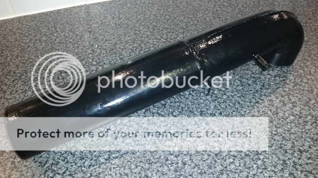

Heres another part thats just been refurbed, the air filter inlet pipe.
https://i945.photobucket.com/albums/ad297/750RK/LandRover/20160119_151559.jpg

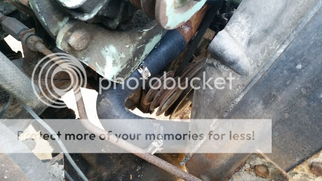

Managed to fit the lower rad coolant hose today. Now its warmer and the hose expanded after having a couple of sockets shoved in its ends it just slipped straight into place.
Hopefully next time I'm off I might have some time to do up the hose clips and some more work.
https://i945.photobucket.com/albums/ad297/750RK/LandRover/20160405_160853.jpg

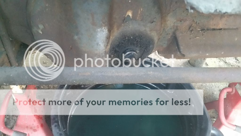

Spent today working on the Deauville as its up for its MOT and flushing the coolant system on the Land Rover as it has to be run for periods of 15-30 minutes at a time.
I used Holts 2 part flush, 1st part is a flush, I'm guessing mildy acidic but not sure and the water that came out looked like this...

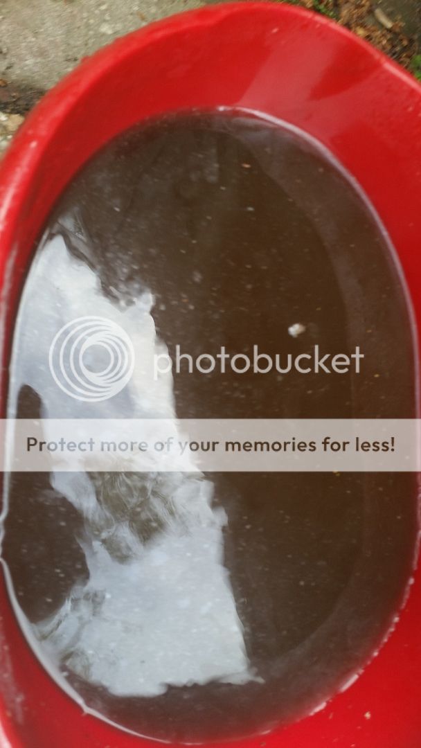

https://i945.photobucket.com/albums/ad297/750RK/LandRover/20160607_184746_1465325454061.jpg
Yep its disgusting. Full of corrosion and sludge, in fact after draining the bucket this was left in it...
https://i945.photobucket.com/albums/ad297/750RK/LandRover/20160607_191237_1465325453642.jpg
So 40 year old collant system full of corrosion and sludge now has a lot less left in it.
The 2nd part neutralises the 1st part but the instructions are potentially dangerous. It says to use immediately after using the first part and to fill the system with cold engine, a recipe for getting scalded as you remove the rad cap and cracking the block when you add cold water. Instead I let the engine cool and then added warm water and the 2nd part.
Now I am going to leave it until morning when I will drain it, run some cold water through it and then fill with coolant.

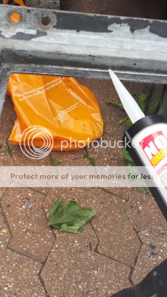

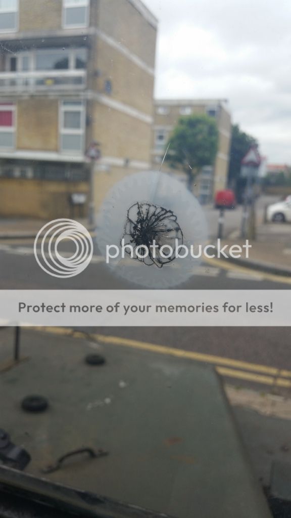

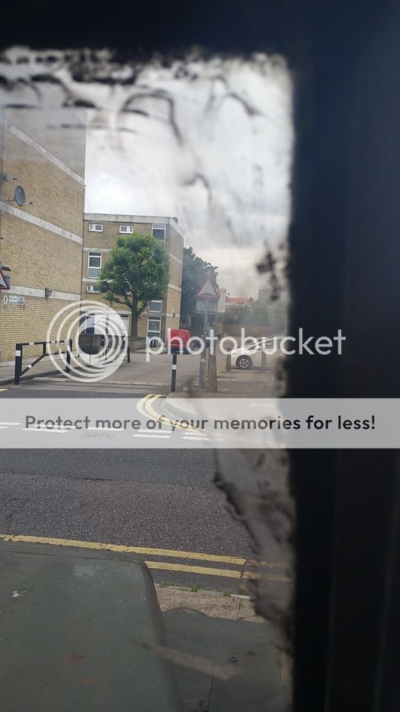

This weekend the windscreens will get changed. They are made of laminated triplex glass. Harder than many car screen but they do fail after a while, normally by delaminating.
If you take a look at the following pictures the black is where the windscreen mastic has been pulled into the laminate by capillary action, same thing with the white areas but that is water.
Mastic.
https://i945.photobucket.com/albums/ad297/750RK/LandRover/20160708_111522_1467994002126.jpg
Water
https://i945.photobucket.com/albums/ad297/750RK/LandRover/20160708_111527_1467994001918.jpg
https://i945.photobucket.com/albums/ad297/750RK/LandRover/20160708_111534_1467994001280.jpg
The screens are held in place by mastic and L sections clamping them in place.
All around the edges of the screens there are white or black tide marks so as the screens are only £28 each I thought it best to just replace them.

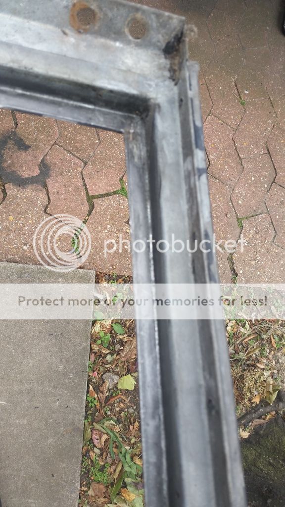

Sp the screens are now done. We took off the retainers and presssed the screens out in one piece and then my assistant for the weekend had the fun job of using an angle grinder with wire wheel to clean the window mastic off of all the retainers.
https://i945.photobucket.com/albums/ad297/750RK/LandRover/20160709_141229_1468076092986.jpg
We also had to clean up the windscreen frame of the mastic, again the angle grinder.
https://i945.photobucket.com/albums/ad297/750RK/LandRover/20160709_135617_1468076093555.jpg
As said the windscreen was fitted using clear silicone this time, lots cleaner to do.

For the last few days I have been in bed with ManFlu but managed to do a bit this afternoon. Decided to change the oil on the front axle and the swivels, the bits that steer.
This is the back of the right hand swivel, you can see the brake plate on the right and the level bung half way down the body.
https://i945.photobucket.com/albums/ad297/750RK/LandRover/20160717_200606_1468784741534.jpg
You drain the oil, assuming there is any left in the swivel through a plug in the bottom and then refill by injecting oil throught the level plug until it leaks out.
Annoyingly the Haynes book of lies says each side should hold 1.4 litres but in fact only hold about 500ml. It also seems that there are no torque settings.
The front axle is pretty much the same, drain through the bottom and then I filled via the front level plug which can be seen here.

Refilled the rear diff this morning. Easiest to do it by removing the rear right wheel as this gives good access to the filling point.
This picture gives a good view of the diff
https://i945.photobucket.com/albums/ad297/750RK/LandRover/20160718_164250_1468869229269.jpg
And under the oil and fur the diff fill hole
https://i945.photobucket.com/albums/ad297/750RK/LandRover/20160718_164254_1468869229170.jpg
And a clearer picture with the crap cleared away
