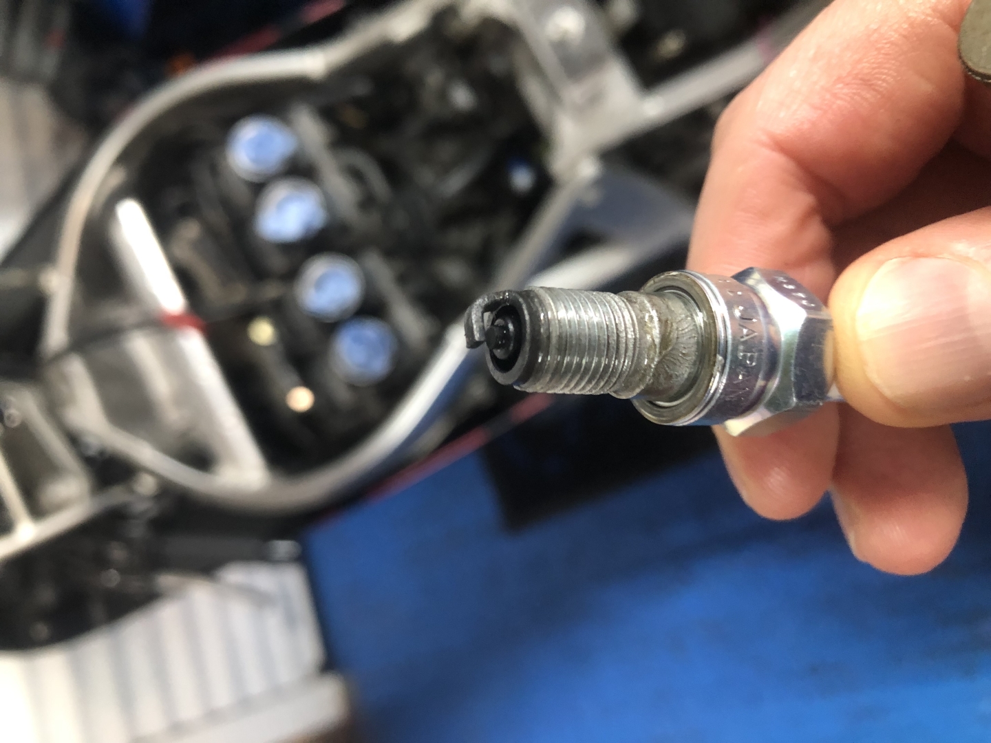

So beginning of this week I got excited about this red letter day, so I thought I'd check that the 'Blade worked OK. It did not.
It turned over and over and over and over, and coughed a couple of times, but there was no life. Damn. Seeing as I've not run the bike since February, I was worried about the whole 'modern fuel kills Carbed bikes that are stored' thing. I was hoping this was not the case due to the strong smell of fuel I got from the bike when trying to start it. I read a few forum posts, and scratched my head and came to the conclusion that the issue *might* be fouled plugs. I remember the previous owner saying he 'never used the choke' which was a concern in itself.

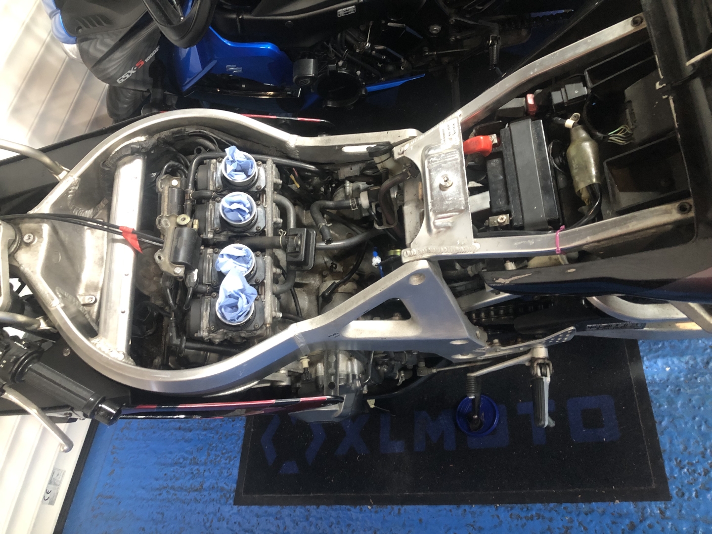

I ordered some new plugs (which aren't cheap!) and in advance of that, I decided to dismantle the bike to get to the plugs. I took the tank off, I took the airbox lid off, I took the airbox base off, and there is a weird heat shield between the head and the airbox that was a faff to remove. Once I did, I then tried to remove one of the plugs. Turns out my plug spanner was too fat to fit into the head. Again I searched forums and found the only tool you can use is the one from the bike's bundled toolkit. Which I don't have. Damn.
So I did more googling, and found that Euro Car Parts did a set of think wall plug spanners, so I nipped over to Basingstoke and bought it. When I got back, this was what I found:
https://files.catbox.moe/axlu8l.JPG
The plugs STANK of petrol. I'm now certain that the issue is the plugs.
https://files.catbox.moe/cqlib8.JPG
The plugs arrived today, and so I fitted them. The bike went back together surprisingly easily, and then I took it for a quick blast.

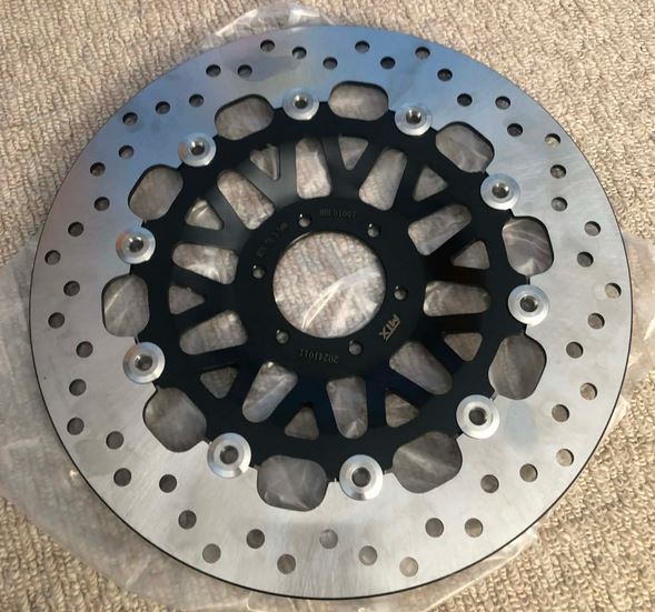

A note on what has become the brake disc saga:
The Ebay chinesium discs were not available with gold centres, but I found some MTX discs available purportedly with gold centres. Another advantage these discs have is that the centres are identical in pattern to the OEM ones, not just vaguely similar. So I ordered them. I then received a phone call asking if I had ordered the right ones... I had to explain that I had an SC28 but it was a 1994 RR-R. I think the company I ordered from mainly did car parts, and so the whole thing seemed quite confusing. I ended up talking to a guy who said he owned an original round headlight SC28 and thought that mine was an SC29... which I don't think exists. Even so, he said it's a FireBlade RR-R Foxeye model. I explained at that point that I really wanted discs with gold centres not black to keep the OEM look. Fast forward a week (so much for Evri's '2 day' service!) I receive the discs. They are F*cking black!
I know it's a dumb thing, but I was REALLY pissed off. So I called them back and they gave me the runaround for a bit until the FireBlade guy eventually contacted me, and said he'd check with the supplier. The supplier then told him they had gold in stock, so I asked him to get me a set. He went off and ordered them, but then got back a message saying they had no gold in stock, only black.
So the 'pattern' disc that David Silver and other suppliers list is an MTX disc, which means the gold centre discs for this bike are Just. Not. Available.
Annoying but I'll have to fit the discs I have I guess. I did talk to AllBikeEngineering to see if they could do anything, and they replied that they could 're rotor' my OEM discs but at a cost of £130 plus VAT each, which is quite a bit more than I paid for these MTX discs. Plus I was only going to pay £100 each for the Chinesium ones in the first place!
So what I plan to do is keep the MTX ones, and maybe if I can be arsed or if the black centres bother me, send the OEM discs off to be 're rotored' but that will certainly break the budget on this bike.
I may have time at the weekend to fit the discs, but I have a trackday in 2 weeks time and so need to prepare my GSXR.

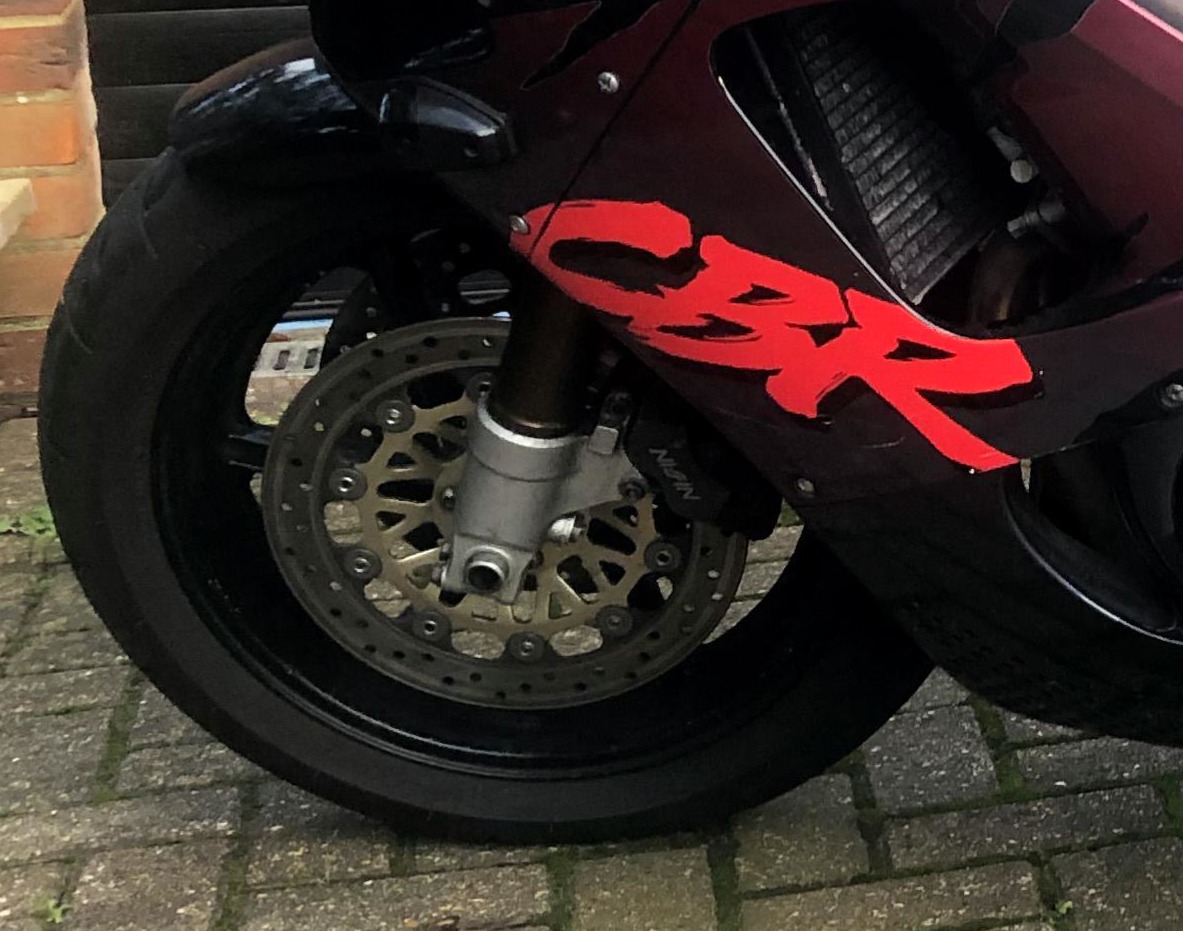

Straight spokes are OK if the bike originally had that, my bike does not. I have a choice between gold straight spokes, or black criss-cross spokes. I figured black criss cross spokes would be the best compromise, considering the front wheel is also black.
OEM:
https://www.bikechatforums.com/files/oemdiscs.jpg
MTX black centres:
https://www.bikechatforums.com/files/mtx_105.jpg
