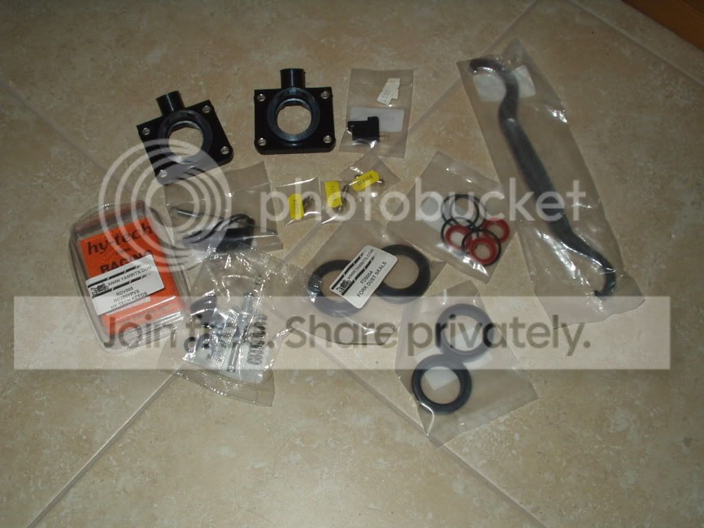

I finally got my order with YAMBITS sorted, and I'm waiting on the following to arrive in my post box:-
Rear brake switch
Rear brake bleed nipples
Front brake bleed nipples
Carb inlet rubbers
Hy-Tech reeds
C- spanner
Dip stick
Fork dust seals
Fork oil seals
Rear master cylinder repair kit
Front brake light switch
Power valve seal kit
Despite having a leaky tank, I managed to get it running a few weeks ago, (once I'd flicked the kill switch). Embarassed
Once I've fitted the parts listed above, and made sure everything works, I'll be stripping the bike down to a bare frame, bending the RHS exhaust mount back into place then seeing if I can find someone to do the nickel plating for the frame.

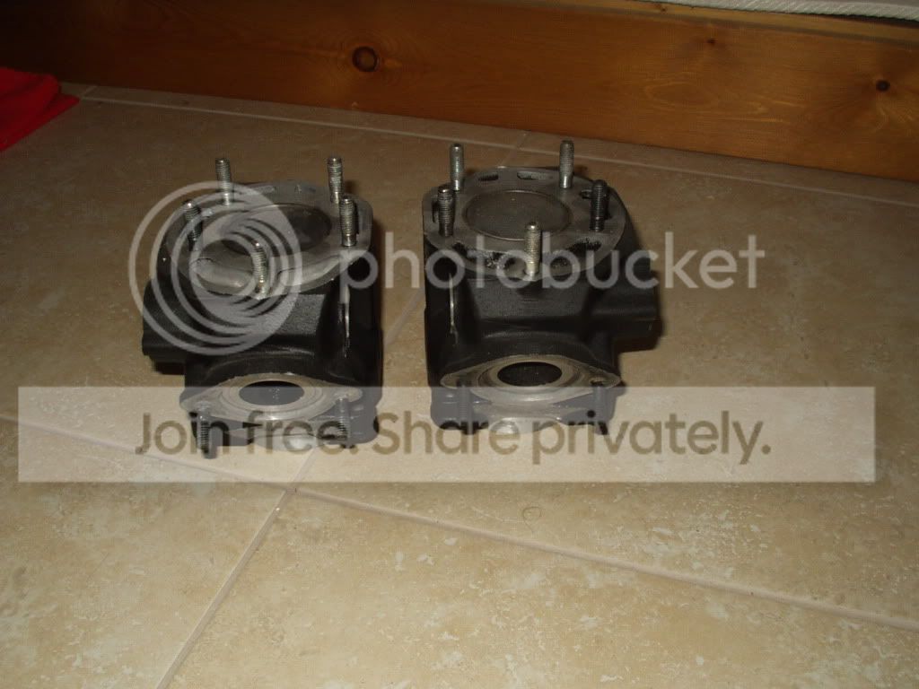

Got this lot a while ago, barrels, pistons and reed blocks,now cleaned and repainted:-
https://i645.photobucket.com/albums/uu172/Troodos-Pool-Guy/RENEWEDPARTS.jpg

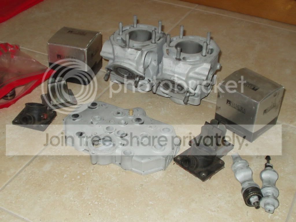

Picked this lot up a couple of weeks ago for 120 Euro, head barrels, pistons, powervalves and reed blocks, all sand blasted. There is quite a lot of pitting on one cylinder head, will have to try and polish that out.
https://i645.photobucket.com/albums/uu172/Troodos-Pool-Guy/RZR%20250/SANDBLASTPARTS.jpg
Got this little lot from YamBits last month, fork oil and air seals, powervalve seal set, new inlet rubbers, brake bleed nipples, Hytech reeds, front and rear brake light switches, rear brake master cylinder repair kit and a C-spanner!
https://i645.photobucket.com/albums/uu172/Troodos-Pool-Guy/YAMBITSPARTS.jpg

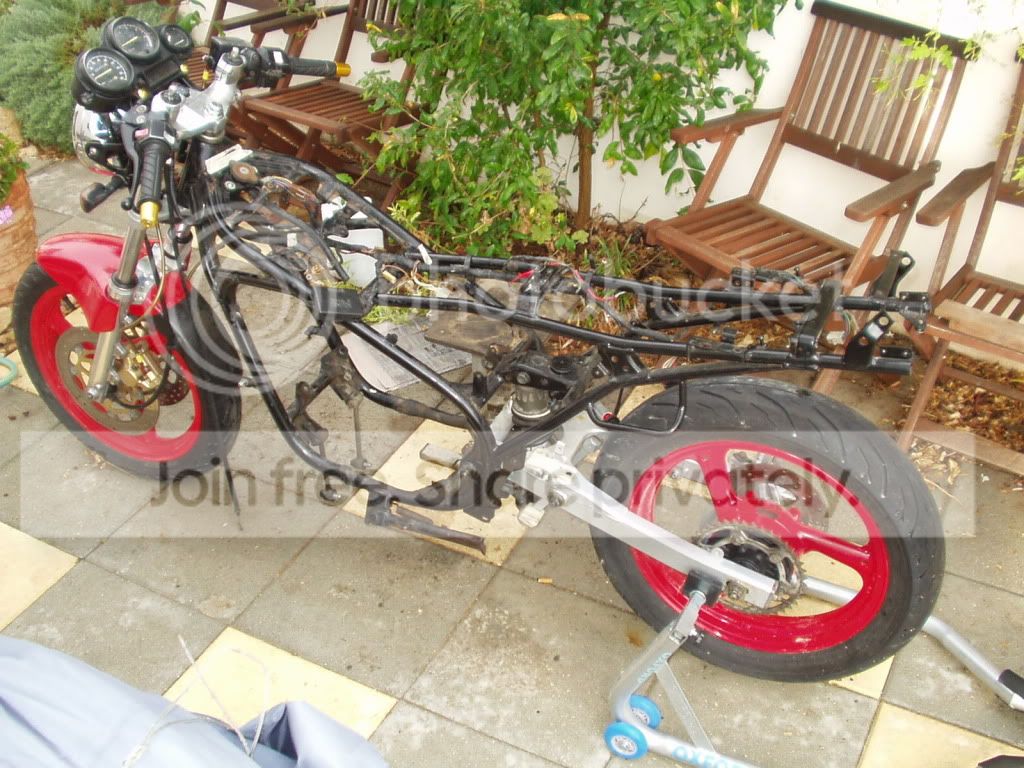

Anyway, between thunder storms, this weekend, started to strip everything off the bike, et voila, we now have a rolling chassis.
https://i645.photobucket.com/albums/uu172/Troodos-Pool-Guy/ROLLINGCHASSIS.jpg

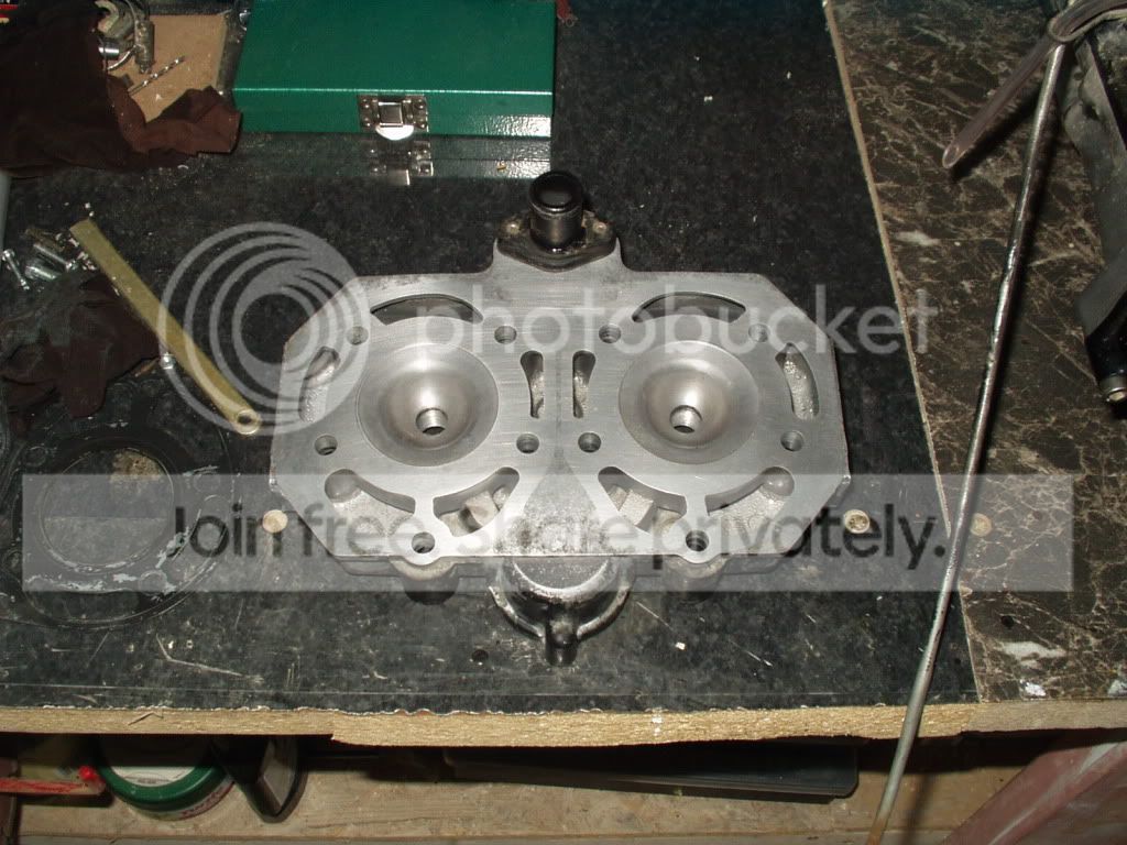

Got the engine into the shed, before more rain arrived, so thought I’d have a look at the head, here it is after 5 minutes work with a plastic kitchen scourer. I did take a before picture but it dissappeared:-
https://i645.photobucket.com/albums/uu172/Troodos-Pool-Guy/HEADCLEANED.jpg
The piston tops look a tad coked up, mind you I was running premix when I was bleeding the oil pump so it was getting a lot of oil last time I ran it:-
https://i645.photobucket.com/albums/uu172/Troodos-Pool-Guy/RZR%20250/COKEDPISTONS.jpg

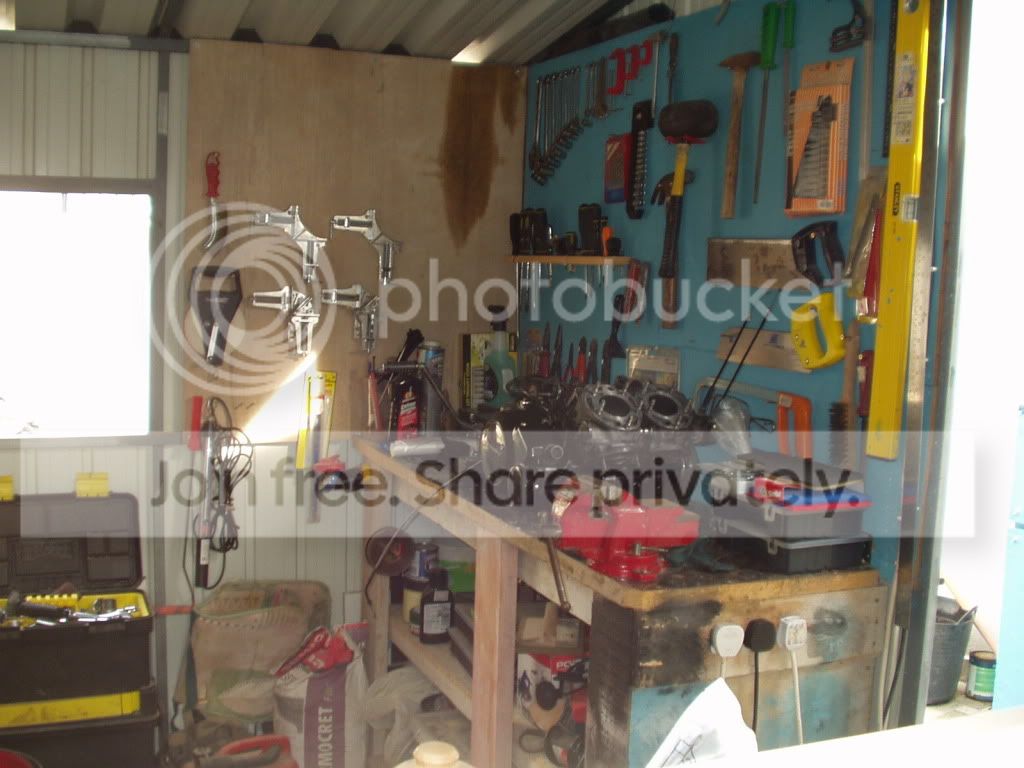

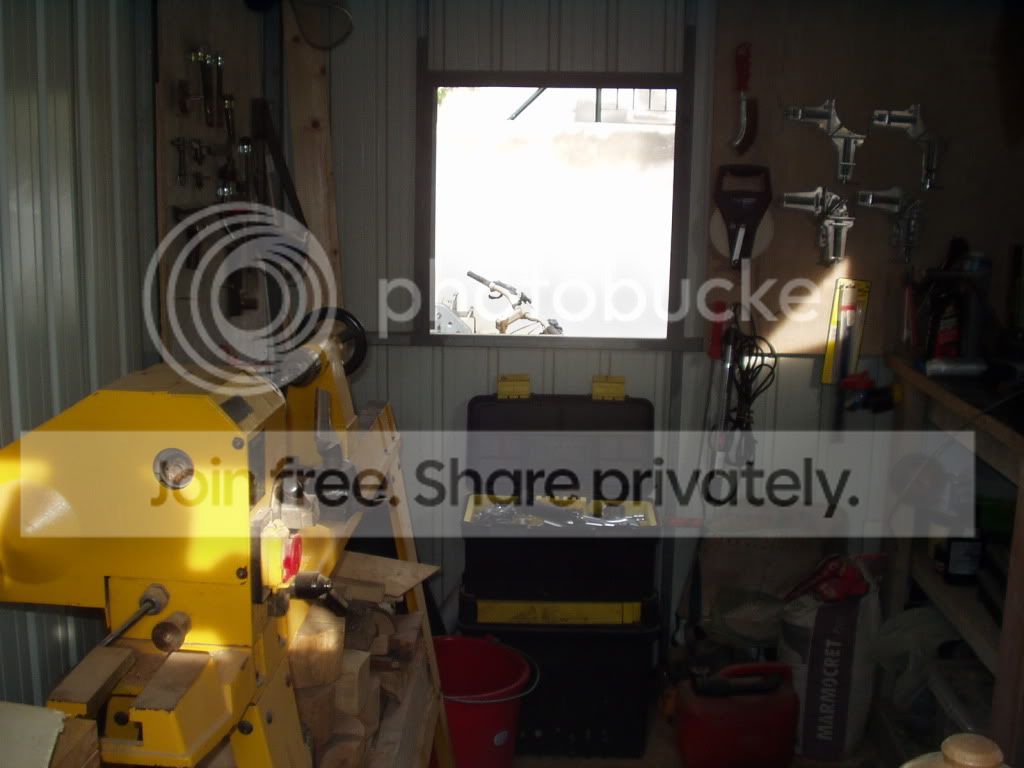

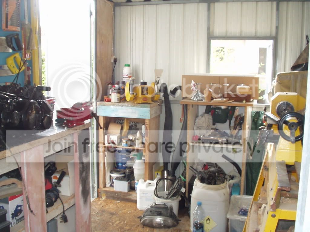

In honour of removing the engine I thought I better tidy my shed a bit, not too much though!
https://i645.photobucket.com/albums/uu172/Troodos-Pool-Guy/SHED01.jpg
https://i645.photobucket.com/albums/uu172/Troodos-Pool-Guy/SHED02.jpg
https://i645.photobucket.com/albums/uu172/Troodos-Pool-Guy/SHEDO3.jpg

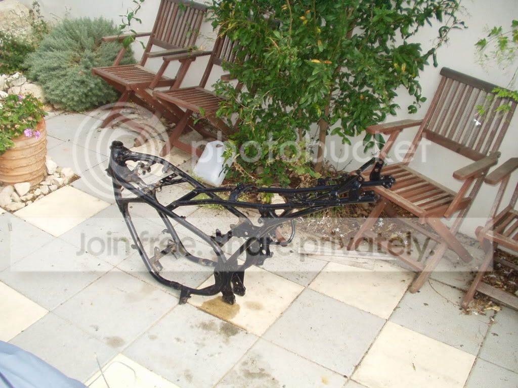

PostPosted: 21:53 - 12 Oct 2011    Post subject: Reply with quote
Now reduced to this:-
https://i645.photobucket.com/albums/uu172/Troodos-Pool-Guy/RZR%20250/frame02.jpg
Gave it a quick clean, will be contacting the powder coater soon.

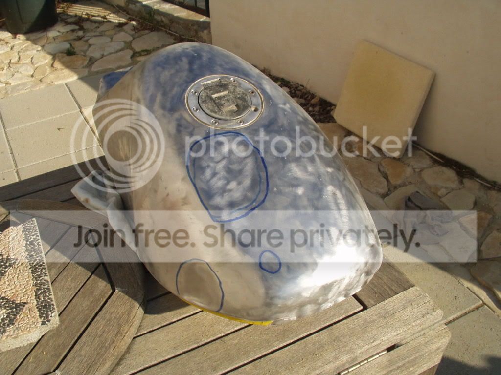

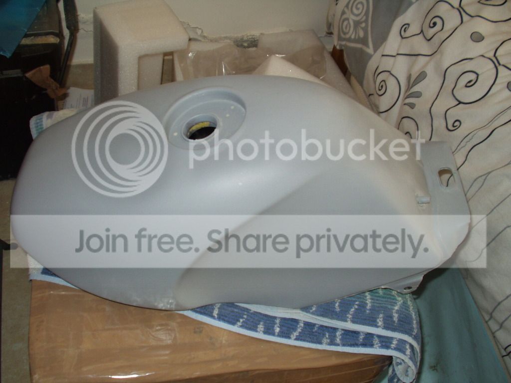

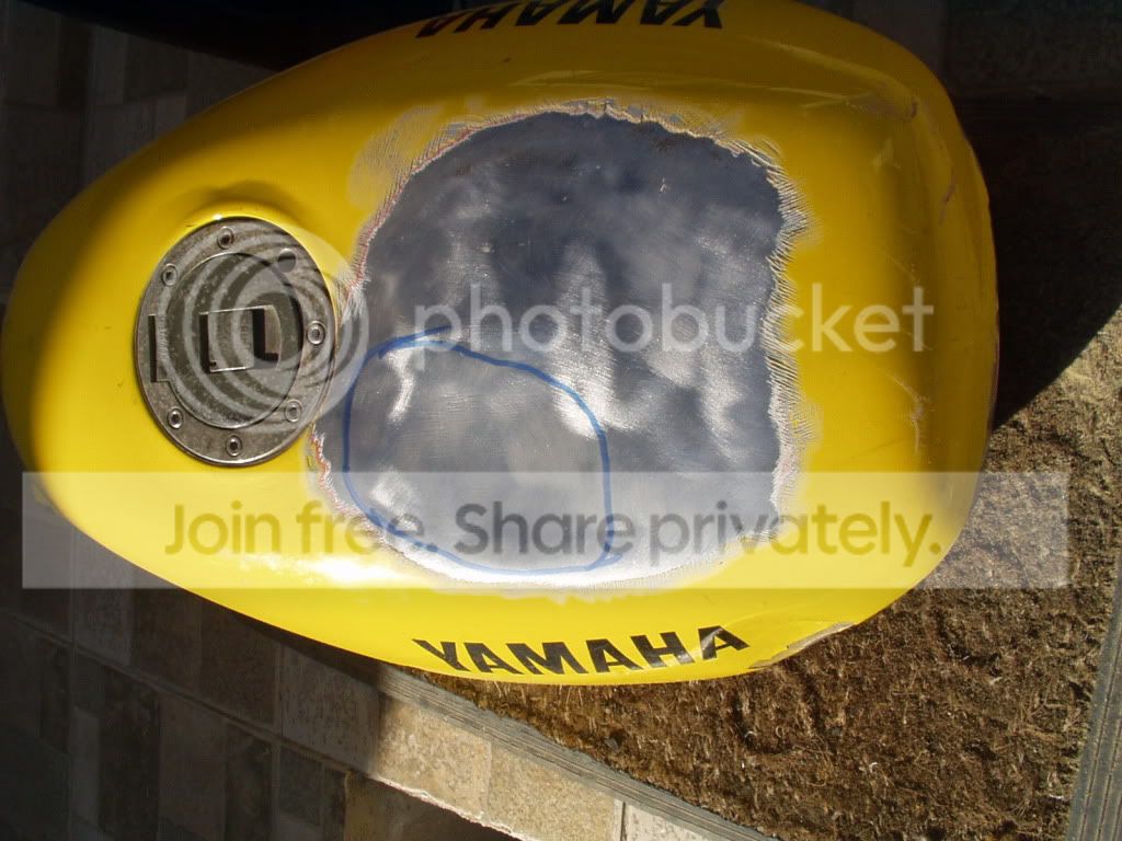

Well I fianally got a tank.
It arrived a couple of weeks ago, I knew it had a couple of dents, so as long as it is leak free it should do the job.
The tank had a shallow dent about the size of the palm of your hand right on top just in front of the filler cap. There was a smaller dent near the seam at the front, and another, very small, dent on the top.
It looked a lot worse than it was, paint had cracked in concentric rings around the largest dent.
This afternoon I set about removing the paint. There was about 2mm of paint, I could pull chunks of it off around the dent.
All in all there were four different paint schemes, lying dormant.
At the bottom of the heap was the orignal white and red, over that someone had painted some dayglow pink, on top of that there was a layer of orange, and on top of that was the yellow you see in the photo.
Considering the amount of paint, I decided to go with the electric drill and wire brush method of removal. it took about an hour and a half to get it all off.
It was a bit scary really because these tanks seem to rust for fun, so the chances of making a hole with the wire brush are quite high. As luck would have it there was no rust, so all good.
Large dent:-
https://i645.photobucket.com/albums/uu172/Troodos-Pool-Guy/RZR%20250/tank01.jpg
All dents:-
https://i645.photobucket.com/albums/uu172/Troodos-Pool-Guy/RZR%20250/tank02.jpg
Paintless
https://i645.photobucket.com/albums/uu172/Troodos-Pool-Guy/RZR%20250/tank03.jpg
Once the paint had been removed I gave it a wipe over with some thinners the filled the dents with filler, which is now drying.
A satisfying couple of hours work, but I hate rubbing down body filler.

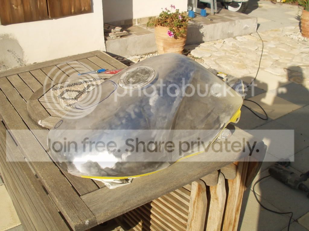

Well, here's the latest progress on my project.
My fuel tank now looks like this:-
https://i645.photobucket.com/albums/uu172/Troodos-Pool-Guy/2104TANK.jpg
I'm not happy with the dent I filled, it's still not quite the right shape, going to add some more filler soon.

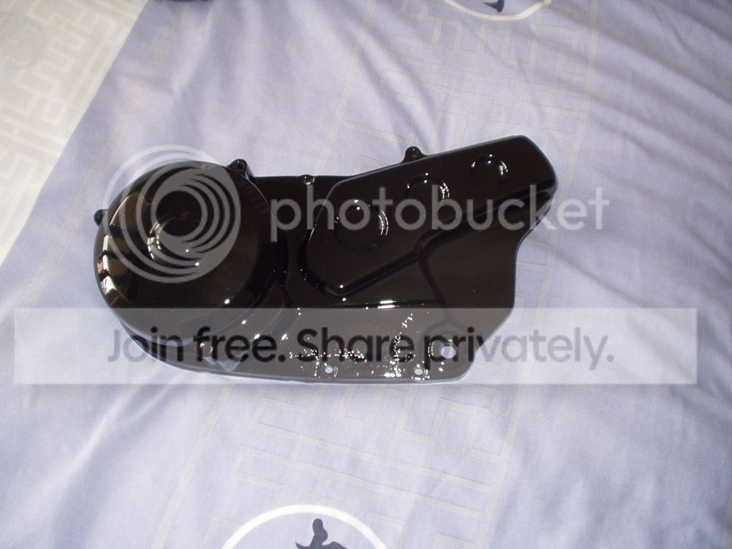

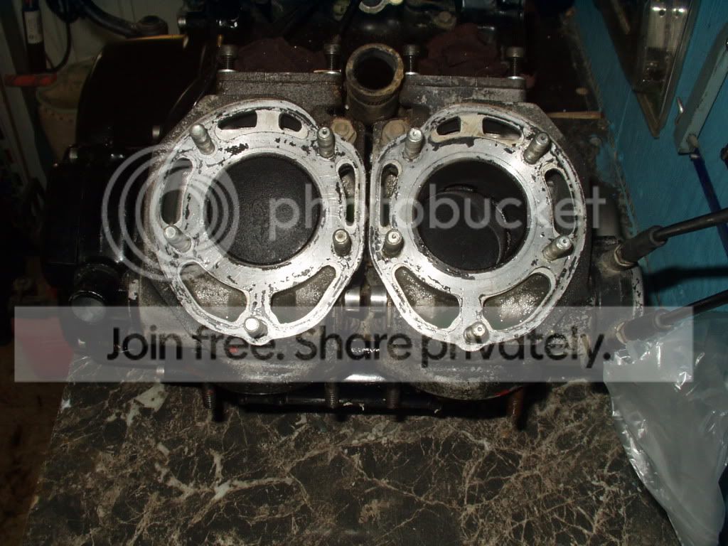

Got the head, barrels and power valves off, here's a before and after comparison:-
https://i645.photobucket.com/albums/uu172/Troodos-Pool-Guy/2104BEFOREAFTERBARRELS.jpg
https://i645.photobucket.com/albums/uu172/Troodos-Pool-Guy/2104OLDNEW.jpg

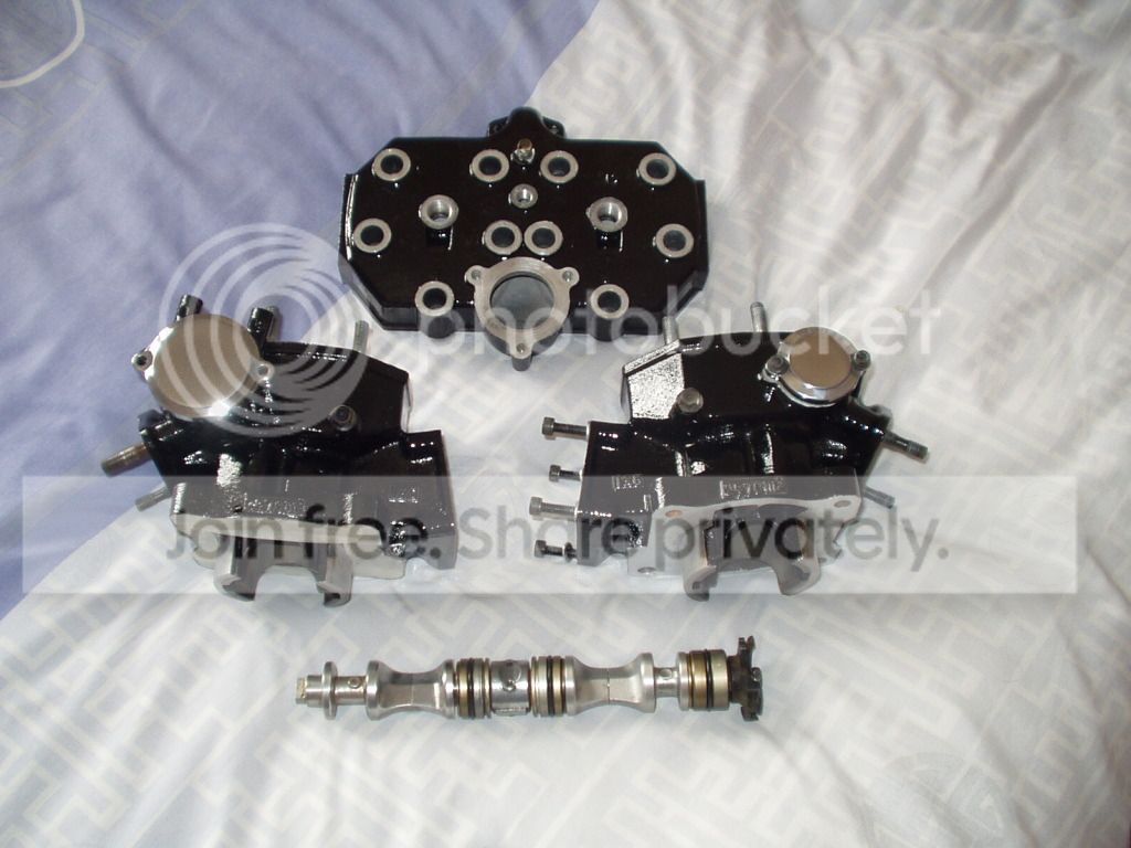

Here's everything after cleaning painting and polishing:-
https://i645.photobucket.com/albums/uu172/Troodos-Pool-Guy/2104BARRELSPAINTED.jpg

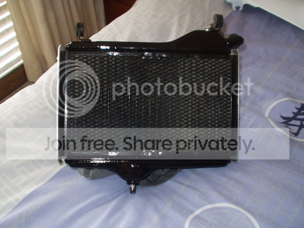

I've been using a heat resistant enamel paint, (mega shiny), which requires a primer, I've been brush painting these parts.
Same heat resistant enamel on the radiator:-
https://i645.photobucket.com/albums/uu172/Troodos-Pool-Guy/2104RADPAINT.jpg
And the same with the engine cover, had to have two goes at this before I got a decent finish. It's not a good photo there's a lot of reflection, from the flash, around the gear selector hole
https://i645.photobucket.com/albums/uu172/Troodos-Pool-Guy/2104CASEPAINTED.jpg

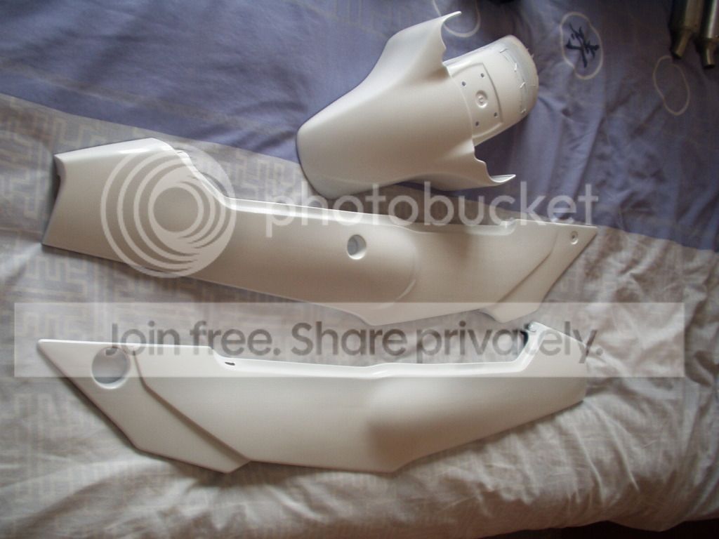

Here are the side panels and front mud guard, forgot to take any before pictures.
Both side panels were cracked, I repaired them by cutting out thin strips of metal, gluing them to the back of the panels, then fibre glassing over them.
The left hand panel had a chunk missing out of the bottom corner at the back. I used the same process to repair it, shaped piece of metal, fibreglass and filler.
They're painted with a rattle can, and have come out really well.
Haven't started on the lacquer yet, I'm still pondering on a design.

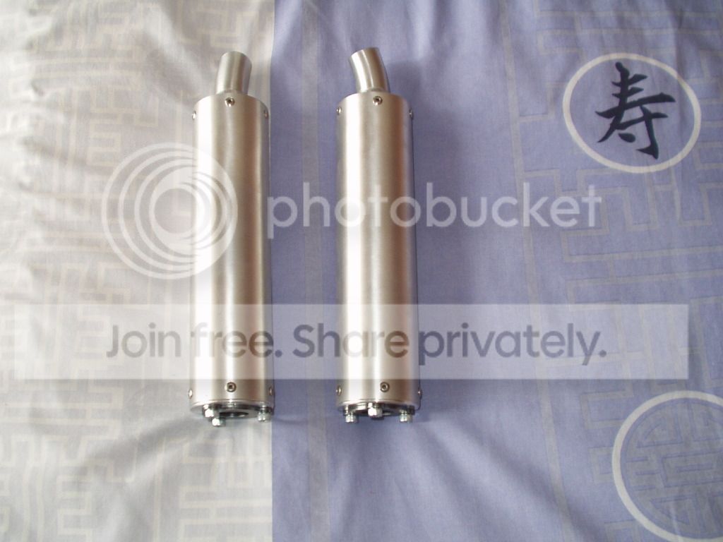

Got some new end cans, the originals were too far gone.
Apart from anything else I've shaved about 5lbs of the overall weight. Cool
I'll have to have some spacers made up as the new cans are a lot smaller in, overall, diameter than the originals and there's not enough room to drill new holes in the pipes.
https://i645.photobucket.com/albums/uu172/Troodos-Pool-Guy/2104NEWCANS.jpg
