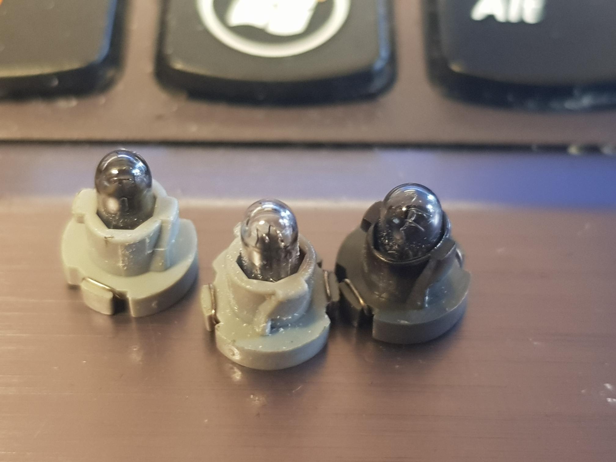

The tiny bulbs in the clocks are replaced, the one with the darker base is 1.1w and the other 2 are 0.7w.
