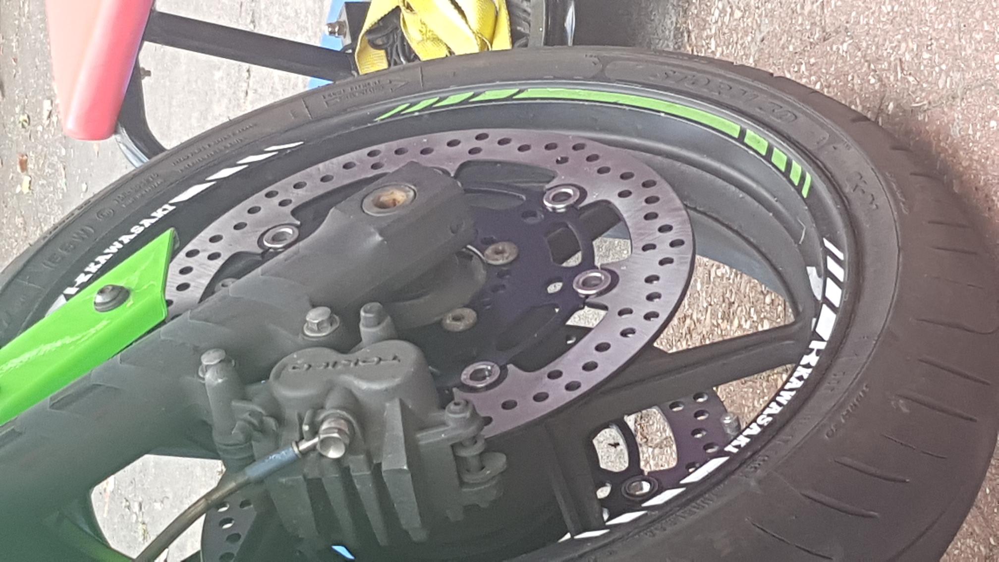

I decided the front discs needed replacing, they were down to about 3mm in thickness. These were the 2nd set to be fitted to the bike.
Having a look around the price of discs was high, around £300 a set but a set popped up on Ebay from Tourmax.
For those that don't know Tourmax is a Japanese company that buys excess stock from factories so back in my trade days I would buy their parts which would turn up in a Tourmax box and the parts inside would be in for example Honda wrapping.
The Tourmax discs were only £140 a pair which is an absolute bargain for floating discs. The discs are ground to spec with grind marks ( you can see this in the 2nd pic) in place, there is no zinc coating on them, they are covered with oil to prevent corrosion in storage which your have to thoroughly remove before use.
As always I used my trusty Facom impact driver to remove the disc bolts which came straight out without a problem.
These discs are threadlocked in place with a relatively low torque setting, as they are shouldered bolts supported in the wheel there is very little force trying to remove them.
An hour later it all went back together nicely and looks like this.
https://www.bikechatforums.com/files/img-20220719-wa0005.jpeg
https://www.bikechatforums.com/files/img-20220719-wa0007.jpeg
Plain looking discs but they work and the price over rides the lack of bling factor for me.
I used the old pads as there was a lot of meat on them, sanded the surfaces back to get them flatish.
