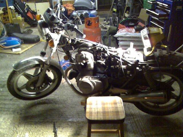

works begin!
- first off the tyres needed inflating so hooked them up and job done.
- seat removed to get to bits and pieces.
- tank shut off and removed.
- bike rolled out into the middle of the garage.
- front brake drained of fluid (very little)
- brake line removed
- caliper removed and slightly cleaned up. pads ok, seals appear ok.
- brake resevoir, brake lever and mirror removed.
- hooked up to old car battery - all electrics / bulbs work.
https://img.photobucket.com/albums/v383/keir_compact/dreamstrippedrs.jpg
Problems at the min:
- throttle does not move. cables all appear ok believed to be carb end not working properly.
- cant remove carbs due to space confinements near engine. probably going to remove engine as frame paint is peeling and slightly rusty.

NSR Mick
Joined: 26 Jun 2005
PostPosted: 15:43 - 17 Aug 2006    Post subject: Reply with quote
They will come out without dropping the motor. Thumbs Up
Keir
Joined: 11 Apr 2006
PostPosted: 15:45 - 17 Aug 2006    Post subject: Reply with quote
any idea how? Im struggling as they just dont seem to budge!
Current : '08 Yamaha FZ1s
NSR Mick
Joined: 26 Jun 2005
PostPosted: 15:48 - 17 Aug 2006    Post subject: Reply with quote
It's been a long time. If you get the airbox out I think theres just enough room to pop them out of the rubbers and wiggle them out.
Keir
Joined: 11 Apr 2006
PostPosted: 15:50 - 17 Aug 2006    Post subject: Reply with quote
ok i'll give it a go. thanks.
