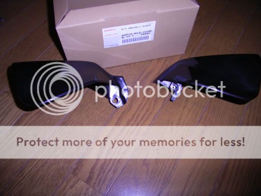

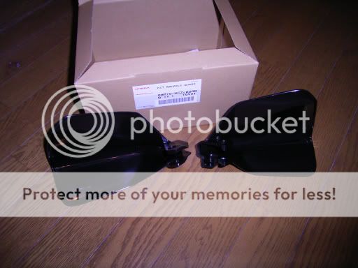

I ordered XR250 option at Honda shop.

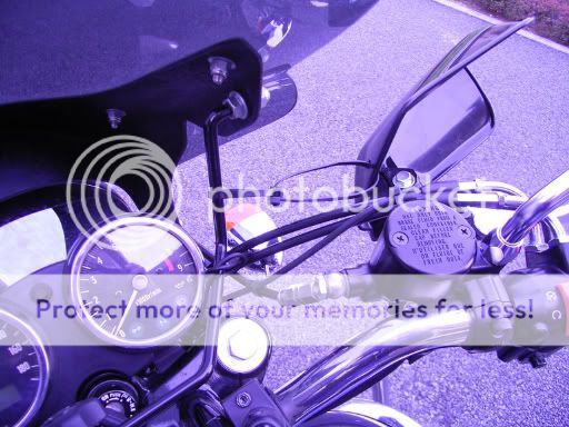

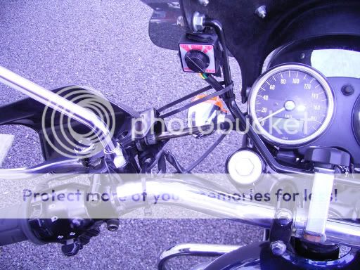

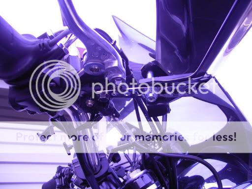

It took 3 hours doing try and error. I wanted to attach with bolt and nuts on pivot of brake and clutch levers, but they didn't fit so I used cable ties and metal plate extension.

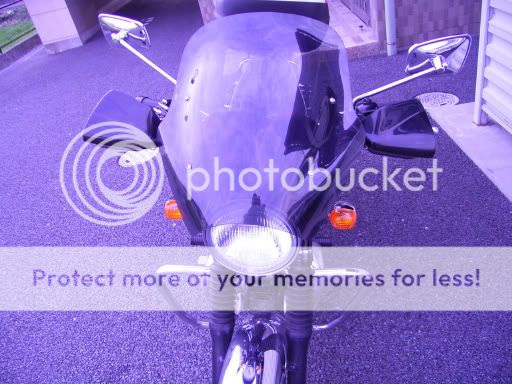

I went out for a test ride.
I've already had heated grips. They worked well together. I'm expecting rain protection too.
