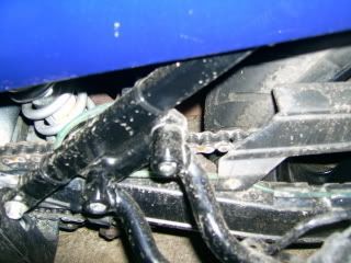

This is a picture of the chain I put on my KLE500 exactly 14 days ago, with new sprockets too.
After fitting it, I carefully lubed every link with castrol chain wax with the bike on a paddock stand.
I then rode 800 miles, reapplying the wax once at roughly the halfway point. I waxed it again on returning home then put the bike in the lockup.
The bike has now sat in my lockup for ten days.
I have just spend half an hour de-gunking and setting up my scotoiler again.
It was gold coloured when it was put on.
NickD

Always found that stuff too 'dry' to apply properly. A scottoiler's the only serious option for year round riding. I had 23k out of the chain on my speed triple, and it was still in good nick when I sold it. Thumbs Up

Also, if you apply chain wax thick enough for it to do it'd job, it very nicely picks up loads of grit and turns into a grinding paste. As of next wednesday, I'm doing 110 miles a day, as of last saturday, I have a scott-oiler.

I don't touch chain wax, the Castrol stuff especially, as mentioned it soon becomes a grinding paste that needs cleaning.

YUP! so true, i used this stuff to find my chain quickly turned into a sludgly mess!

I know what you mean Jon, it turns it all god damn green. Looks like your dog just spewed over it! Sick

I used to use wax...it just created a grinding paste which didnt look too good. Laughing So i bought and fitted a touring scottoiler which so far seems to be doing the job just fine.

Putoline ceramic wax is good, but like others have said it becomes a grinding paste, which means i have to clean the chain and re-lube it very frequently, normally every 1-200 miles. It's ok as long as you remove the paste, but chainsaw oil or a scottoiler would probably be better.

I didn't get on with Castrol Chain Wax either, I didn't think it did a very good job and if I remember correctly it made you chain look a manky greeny/yellow colour.

i like using the Wurth High Performance Dry Chain Lube - had a few cans now - very little fling - can't really tell its on the chain, cause the chain still looks good.
i bought castrol chain wax first when i bought my bike - its crap - it sticks to the chain ok - and thats the problem, every-bloody-thing sticks to the chain wax then.
i bought a can of putoline chain lube last time - and it has flung bloody everywhere!!!!
stick to wurths high performance dry chain lube - its bloody great stuff Mr. Green

Agree, wouldn't use the stuff again after the gunky, sticky, frothy-snot mess it used to leave my chains in.
