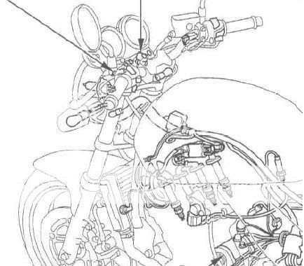

https://i58.photobucket.com/albums/g257/hmmmnz/hornetplugs.jpg
all you need to do is remove the tank, pull the lead off and get a long reach socket to get the plug undone and pull out the plug.
you dont need to remove any thing more than that Thumbs Up

The No2 plug can be hard to get out but if you have the right socket it
will be fine.
