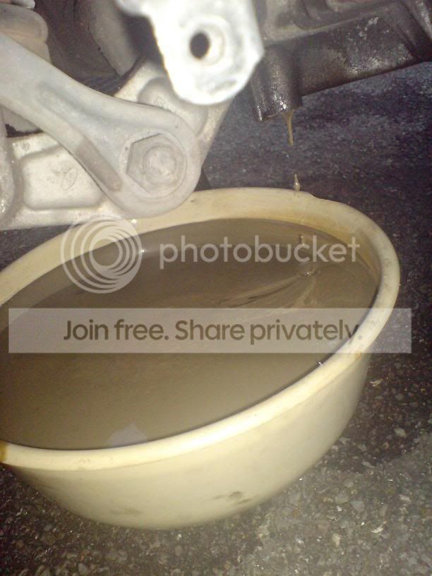

well. as said in another thread my head gasket went a few weeks ago, resulting in no compression, oil/water mixed and a angry Dammy!
instead of rebuilding the engine straight away i thought i would save myself some time, get a 2nd hand engine, put it in, and repair mine and give it a big ol overhaul.
well i shot down to Portsmouth this morning and collected a engine from a decent lad down there, seemed to know alot about zxr4's and races them.
was back home by 4.30, had a spot of lunch, and lazed till bout 7. started work on the bike, Binge came down gave a hand, and by 2 oclock this morning had the new engine in, and ready to go,
gonna sort the teething probs in the morning. as it would be taking the royal Pi$$ starting it tonight.
anyway here are some pics,
the tub full of crap is the oil i pulled out of my old engine.!!!
