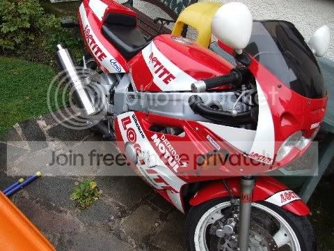

Just after some peoples opinions of the bike. Anyone own/ed one?
Good points?
Bad points?
Cheers all,
Smile
Bike in question:-

Yes, got one. Bought as a cheapy for commuting. Mine is the slightly newer version with the letterbox shaped headlight. Mine is now up to about 51k.
Common problem is the gearbox. 2nd gear from memory. Plastics are difficult to find 2nd hand. Rear tyre is a 150/60 18, and should be a V or Z rated tyre (and the only people who still make that size / speed rating are Bridgestone with the BT014, and they are not cheap). Suspect most just fit H rated tyres (rated for 130mph, FZR should do a touch over 140mph).
Weak clutch. Typical Yamaha. Finish is not great but OK. Watch out for warping brake disks (occasional problem, was far more of a problem on the FZ750 and FZR1000 with 320mm disks). Exhaust rots.
Airbox can be a pig to get back on he carbs.
Had occasional issues with the gearchange pedal starting to seize up on the pin it pivots on. Easy to fix and grease up, just seems to need doing again shortly afterwards! Mine also seems to eat clutch cables.
I like the handling. Brakes are fine. Performance is fine (yes there are quicker bikes around, but it is quick enough and produces power in a fairly nice way). Not bad on petrol and a decent size petrol tank.
What is that on the swinging arm of that one?

Yh im buying this one for £500, its a 91 model with 25000mile on it, from all the pics ive got of it, it looks mint for a old bike. Im only buying it for a cheep run a round, just untill i get things sorted with my compensation etc (... long story). Untill i get some more money for a better bike etc.
But i think for £500 it looks well worth it, and from what you have said about them, they dont seem a bad bike. I will have to check out the gearbox, like you said. Also about the tyre size, the tyres on them are they 17" (standed size)?
If not, hows the handling with the standed tyres on them??

Looks good for the price.

Handles nicely on the stock wheels / tyres. Front is a 17" as standard, while the rear is an 18". Could be someone has stuck on the back end from an FZR600R or Thundercat.

Yh i think it looks v clean, especially for the price!
I love the ''Loctite'' rep looks too, different i suppose Smile

One race rep paint job that hasn't aged badly.
