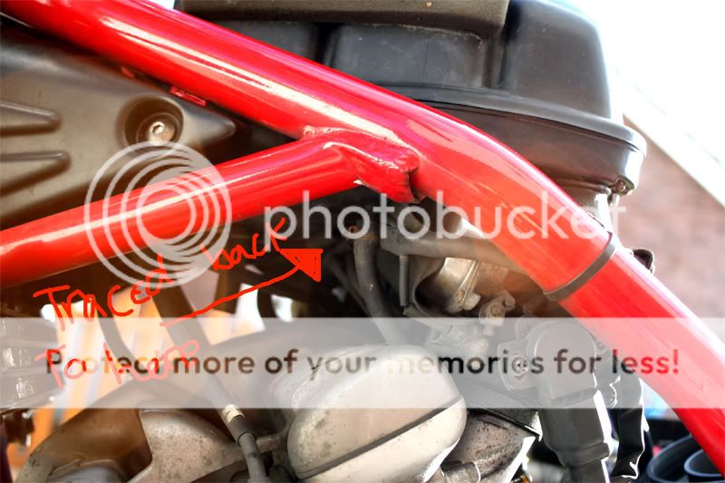

First of all I traced the pipe back up to the airbox.

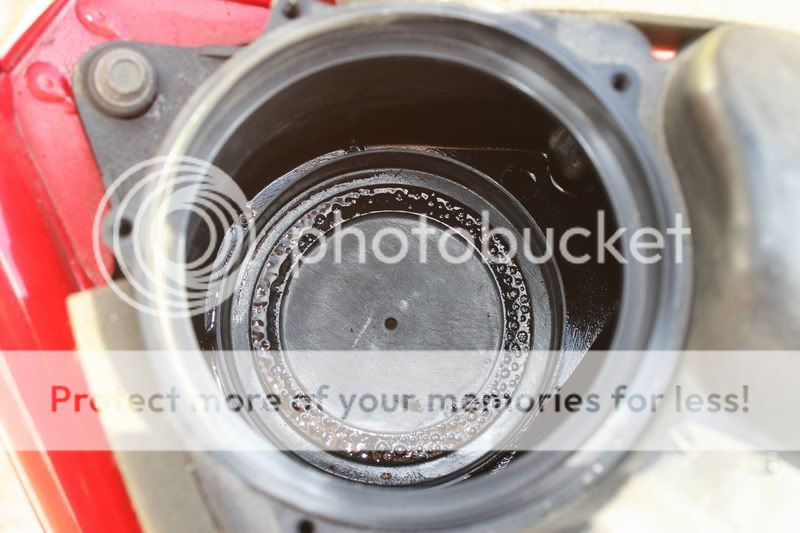

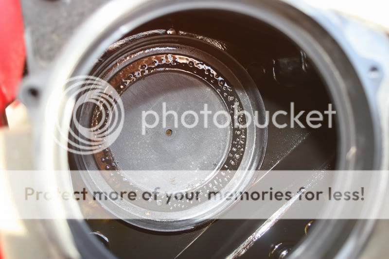

Bit of oil in there, all of the shininess is oil Sad
https://img.photobucket.com/albums/v331/serenaur/Untitled-2.jpg
https://img.photobucket.com/albums/v331/serenaur/Untitled-3.jpg

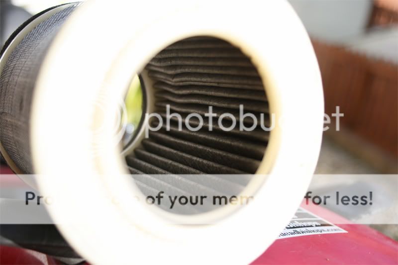

The filter looked to be ok but the foam pad at the bottom had a bit of oil in it.

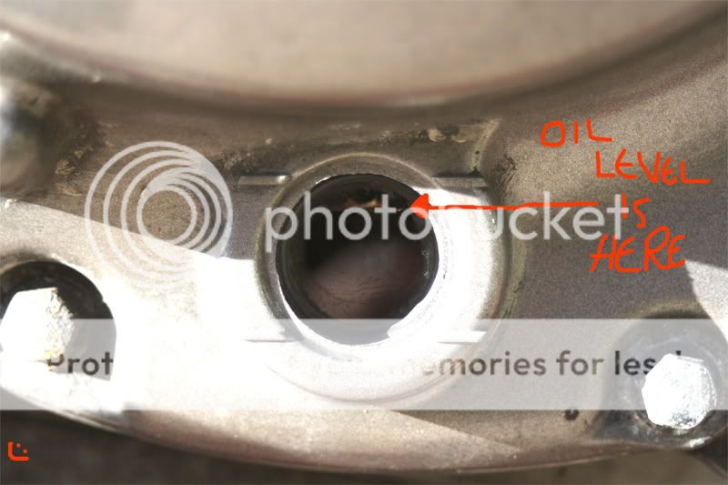

This is what the oil level is.
https://img.photobucket.com/albums/v331/serenaur/Untitled-1-1.jpg
It's been higher than that in the past with no side affects.
The pipe comes down to the right hand side of the bike so it sounds like krebsy had the same problem.

um, i dont think your filter should be covered in that liquid. looks like its flooding and filling up then draining out, clean the filter up and rock the bike to try and free the float up a bit and replace and fire it up and see if it leaks again.

no dramas mate, thats kind of normal when you over fill the oil, all the pressure forces it up the engine breather and into the airbox,
nothing at all to worry about,
just clean out the air box, and filter, job done.

The only bit of the filter that had oil on it was the foam pad at the bottom, the rest of it was dry and had no oil or anything (except a few dead flies that I scraped out) in it. It's had the same filter for about 25,000 miles now so I should probably get around to changing that soon really.

looks like the filter is bent a little....might want to invest in a new one just in case that is what is effecting the problem
