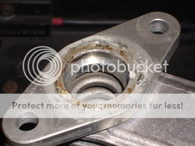

The o-rings where the radiator fits into the cooler body were indeed totally knackered. Both were hardened and misshapen. Slightly more concerning is a bit of pitting on the cooler radiator thing where the o-rings were sitting. Could this be the failure point? I guess the oil was being forced into the coolant at this point. (Thanks for the diagnosis Paddy)
https://i221.photobucket.com/albums/dd227/serendipity_uk/CBR600FR/IMGP4124a.jpg
Is it worth trying to fill the pitting with Araldite or epoxy putty? Or would it be safer to just buy a new part? New o-rings are already on order and I really don’t fancy having this fail again.

I would say you could get a shop to machine about 1/4 a mm of both
ends and it would do the trick.
Paddy.

I'd second the machine shop suggestion. If you can't find someone to do the work for you, then you might get Araldite/epoxy to work. You will need to degrease to the n'th degree to get it to stick however. Lots of heat and solvent before the sticky stuff. A small butane torch would be good as it will burn out the oil but not be hot enough to risk melting the ali.

I would glue/tape a couple of sheets of 280-grit wet & dry to a flat surface and lap those marks out using WD40 as a lubricant. Should take less than 10 minutes.

PostPosted: 16:28 - 11 Nov 2007    Post subject: Reply with quote
Be sure there is enough space for the dowels that fit into it.
