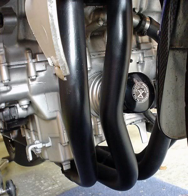

To begin with, I'll concentrate a little on the bike's chassis components: This involves saturating the frame/swingarm/shock areas/forks/etc with a degreaser (oil based seems to work best for me in this instance). I'll work on the bodywork/paintwork later, as this requires a much gentler approach. Generally, I'd use WD40, which is very good at shifting most flung-on road crap and can be left to eat into the grime whilst you prepare for the next stage. However, really soiled areas (chain, lhs of the rear wheel, etc), usually gets treated to a dowsing of parrafin, agitated with a brush. I've recently applied this using a squirty-bottle, which is easier to apply, and once saturated, most of the much would just run off without intervention. Pay attention not to get this near your tyres or brakes though, and put some newspaper down if working in a previously-clean area (or driveway where the oil can eat into the tarmac). ALSO REMEMBER TO RELUBE ANY NECESSARY AREAS ONCE YOU'VE FINISHED (after the clean that is).
I'd then rinse the entire bike. This will wash away the degreaser as well as soften built up road crud on bodywork panels. I'm not sure whether the hose pipe ban is still in force here, so tend to use a watering can with clean, cold water (warm water will accelerate salt eating away at your bike's finish in winter, so is best avoided). Once soaked, it's now time to wash the bike.

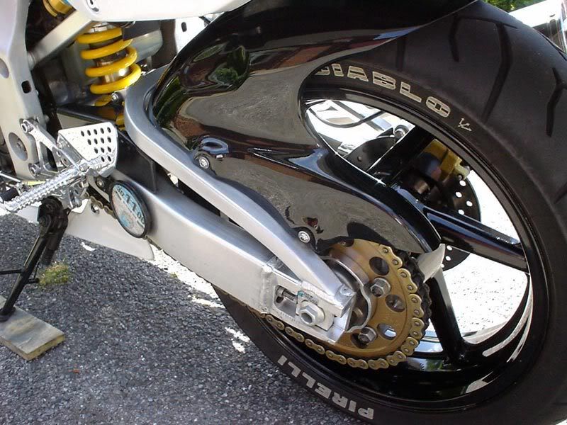

Wheels, once washed, can be treated in much the same way. I find that a layer of WD40 or Silcolene spray makes them even easier to clean next time around. And after a dry day, chain lube and brake dust can be simply wiped off. Mr Sheene can be used here as well, for uber gloss wheels.
https://i3.photobucket.com/albums/y51/whers84/Cleaning/cleanblade.jpg
I am also looking into paintwork detailing - my NC30 doesn't require it, having brand new paintwork and all, but I'm sure I'll be practicing on my R6 when I have the time. I'll be sure to post up my findings on the correct lubricants to use when claying, which drill attachments to use when levelling paint layers, etc when I do.

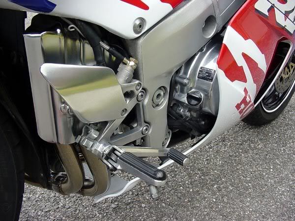

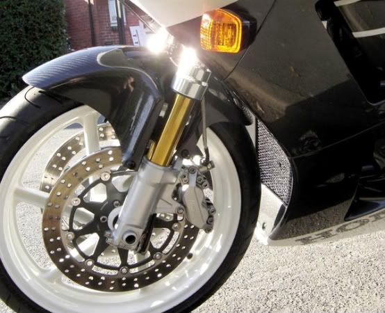

Metalwork
As with paintwork, the trick to good looking metal work is all in the preperation. This is delving into a more long-term clean, rather than the weekly routine previously discussed, but there's no reason why this can't be done at the weekend when you see fit.
I wouldn't recomend polishing if you want to keep your bike looking standard. Afterall, polishing, in the same way as paintwork, involves an abrasive that either takes away oxidisation to produce a decent shine, or removes the OE finish, depending on what area you're intending to work on.
My R6 is another good example in this light - the only area I actually polish on it is the Akrapovic link pipe. The other areas such as the footpegs, levers, bolts, etc, I have been careful to retain their factory finish, and have only washed/WD40'd them as mentioned in the stages above. Polishing metal isn't too fashionable these days so should be considered with some caution - you may be inadvertently degreasing the value of your bike by doing so, especially as it's not to everyone's tastes. But anyway...
Maybe it's best to start from the beginning, so I'm going to explain a little restoration work here, which needn't come into the equation of weekly cleaning. However, once done (if you need to do it), the metal would be so much easier to keep clean in future - the grime will literally rinse off as explained above. When I first took ownership of my Konica rep, the exhaust pipes were in such dire condition I almost thought about replacing them there and then. However, with a little patience, they came up pretty well. They were beyond degreasing as years' worth of grime had been baked upon them, so I got a bit brutal with some 'borrowed' oven cleaner. Be careful if you intend on using this with items still attached to your bike, as it can eat away at aluminium if left long enough. This is also an irritant to skin, so I recomend you wear gloves. I won't explain the whole process here (as I'll be repeating myself for later stages), but I intiated this course by liberally spraying the offending metal and scrubbing away at it with a metal brush followed by a brillo pad. This scrubbed away the worst of the corrosion, finally leaving silver metal beneath, ready for the further, finishing stages.
There were areas of my NC30 where I wanted to restore a brushed finished. Firstly, I made sure the area was as clean as I could get it (degreased and then washed), before scrubbing lightly with a brillo pad - making sure all the strokes were following the same direction. A fine grade of wet and dry can also be used to the same result. Finish with a wipe with a clean rag and a bit of WD40. Be warned that in these instances, the metal is left unprotected. If you're using your bike reguarly, I recomend a light dusting of laquer - this will take the sheene off the satin finish somewhat, but you needn't worry about oxidisation/corrosion so much after this.
https://i3.photobucket.com/albums/y51/whers84/Cleaning/cleanmetal.jpg
https://i3.photobucket.com/albums/y51/whers84/DSC00612.jpg
For uncoated surfaces (polished frame, rearsets, exhaust hangers, levers, etc) Once dry, use a seperate cloth (household dusters are good) and polish firstly with Autosol - keep buffing until the marks eventually rub out (it actually skims out imperfections in the metal, which is mixed with the dirt - that's what you see on your cloth). A lot of people add a bit, rub in until it goes dark grey and then immediately buff away. I don't do this. When the surface goes dark grey - I keep buffing with the dirtying cloth until the shine comes through from under. Don't use too much pressure, the key here is to let the polish do the work. Buff away with another cleaner cloth. For a better, finer finish, use a bit of Belgom Alu in the same way, adpoting a wax-on, wax off technique.
For mirror finish you may want to invest in some polishing mops.(WARNING! THIS IS PERMENANT AND MAY COMPROMISE THE VALUE OF YOUR BIKE) However, I don't like the lack of control they give, so tend to resort to a more hands-on approach. So I use wet'n'dry. The original finish depends entirely on what grade to start with and the key to a good end result is all in the preperation, and a lot of patience. Original finish - 240 grit; quite a bit of hard work at this stage, but it gets easier (relatively) when moving up the grades. Remove all surrounding bodywork/obstructions, fill a bucket of water, apply a tiny amount of washing up liquid, tear a hand sized patch of wet'n'dry up and then sand away like you would paintwork. Keep the surface saturated as you work by constantly dunking the area/patch in and out of the water. Like any kind of polishing, the trick is to let the paper do the work - not your polishing arm, so be patient as you gently polish away the metal's imperfections as you work. Keep checking what you're doing, and that you haven't worn away the surface of the wet and dry instead of the metal you're working on - you can actually hear whether you need a new patch or that you need to move up a grade (the surface will go quiet/smoother to work with once ready for either). Anyway, gradually move up the grit levels - the key is to be patient - it will take a while. Miss a spot and leave a deep(ish) scratch in your metal work and it will show in the levels thereafter, so be careful not to just hack away in the first stages. Once you've moved up the 240-500-800-1000-1200-1500 grit stages and most sratches have been polished away (along with the original finish) dry thoroughly and then apply some Autosol to a cloth. Then Belgom Alu with a seperate cloth, buff to a mirror shine. Another key thing to note here, obessive as it may sound (and probably is), is that the cloth you use will have an impact on the final result. Use something quite coarse and it'll mark your metal work with thousands of tiny, but noticeable scratch marks (especially aluminium, which is quite soft), I recomend Autoglym's Perfect Polishing Cloths as a handy finisher at this stage. Given time, your metal work should come up like chrome. Be warned though, it will be unprotected from the elements and will require regular 'top up' polishing at this level.
https://i3.photobucket.com/albums/y51/whers84/cbrpolish.jpg
https://i3.photobucket.com/albums/y51/whers84/rvfpolish.jpg
Chains
There are a few techniques; some people just rely on their Scotoiler to do all the work. That's not good enough for me. Liberally apply a degreaser - Parrafin again - to your chain. You want to absolutely drench the thing in the stuff so all the muck, grit, road kill, etc just rinses out (make sure you cover the floor on which you're working, this stuff will get everywhere). Keep rotating the chain to work around all areas - do the hub, the inside of the front sprocket cover (check the speedo cable whilst you're at it) - Everywhere. Once degreased, whipe off with a rag until dry, pay attention to cleaning the inside and outside of the chain for extra bling. Then apply a good coating of Chainsaw Lubricant (I've found this much better than oil and spray chain waxes (which go into a sticky, gungey (and sometimes green!) mess after a couple of weeks of use). Pour a little lubricant into a cap, and wipe in with a cloth, working into the o-rings whilst moveing the chain around. Wipe off the excess to reveal a non-fling, spotless, wet-looking chain. Good as new.
https://i3.photobucket.com/albums/y51/whers84/Cleaning/cleanchain.jpg

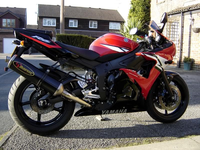

And the results? They will speak for themselves.
https://i3.photobucket.com/albums/y51/whers84/Cleaning/cleanvfr.jpg
https://i3.photobucket.com/albums/y51/whers84/Cleaning/cleanrvf-1.jpg
https://i3.photobucket.com/albums/y51/whers84/DSC00289.jpg
https://i3.photobucket.com/albums/y51/whers84/rvf.jpg
https://i3.photobucket.com/albums/y51/whers84/DSC00606.jpg
