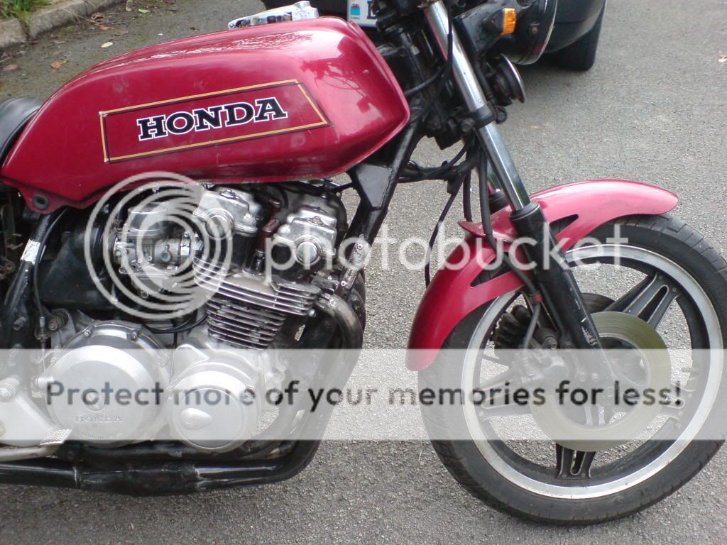

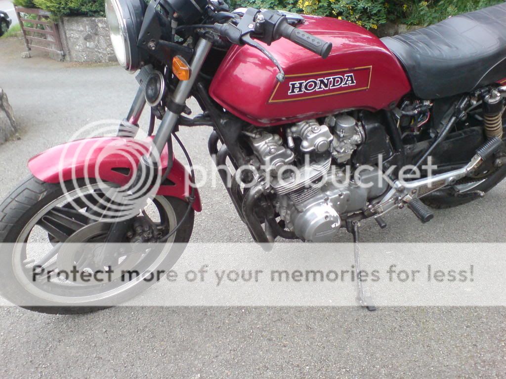

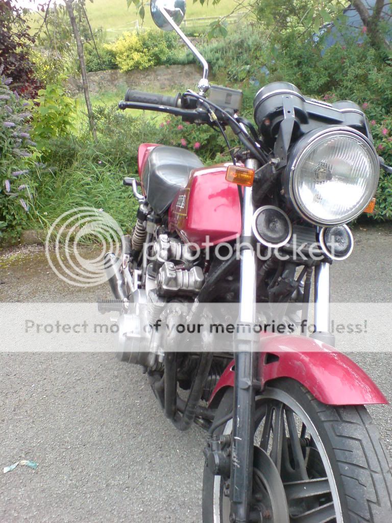

Got some pics of the new bike today, its a honda cb750 bought off another BCF'R , it needs a little bit of work but nothing to major.
A bit of info from who I bought it off :
"The primary drive chain rattles at low tick over but is ok at around 1300 rpm."
"The tyres are fine but I think there might be something wrong with the rear valve as it looses pressure slowly"
"The rear shocks are dead although it passed the mot like this"
"The exhaust is a 4 into 1 Micron system loud enough to rattle fillings loose, and with an over run pop and bang that will make you weep with joy"
^^ Very true ,it sounds so nice !^^ Cool Cool
"I fitted new fork seals, sorted the rear brake, oil and filter change, air filter change, plugs, HT leads, fork oil, and new bars, repaired the right hand switch gear, fitted mirrors and took it through its mot with flying colours"
"The clutch was heavy and last month I found out why,
Although the previous owner looks to have replaced the clutch and gasket it looks like they forgot the springs 5 of which are 3mm too long, and 1 is 5 mm too long, the clutch still works but as I say, its very heavy because of this"
So all in all its a nice little project for me to do over the winter.

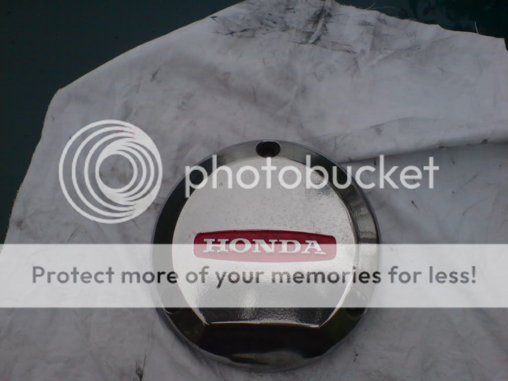

Well, since the picture was take(of mine) the engine has been cylinder blacked, the old paint stripped off the frame and I have put 2 coats of new gloss black paint on.
I plan to buy 2 new/used side panels and spray them to match the tank/seat cowl ect.
Sort the indys out as they don't work.
Mirror polish the clutch cover and the stator cover.

Before :
https://i155.photobucket.com/albums/s297/honda_tlr/DSC00564.jpg
After:
https://i155.photobucket.com/albums/s297/honda_tlr/DSC00568.jpg

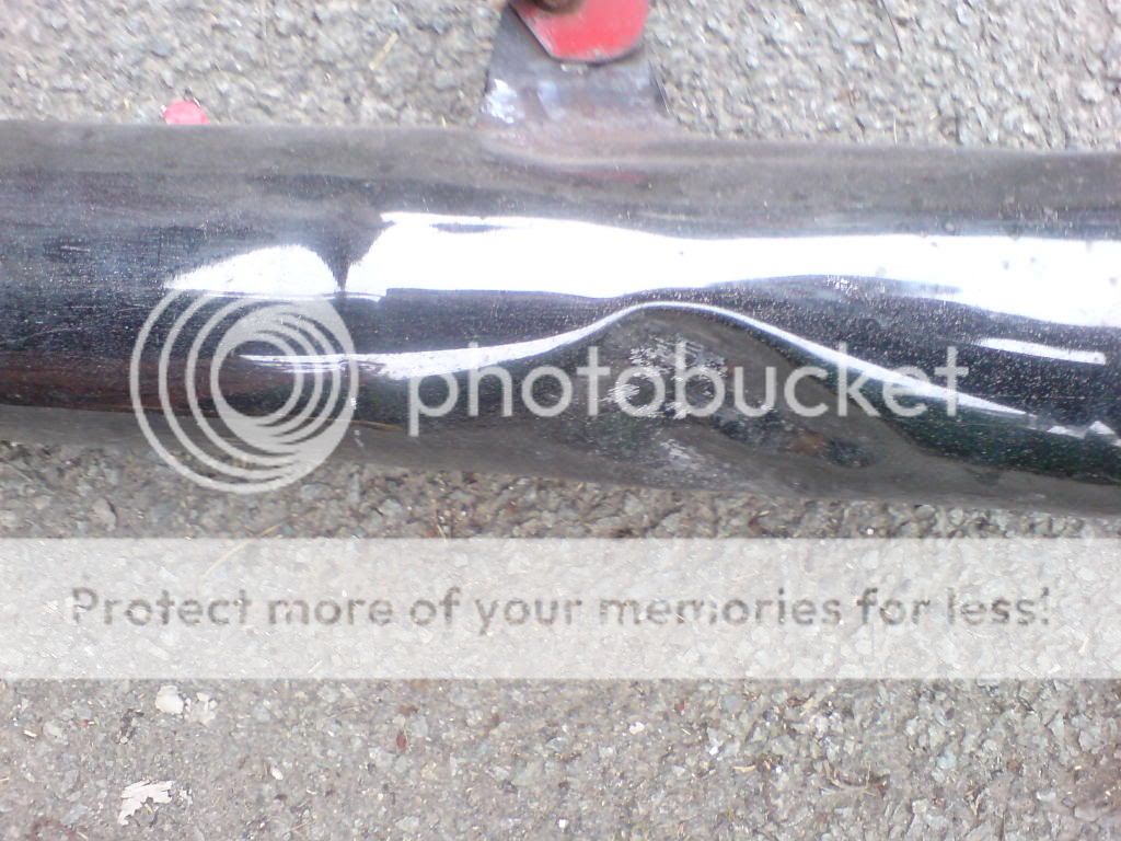

It just a shame the micron can has a big dent in it other wise I could of sold that and had a bit more money to put towards the standard one. Sad
Unless the dint can be gotten out ?

Doubt you will be able to get that dent out mate, though you may still get a bit on ebay for it.
