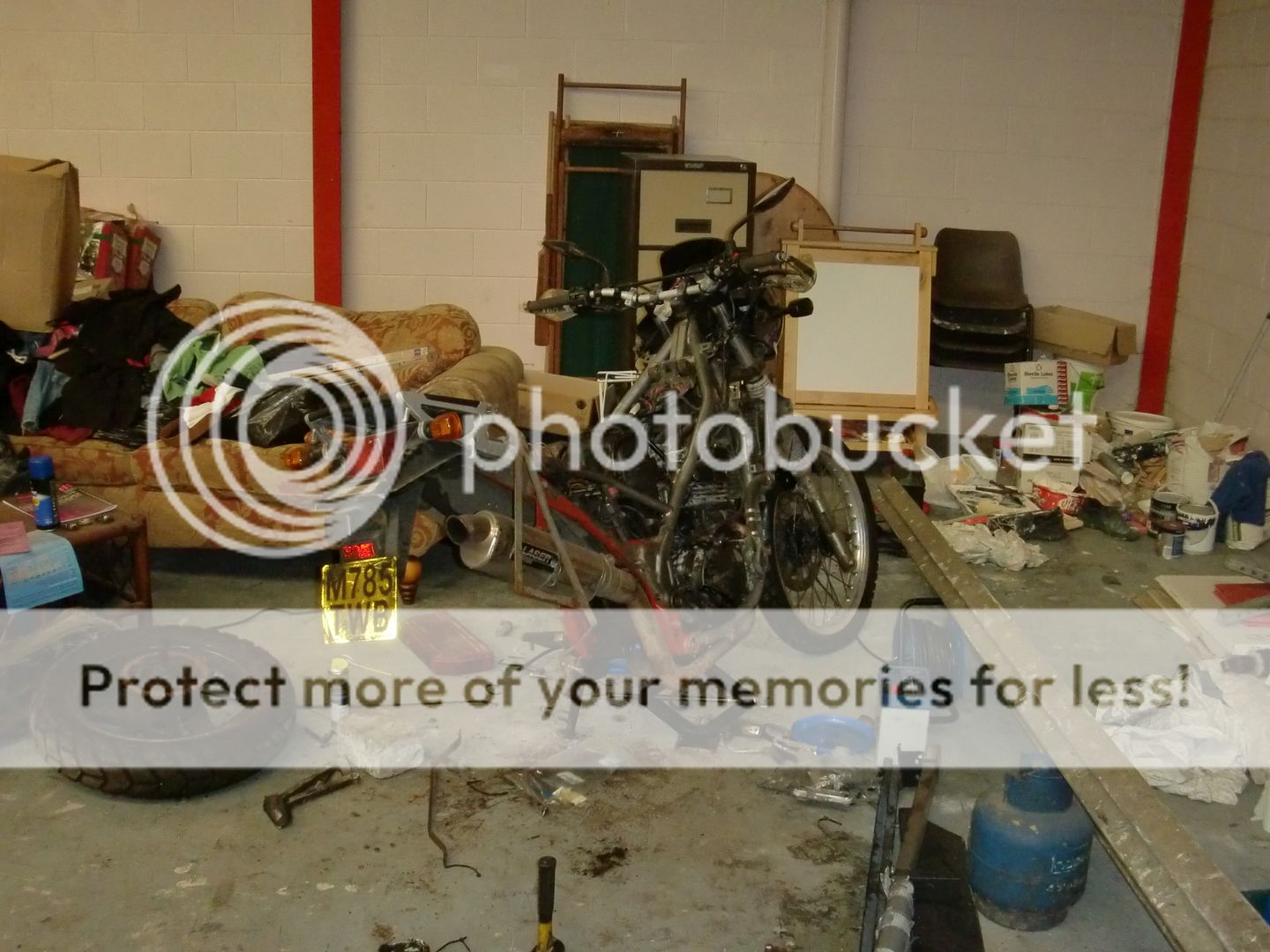

I haven't taken pictures from the start of this, didn't think to.
I've had this bike for years. I'd done a 17" wheel conversion and it has a GPZ500 engine in it.
Got a new bike and put the KLE in the garage then when I pulled it out a few months later to MOT and sell it, found the tank had sprung a pinhole leak and made the plastics go all melty. Shoved it back in the lockup, where it's stayed for the last 5 or 6 years.
I dragged it out of the corner a week or so ago and set about it. It was in a fairly advanced state of yakkiness. I've decided I'll try to get it back on the road in time for the rat and survival show at the end of May. I don't want to spend a fortune on it but I'm prepared to give it some of my time.
https://i48.photobucket.com/albums/f216/stinkwheel/kle500/CIMG0446.jpg
First step was to see if it's still a runner, otherwise, what's the point?

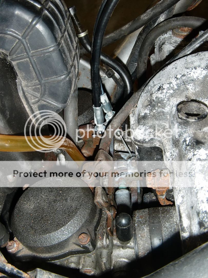

So first problem was no throttle movement. Stripped it down as far as the carbs and found the close cable broken, the open one was moving so it was a seized throttle linkage. Pulled the carbs off, split them, cleaned and lubed the linkage then refitted them.
Used one of my spare fuel tanks off another bike to jury rigg a petrol suply and hooked it up to the van battery. I cranked it over wth no fuel for about 30 seconds to get the oil round it then fed it some gas. Fired up on one after a couple of seconds and the other followed. We have a project!
Shock and swingarm were very minging so I stripped the back end out.

New throttle cables. I'll keep the old "open" as a spare.
https://i48.photobucket.com/albums/f216/stinkwheel/kle500/CIMG0443.jpg

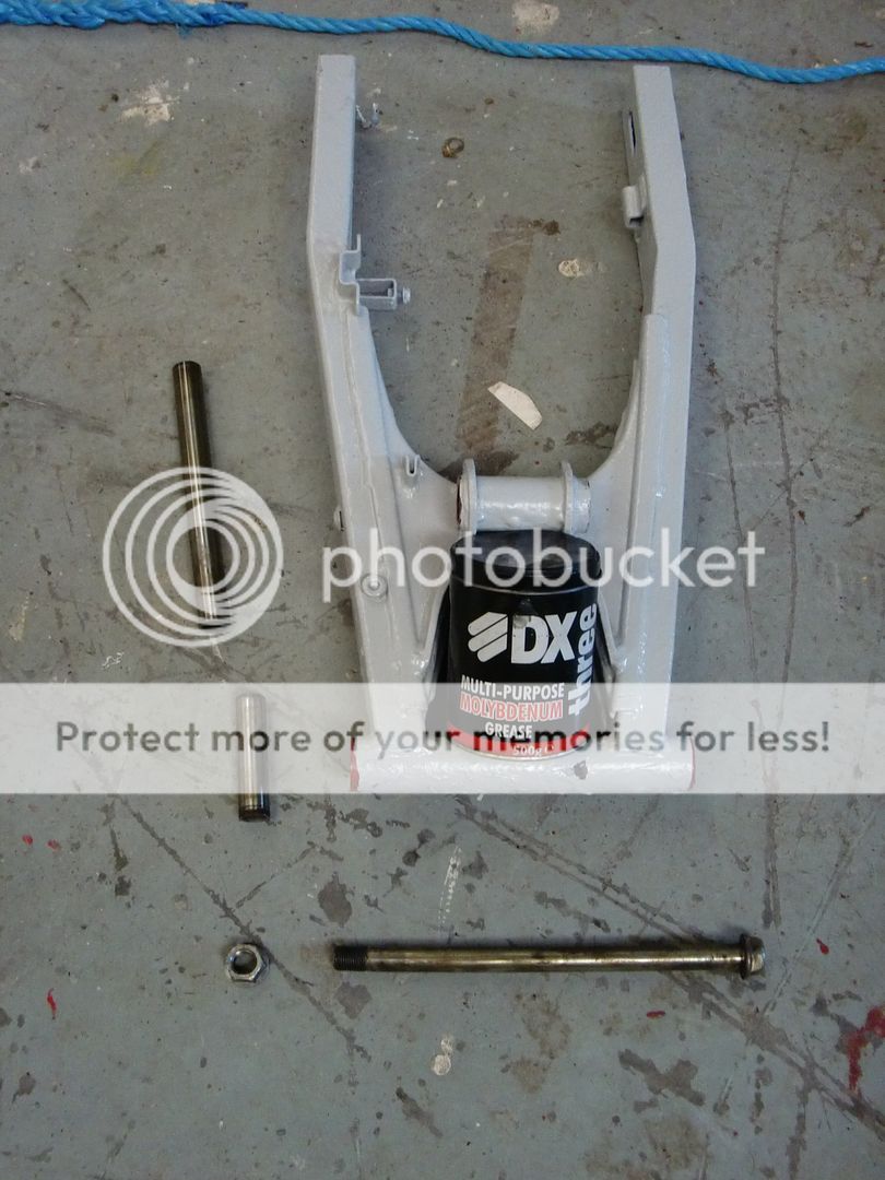

Stripped all the paint off the swimgarm and primed it. I'm going to do it with stonechip coating then gunmetal paint to match in with the frame.

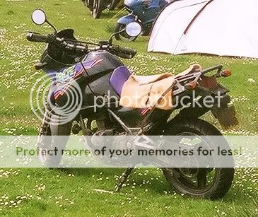

PostPosted: 09:18 - 23 Apr 2016    Post subject: Reply with quote
stevo as b4 wrote:
Cool!
I like the sound of a stripped down lighter KLE with the GPZ engine, 17'' wheels and some kilos lost. I think it would make a good budget twin cylinder Street moto with such work.
The idea was good, the ride-height wasn't so good, it had a tendancy to ding the belly-pan if you cranked it over on the brakes.
It really needed some 2" over standard fork stanchions but I wasn't out for spending the money having some made and still can't bring myself to trust slugged forks.
It did also get a highly unpleasant speed-wobble once on the M6 while nearly flat-out that seemed to go on forever. Backing off made it worse, powering on made it worse so I just had to hang on and hope it settled down before I ran into the back of something.
Two years after, kawasaki brought out the versys. Rolling Eyes I still maintain they copied me.

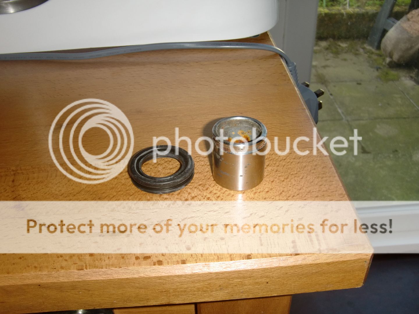

Brake callipers.
One hell of a mess. I had to hook them up to a master cylinder and bleed them to get the pistons out. Compressed air wasn't touching them.
After I got the pistons and old seals out I did them with paint remover to take the remnants of the paint off.

Lube the roller bearings and sleeves in the swingarm with moly grease (these were masked up for the painting).
https://i48.photobucket.com/albums/f216/stinkwheel/kle500/CIMG0520.jpg

FINALLY got a correct size seal for my rear calliper. Wemoto listed them by size and they turned out to be OE kawasaki parts when they arrived. Odd setup, they have a dust boot rather than a dust seal. The boot covers the whole piston sitting in the calliper where the normal dist seal does and in the groove in the top of the piston. Keeps crap off the piston but they are a sonabitch to fit.
https://i48.photobucket.com/albums/f216/stinkwheel/kle500/CIMG0594.jpg
Having fitted the main seal, you need to put the boot seal over the piston, leave it hanging off the bottom then gently work the bottom part of the seal into the groove in the calliper. A bit like fitting a tight bicycle tyre but in reverse.
https://i48.photobucket.com/albums/f216/stinkwheel/kle500/CIMG0596.jpg
Once that lip is in the croove, you can go ahead and push the piston in in the normal way. When it hits the bottom, the boot will pop into the groove in the piston.
How most car caliper seals are set up, and a few bikes. Common on the older Brembo calipers, and also used on the Grimeca 4 pot calipers used on various Italian 125 2 strokes and the like. Far better at stopping the brakes seizing up that the normal basic dust seal.
