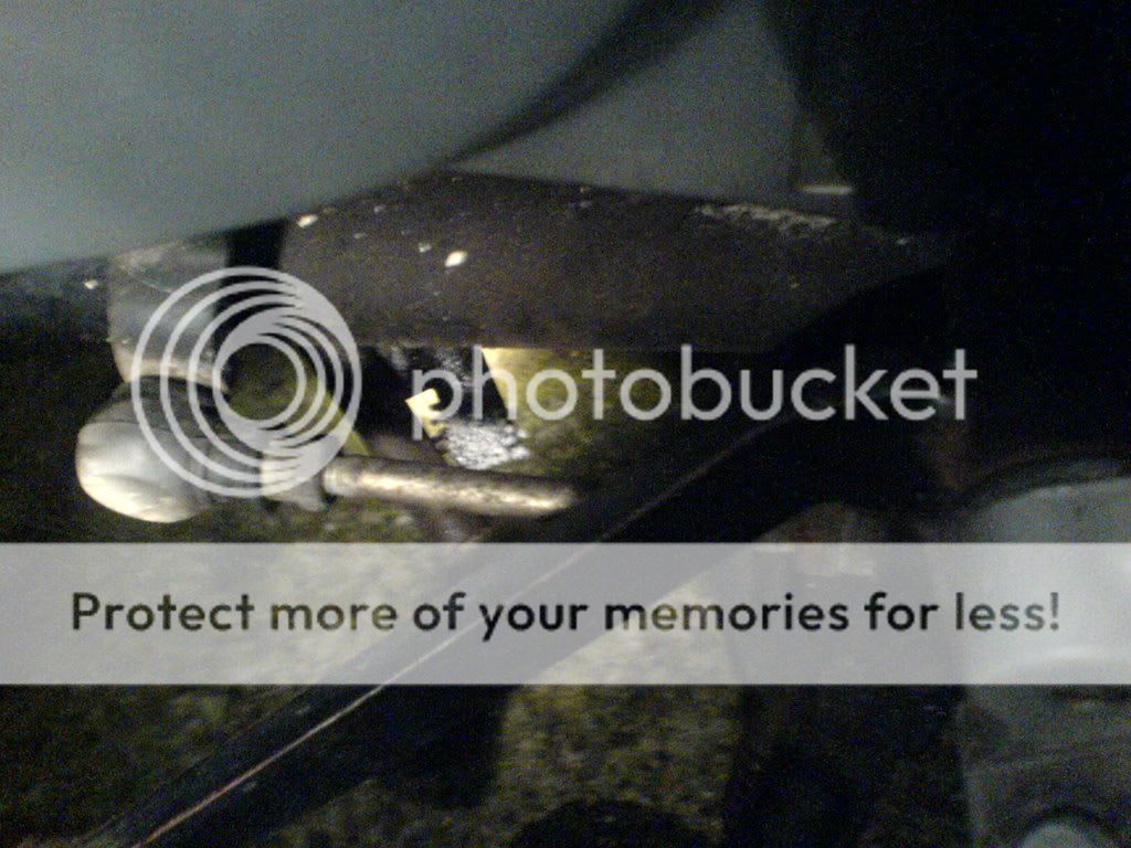

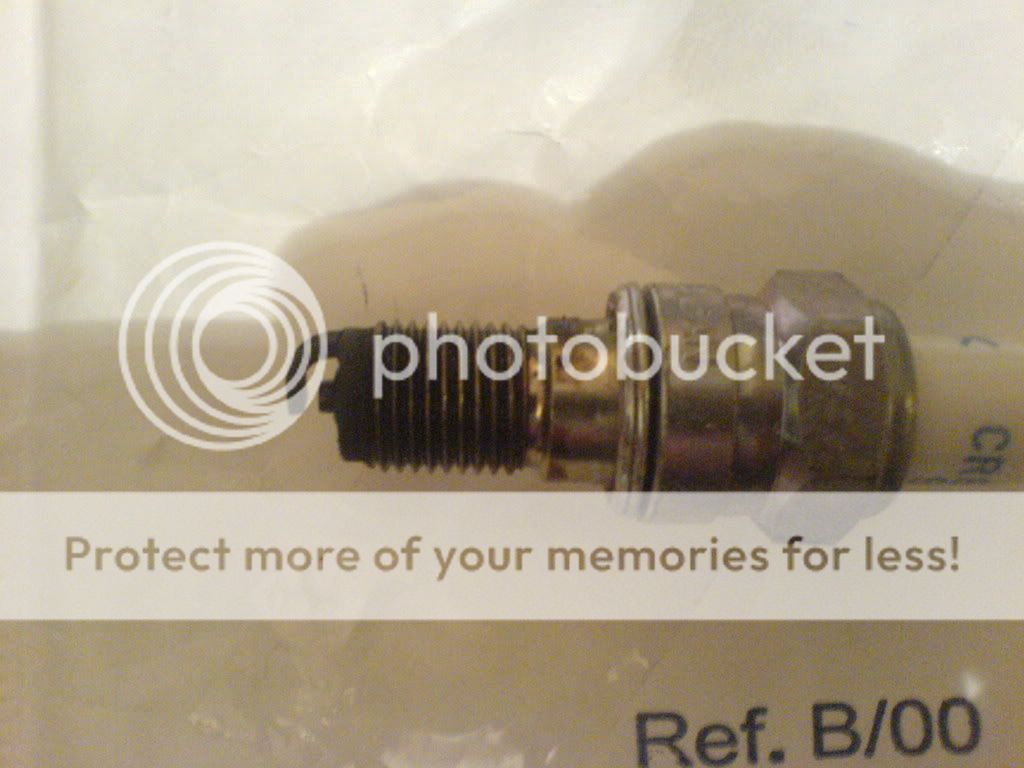

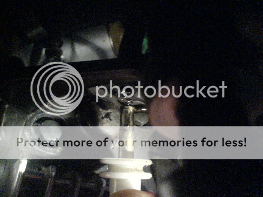

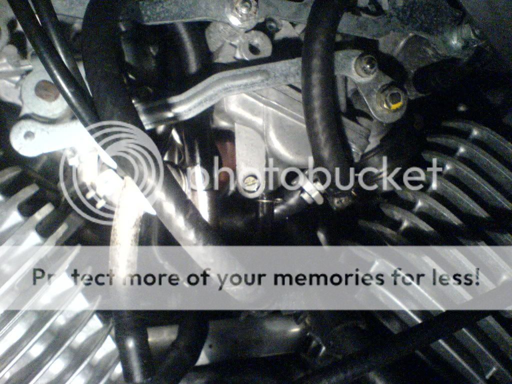

Here's some pics. The screws I turned are the flat head screws, pretty much in the centre of the pics.
The broken idle screw is the one in my fingers.
Thanks in advance.

2. Screw on left side of carb:
https://i150.photobucket.com/albums/s85/scottishcammy/DSC00140.jpg
3. Screw on right side of carb:
https://i150.photobucket.com/albums/s85/scottishcammy/DSC00141.jpg
4. Pipe where all the fuel pissed out (what is all that white crap?!:
https://i150.photobucket.com/albums/s85/scottishcammy/DSC00143.jpg

The screw underneath your carburetor (middle of 2nd last picture) is the DRAIN plug. Nothing to do with adjusting your carburetor. By unscrewing it (anti-clockwise), you have opened the plug and allowed fuel to drain out of your carburetor. Turn it back (clockwise) until it just nips up. DO NOT FORCE IT. The absence of leaking fuel is the signal that the drain plug is closed.
I am not sure what to suggest about your other screws, which appear to be loose. Find a manual for your bike, online or in the real world. Do not try any repairs if you do not know what you are doing, as you could cause more serious damage.
