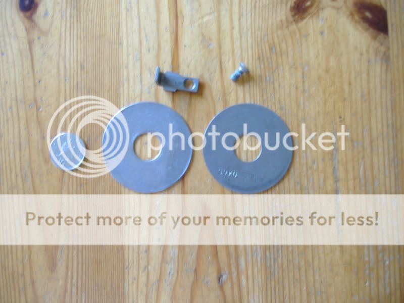

As you may know my bike was derestricted last friday. From 33bhp to 119 odd. Didn't really get a chance to properly see what it could do on the way back. It was rush hour. Sad
https://i66.photobucket.com/albums/h267/Big_Ham/2008_0917Image0014.jpg
This is what the restrictor kit looked like. Note 10p for scale on the washers. The L shaped piece of metal screws into the side of the throttle bodies and prevents the throttle from opening fully. It stopped the throttle at around 15-20% open!
Here's the video of it on the dyno. Standard except the Aprilia Titanium Racing can and the PCIII USB. The dip at 4k is because the can needs repacking. Gained a fair amount through the midrange. It did a couple of 120+ runs and a few <118 runs too.
