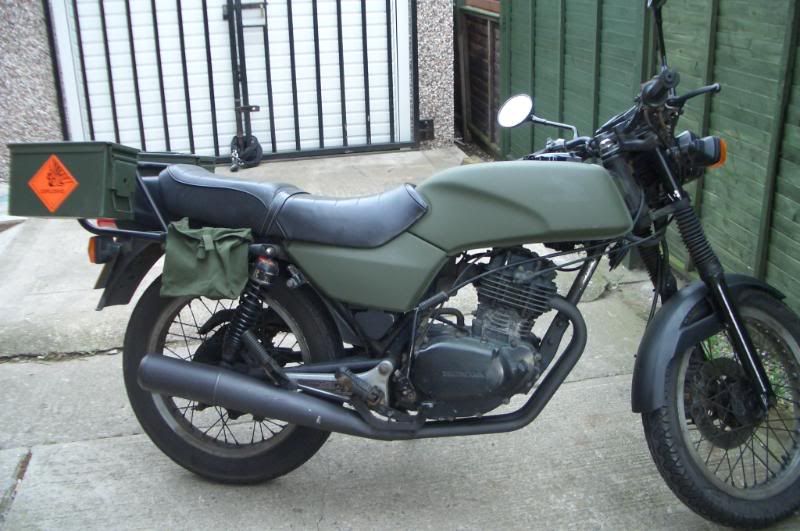

Well I did most of the respraying today, only had 2 and a half hours of garage time so had to get a shimmy on!!
Took a full hour Shocked to sand back the tank. Thing is, the black had been flaking off in places, since I hadn't rubbed the blue enough to key properly originally Rolling Eyes Embarassed So I decided I had to take all the black off, and properly key the blue ready for the Nato green.
Used 240 grit damp wet n dry, was exhausted by the end!! Morale of the story - there is lazy, and then there is so lazy that you end up making extra work for yourself... Laughing
Here's the tank back to blue!! Shocked
https://img.photobucket.com/albums/v246/super_jo/phase3001.jpg
No time to waste, a good thick coat of Nato Green 285...
https://img.photobucket.com/albums/v246/super_jo/phase3002.jpg
Put a spurt on as was running out of time, rubbed the side panels and got them sprayed:
https://img.photobucket.com/albums/v246/super_jo/phase3003.jpg
Pics are a bit wank, if it doesn't snow tomorrow then I'll put everything back together and take some proper ones.
Will try to do the mudguard too, might keep the tail panel black for now as it doesnt really get seen anyway. Kept the seat off to investigate whether I can chop any height out of it easily.

All back together...and green!
https://img.photobucket.com/albums/v246/super_jo/phase3004.jpg
https://img.photobucket.com/albums/v246/super_jo/phase3005.jpg
https://img.photobucket.com/albums/v246/super_jo/phase3006.jpg
https://img.photobucket.com/albums/v246/super_jo/phase3007.jpg
Frame/engine etc is covered in flecks of blue paint dust sludge Mad so I may...have...to wash it!! Shocked only a bit tho. Razz
Needs another coat on the green and a squirt more VHT on the exhaust (I scraped it parking it secure at my mates over the weekend Rolling Eyes )
Seat is looking far too shiny leather black now, may have to do something to remedy that. Not sure what yet.
Otherwise I am fairly happy! Good bloody job as it is off to it's first rally Thursday. Thumbs Up Cool
