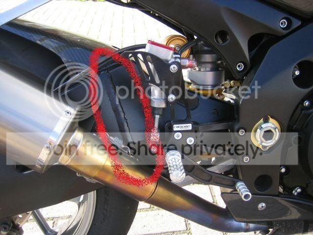

this is a 20 grand gixxer that's on eBay. is that a crack or a shadow?
https://img.photobucket.com/albums/v707/lllN30lll/cb2d_4.jpg

shadow
PostPosted: 12:18 - 25 Mar 2008    Post subject: Reply with quote
90% likely a shadow.
Seems wider at the top and I would expect a crack there to be wider at the bottom (with the weigth of the bike acting through the swinging arm).

Isn't it a weld?

Perry wrote:
Isn't it a weld?
Check the dark line just to the right of the weld.

If you look where the weld continues at the bottom, just behind the exhaust, out of the sunlight, there's no sign of a crack.
This combined with the fact that if it was a crack then that part wouldn't be photographed leads me to believe it's a shadow.

Surely it would crack from the bottom up? Like "^" rather than "V"

Weld Shadow Thumbs Up

Shadow.

Shadow.
