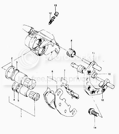

This is what I think is what it should be like.
The bottom pad needs to slide down in the direction of the red arrows, but the pad seems to be too wide for the 2 blocks/guides on either side (circled in green).
I tried reattaching it to the bike, but it didn't exactly slide on.
Is that right? Does it just need bleeding and then pumping the brake a bit until the pad is forced into place?

youve got them in the right place/position but the smaller pad closest to the pistons doesnt look like its sitting down on the pistons?
https://i38.photobucket.com/albums/e141/T1z3R/gs500/piezas26.jpg

Cheers for the image T1z3R
It's not sitting on the pistons because it can't. The number 10's on that picture (one is circled in green on my photo) are just slightly too close together it seems, so the pad doesn't sit snugly between them. If you can see on my diagram, there is a little metal clip that sticks out just a notch below the brake pad on either side. It seems to suggest that the pad should sit on top of those notches.
I was going to keep them in the same place as in the photo, attach it to the wheel/disc, then bleed the brakes and see if a bit of force would push them down. I tried the old pads and they wouldn't fit in there easily either, so it's not as if my new pads are too big. But obviously if they are not supposed to be seated like that, then I don't want to force them into breaking.

i see what you mean.
ive stripped my GS caliper a number of times and never had the same problem. is that the metal clip thats been attached to the caliper which is circled in green in your first pic?
i have no such clip on mine but it looks as though it should be there from the parts fiche. it looks as though it should compress to allow the pad to almost clip into place.
edit : ive just checked the sevice manual and those are spring clips and are meant to be there (maybe i should find some for mine then Confused ) so the pad should be pressed into them to locate.

Yeah, I tried pushing really hard, but just can't get them to click.
That's why I thought about reattaching it all to the disc, then using the brake to see if the force would pop it into place.
Could you maybe do me one favour? When I was looking at how I thought it worked I couldn't figure it out.
On your diagram, the big pad is 'attached' to the horse shoe shaped piece of metal (#11) by sliding over the 2 thick rods. If the small pad clips in between the metal clips, then surely which ever way the horseshoe piece of metal moves, both clips will move with it?
Could you see which way the horse shoe piece of metal moves? (you could test it by seeing which way those 2 rods move. I still can't picture how it works if both the pads are supposed to close in on each other.
The only thing I could think of was if piece #11 moved left and the pistons push to the right, then the pads will close together. But by having the smaller pad clipped into piece #11, I don't see how it will move in one direction whilst the thing it is seated in moves the other way?
Unless the pad doesn't actually clip in between those 2 bits of metal, but rather slides up and down between them?!

did you get your pads from wemoto?? i had the same mine, i ended up whipping out my trusty file, and giving the edge of the metal part of the pad a good file Very Happy
Yup - the cheapest ones too Laughing
Looks like it might be a filing jobbie then. Cheers for the heads up! Would make it easier (although still leave me wondering how the feck the whole braking mechanism worked hehe)

Update:
I gave the pads a file at the edges (where they sit between the guides) and they slotted in nicely.
I now have working brakes after bleeding them.
Only problem is that they seem to be binding a bit. The disk is hot after riding and it sort of feels like I can feel the resistance slowing me down.
I reused the existing seals before, so I think I will order some new seals, take the pistons out and give them a hell of a good clean and scrape any crap off with some wet 'n' dry and reassemble them.
