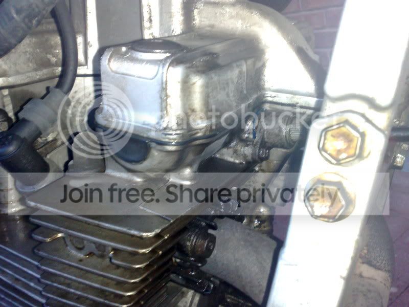

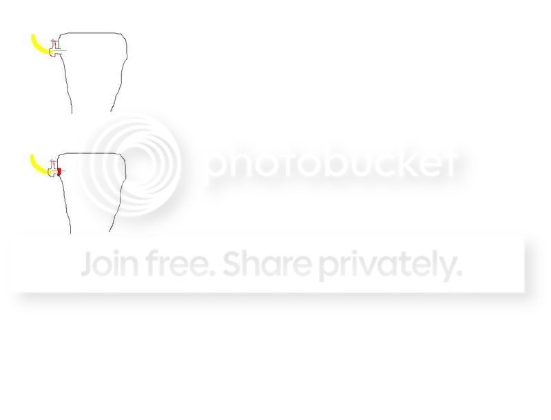

This was what I was orginally thinking, I think I'll fix it and get geninueing suzuki C&S and hope it will work. Now I just need to sort out the broken tacho drive oil leak. The collar of for thing that the tacho screws into has broke and is suck in the engine block. Here is the paint diagram.
https://img.photobucket.com/albums/v295/chris-red/untitled-7.jpg
The green is the tacho spinny thing Embarassed
Yellow is the tacho cable
Black is the engine block
Red is the peice the tacho screws into.
The first picture is how it should be, in the second the solid red represents what has broken that part has snapped off flush with the engine block and wont come out.
Here is an actual picture.

ah HA! I see blue hylomar.... some bodger has been there before... Wink
That tab thingiemagummer should have a bolt/screw holding it in place.. is that what sheared off?

My dad put that in when we could get that collar out, apparantly it the same stuff bently use instead of gaskets.
I have undone the bolt, and the thing the bolt holds in half comes out, everything you can see there comes out with the tacho cable but there is a collar that goes into the engine.

Where part 17 gets thinner it has sheared and it stuck flush in the engine.
