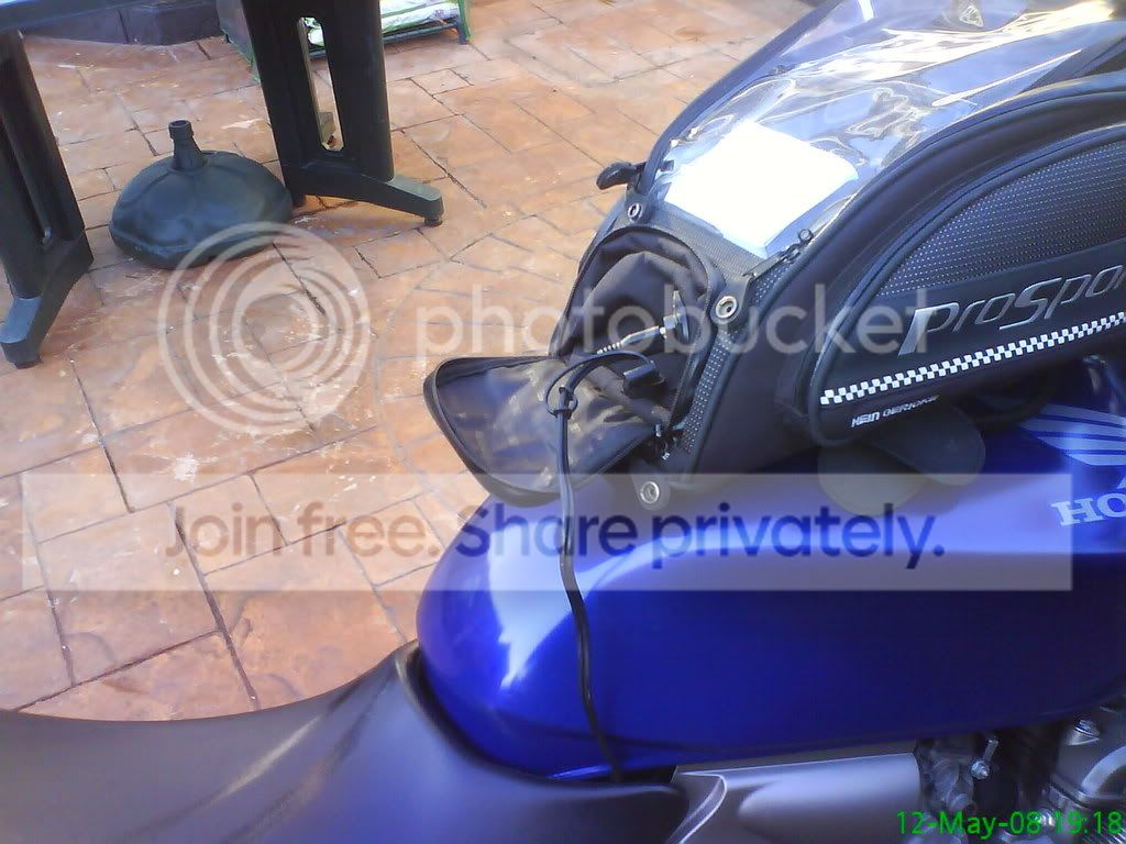

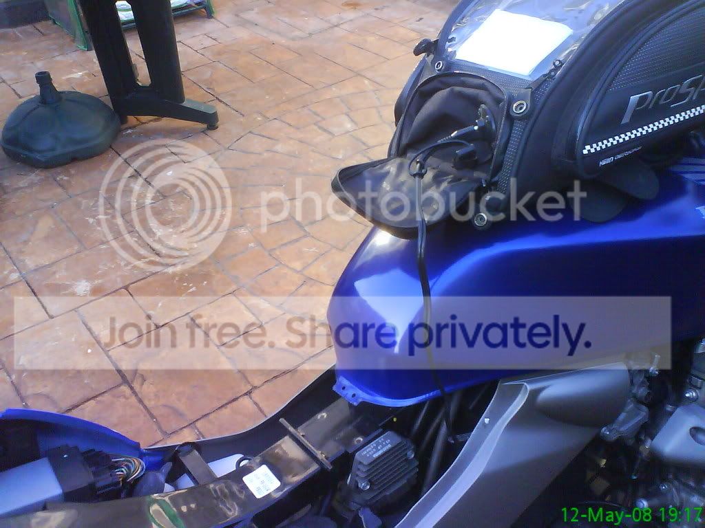

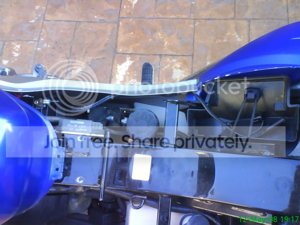

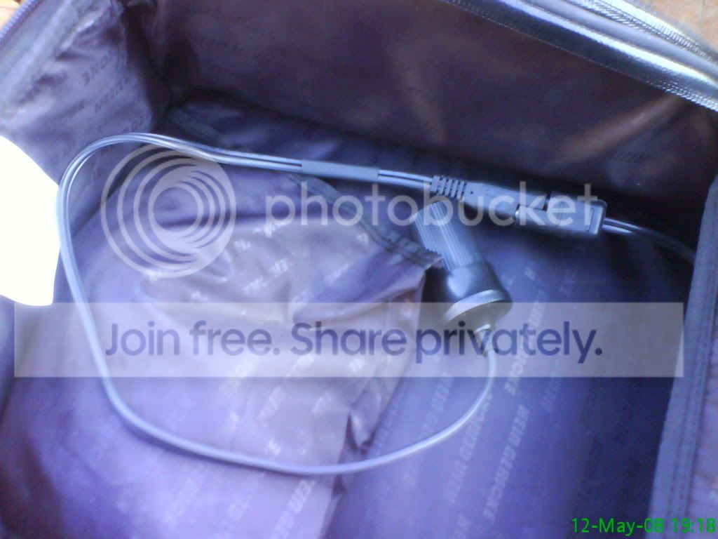

Pics below:
From under seat to tank bag
https://i302.photobucket.com/albums/nn87/deanoet/1Wiretotankbag.jpg
With seat on
https://i302.photobucket.com/albums/nn87/deanoet/2Withseaton.jpg
Inside Tank bag
https://i302.photobucket.com/albums/nn87/deanoet/3Insidetankbag.jpg
Wire tucked away under seat
https://i302.photobucket.com/albums/nn87/deanoet/4wiretuckedawayunderseat.jpg
The satnav sits in the tank bags clear front pocket

For fitting it is simple
1. Remove battery, undo terminals, put the wire onto them (red to positive, black to negative), tighten up the battery again and put it back in
2. Get a tank bag and a soldering iron and burn through the tank bag to the correct size hole for the adaptor that goes through the bag (start too small and slowly get bigger till it fits)
3. Fasten on the adaptor using the screws supplied
Sorted
Hardest bit is getting the battery out, or it was on mine as it is surrounded by wires and pipes, so had to persuade it to come out by wiggling and flexing of plastic battery holder
if you buy the kit from power let the tank adaptor coems with instructions for fitting
Took me an hour, including struggling to get battery out and back in as well as sorting the tank bag out
