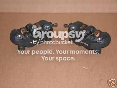

Some of you may have seen previous posts by me whinging about how toss the front brakes are on my ZX7R, so today I decided to something about it!
Just won some radial 4 pot calipers taken from a GSXR 1000 K7 on eBay. £107 for the pair with pads, and brand new, bargain. Laughing
Anyone know of any engineering companies that will make up some mounting brackets specifically for a 7R? Someone in the Staffs/Cheshire/Shrops/Derbys area would be a bonus.
https://i242.photobucket.com/albums/ff267/yellaninja/Random%20Shat/calipers.jpg
Cheers

It will be cheaper to buy the radial forks I would have thought. Laughing
Also I cant see the radial's being "that" much better.

Ha! Ive been pondering this very thing for my ZX9R, the brakes are utter utter ham shank.
I work for a small engineering company and we have come to a conclusion. Yes it can be done, but the costs outweigh the benifits greatly.
It would be far cheaper to buy the front end off another bike and bolt it on. AFAIK a zx10r front end will go on both yours and my bike with a little modification.
Tom make those calipers fit would need a whole new fork bottom to be made, the tooling and design of this alone is fooking extorsionate!
The other way around it ( the way I am taking ) Is to buy a radially mounted master cylinder, braided hoses and better calipers that bolt straight onto the origional mounting points. Im going to use some GSXR K2/3 4 pots as im told they are much better than the junk I have got fitted at the mo.
