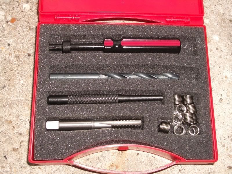

Last week I picked up a helicoil style thread repair kit from Ebay and thought I’d share how I got on.
Apart from the wire inserts themselves the kit comprises of drill to expand the hole, tap to cut the thread for the wire insert, tool to insert the wire and punch to break off the tab on the wire insert.

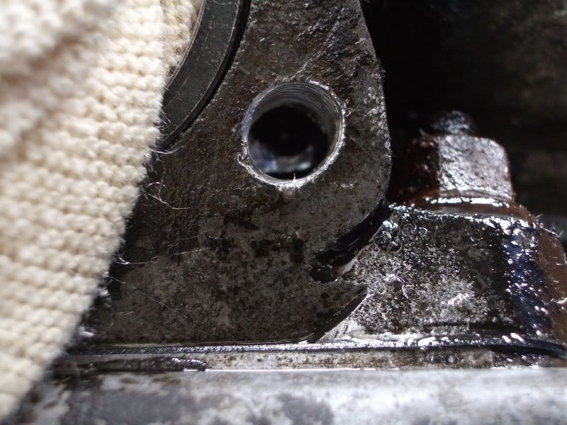

https://i221.photobucket.com/albums/dd227/serendipity_uk/RXS100/IMGP4959a.jpg
This is the hole with the messed up thread.

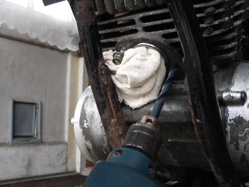

https://i221.photobucket.com/albums/dd227/serendipity_uk/RXS100/IMGP4956a.jpg
I started by drilling out the hole. Although the picture shows a full-on electric drill I quickly switched to a cordless drill/driver because it offered much more control over the speed. I’m a lazy sod and decided to fit the helicoil without putting the engine on the bench. Normally I’d recommend using a bench mounted pillar drill for accuracy, but I was taking a short cut here and it was obvious that the high speed, hand held drill was going to chew through the soft metal of the barrel in seconds. Hence the switch to the cordless driver. Yes, I know that the frame needs a lick of paint. Wink

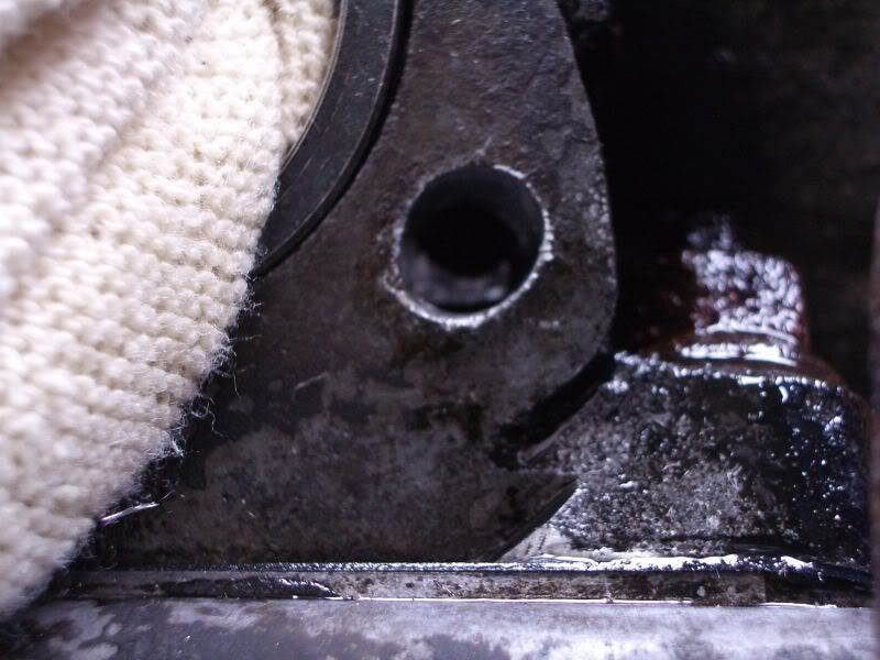

https://i221.photobucket.com/albums/dd227/serendipity_uk/RXS100/IMGP4964a.jpg
This is the resulting (slightly out of focus) hole. Not much better than when I started.

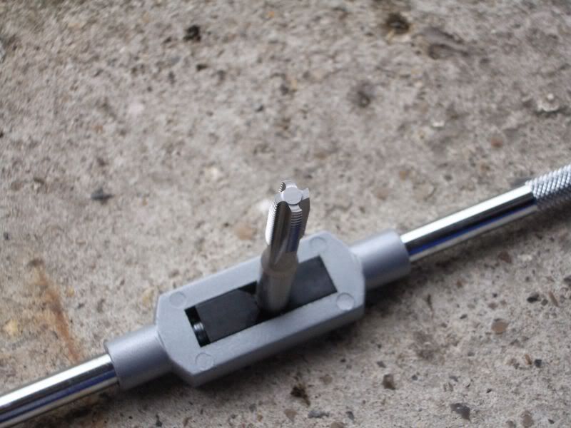

https://i221.photobucket.com/albums/dd227/serendipity_uk/RXS100/IMGP4966a.jpg
The shiny new tap. Note that the tap wrench is not included in the helicoil kit. I used one I already had.

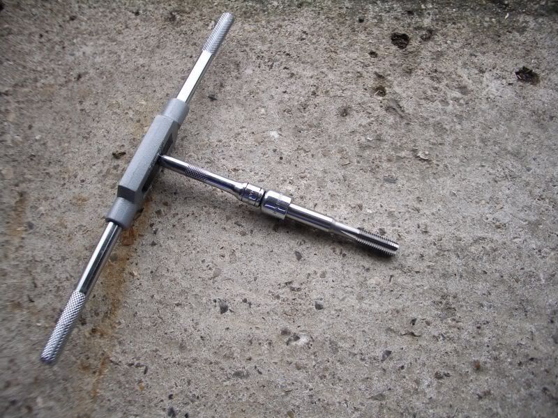

https://i221.photobucket.com/albums/dd227/serendipity_uk/RXS100/IMGP4969a.jpg
Then the first show stopper hit me. There wasn’t enough clearance between the frame rails to turn the tap wrench. A quick bit of desperate thinking came up with this bodged extension bar and I was back on track.

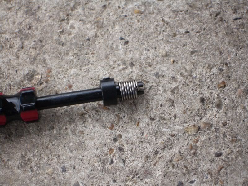

This is the insertion tool.
https://i221.photobucket.com/albums/dd227/serendipity_uk/RXS100/IMGP4973a.jpg
There is a slot on the tip into which a tang on the coil fits so you can screw the insert into the hole.

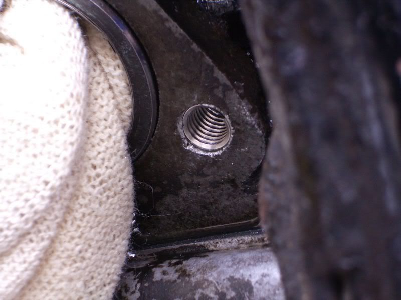

https://i221.photobucket.com/albums/dd227/serendipity_uk/RXS100/IMGP4974a.jpg
And there you have it. A brand new, steel thread in a soft alloy engine part.

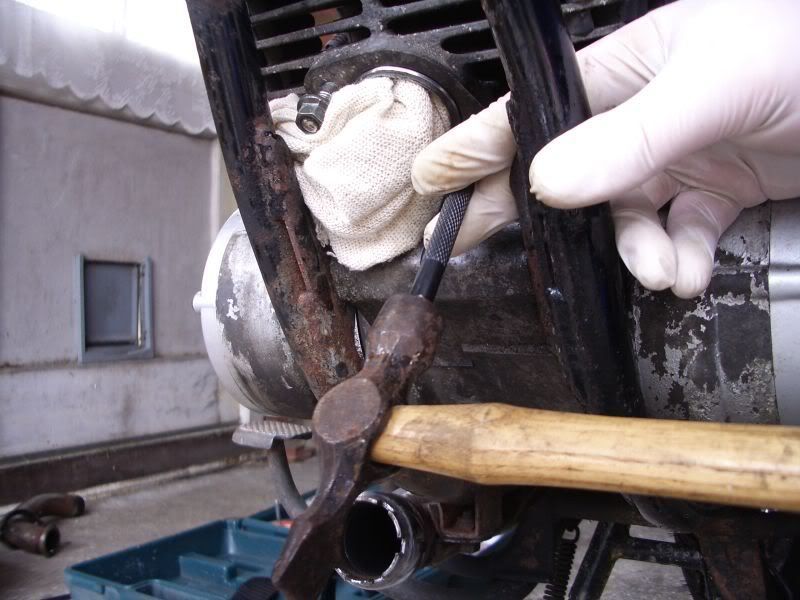

https://i221.photobucket.com/albums/dd227/serendipity_uk/RXS100/IMGP4976a.jpg
The only thing left to do is use the punch to beak the tang off the insert. The barrel on the RXS is tilted forward so the tang just fell out once broken off.
