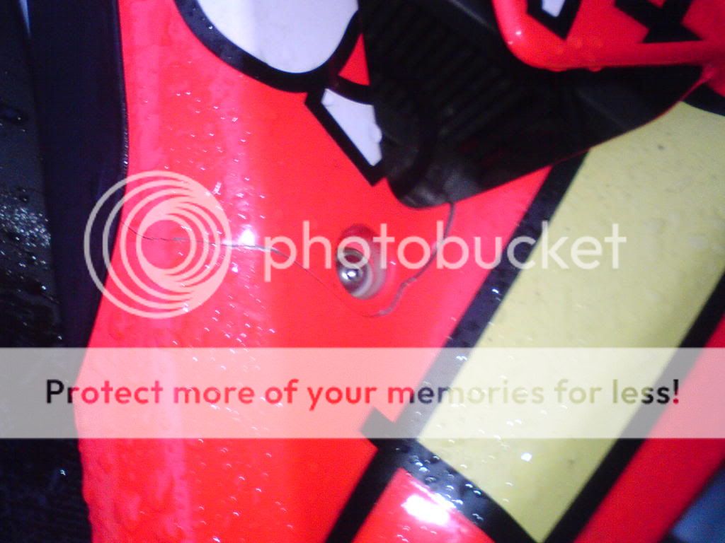

As you can see below I have cracked the side fairing on my RS50. It was really windy and it just got blown over while I had it parked on the road.
https://i272.photobucket.com/albums/jj166/kipposaurus/DSC00117.jpg
I'm presume I could just patch the crack up with fiberglass or something but I'm not sure what I should use so that it stays fixed. Or if I should even bother fixing it.
Does anyone else have any experience with patching up cracks?

I would use fiber glass on the in side and make sure the crack is closed
as much as you can.

I used superglue to fix my cracked panel but I'm cheap Laughing
It's held together though.

Plastech, excellent stuff, i believe a member on here sells it. excellent repairs of which go un noticeable if done properly.

drill a small hole like 2mm at the end of the crack to stop it spreading, then fiberglass on the inside like ^^^
Looks like it's from one end of the fairing to the other.... Wink
If your not bothered about how it looks,stitch it with cable ties Laughing
(I'd prolly go with the fibre-glass resin kit Thumbs Up

Plastic weld with a soldering iron and some old ABS or drinking straws.

I'd go with the plastic weld idea, as long as your fairing is plastic, of course. And melt a bit of extra plastic into it to give it more strength. Thumbs Up

https://www.sportrider.com/tech/146_9510_hand/index.html
https://www.youtube.com/watch?v=NuA6d49Z7Rc
https://www.youtube.com/watch?v=eq9TdHB73p0
Plastic welding is a good skill to pick up, just get some old scraps and give it a go. Just do it outside.

plastech is far more better , undestructable
wemoto repair kit , even expensive it's worth !

another vote for plastech.
used it loads of times without any problems (once i figured out you had to heat up the moulding bar, doh!)
them bottles look small but used it yesterday, on the cheap chinky plastic fairing which had split, & found i still had half left - 3 bikes later!
definately worth the tenner!

Thanks, i'll grab some of that Plastech stuff.
Will come in handy to fix the even bigger crack I just put in it! D:

After my little spill last Thursday it gave way so now I have plastic welded it on the inside with my soldering iron. Nice a strong now Cool
