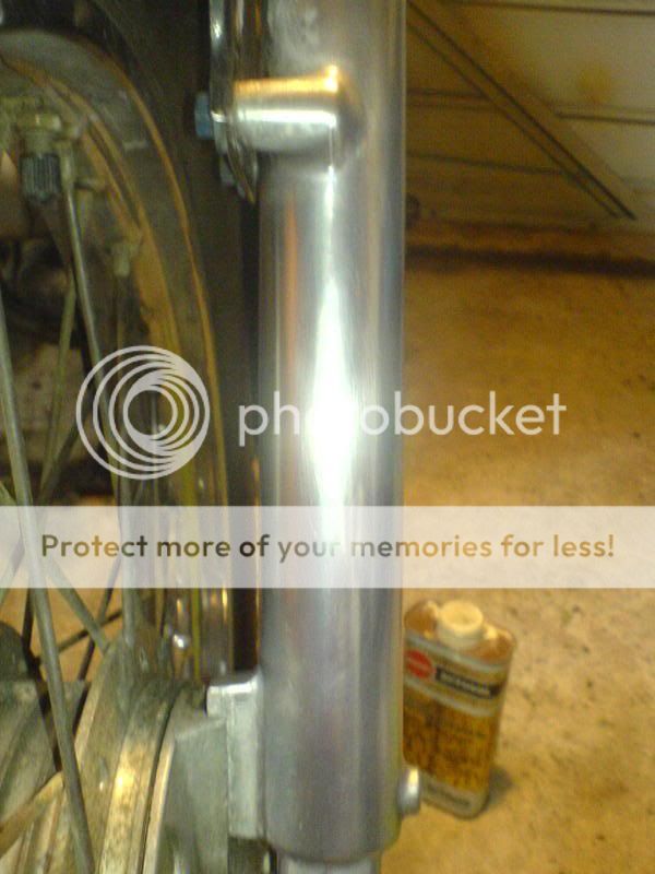

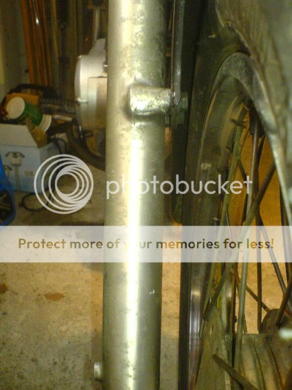

Do you mean the stanchions or the fork bottoms? If it's just the fork bottoms they clean up with a bit of sanding down and polishing up. I recently did mine.
https://i15.photobucket.com/albums/a376/ms51ves3/DSC00625.jpg
https://i15.photobucket.com/albums/a376/ms51ves3/DSC00626.jpg

very shiney, I am going to break out the autosol and I will attempt that before shelling out on new forks or chroming
