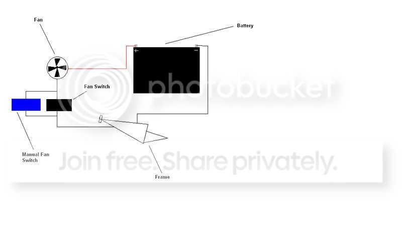

PostPosted: 14:55 - 03 Aug 2008    Post subject: Reply with quote
It does seem a bit pointless as if you are going over 3/4 throttle surely the amount of wind that is going into the engine is more than a fan could ever compete with anyway.
Oh well, here is a diagram.
https://i15.photobucket.com/albums/a376/ms51ves3/ManualFanSwitchDiagram.jpg
Joined: 29 Sep 2006
PostPosted: 15:16 - 03 Aug 2008    Post subject: Reply with quote
Gmanxiii wrote:
Halfrauds can supply the switch you may need to find somewhere to mount it (it was on the infill panel on mine) just stick the switch between the earth and wire.
I meant the temp gauge is showing 3/4 of the way and the fan still is'nt coming on.
It happens because i have to go through the tyne tunnel,which means being stuck in 20+min traffic jams (no room to filter),so id like to regulate it manually at about half way(the temp gauge) just while in heavy traffic...
Anyway,cheers for the pic Thumbs Up from that it looks the same sort of way i described..

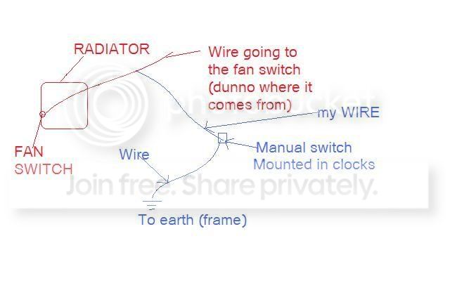

EDIT:
Your diagram's better,but this is what i was thinking!
https://i187.photobucket.com/albums/x13/fronterapics/wiring.jpg
DRZ-400sm
PostPosted: 15:58 - 03 Aug 2008    Post subject: Reply with quote
That makes sense.
All you are doing is with your manual switch, by-passing the automatic one so that current can flow through the circuit and the fan will then cool your engine.
Your diagram is wrong unless it is confusing me. By putting a switch in the middle of earth will do nothing. It will mean that if you had the switch 'off' the fan would never come on and your engine would overheat. If you had the switch 'on' the fan would come on when the automatic switch turns 'on'.
You would have to find the automatic switch, splice the wires either side of it and wire in your manual switch.
Joined: 29 Sep 2006
PostPosted: 16:21 - 03 Aug 2008    Post subject: Reply with quote
Damn, i hate anything to do with wiring Laughing
If i pull that wire off the fan switch (on the radiator) and press it on the frame,the fan comes on.
So i though the way i was gonna do it (my pic) would work because it will be the same as pushing that wire onto an earth when i flick the switch,but with the switch off would make no difference to the original wiring?
I'll have a mess about and see what happens Laughing
Cheers anyway Thumbs Up
DRZ-400sm
PostPosted: 16:47 - 03 Aug 2008    Post subject: Reply with quote
Yeah that works because you are pulling out the wire that is positive, then when you stick it on the frame it completes the circuit. So you could splice before the automatic switch, wire up your manual switch from that to the frame. It's the same as what I said apart from I was wiring it back to the other side of the automatic switch.
Your way would be simpler though because you only really need 1 wire then as you could earth it at the mounting point of the manual switch.
