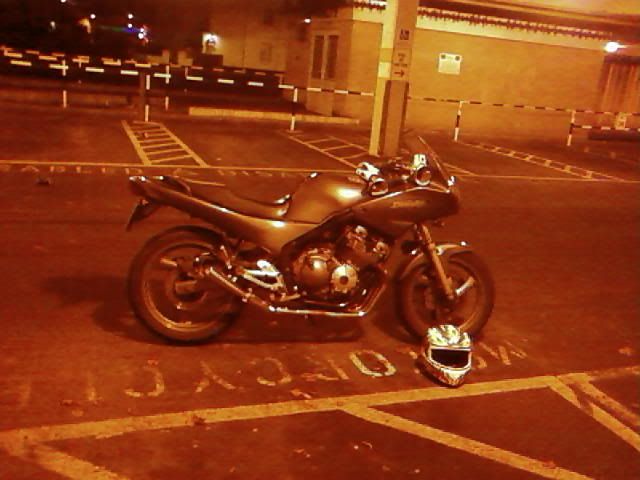

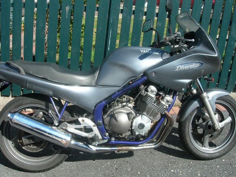

So begins the Divvy streetfighter.
Currently looks like this
https://i72.photobucket.com/albums/i192/stevie__d/DSCN1033.jpg
https://i72.photobucket.com/albums/i192/stevie__d/SP_A0095.jpg
Minus the bikini fairing.

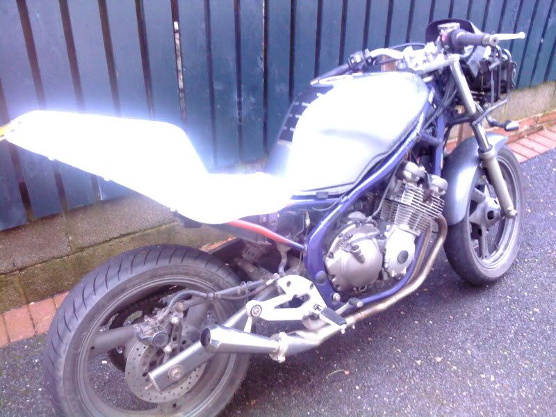

Excuse the shite quality phone pics and the chicken strips and the bald back tyre Very Happy
Haven't been out for a fun ride in about 4 months, just commuting, and my insurance runs out on the 19th so I can't be bothered to change the tyre plus should have a 160 section on the back soon.
https://i72.photobucket.com/albums/i192/stevie__d/Picture0026.jpg?t=1232652235
https://i72.photobucket.com/albums/i192/stevie__d/Picture0025.jpg?t=1232652273
https://i72.photobucket.com/albums/i192/stevie__d/Picture0027.jpg?t=1232652295
Seat is a bit higher than I wanted, but its alright. Number plate is temporary, will be mounted as far back on the undertray as I can get away with.
Got a smoked ducati back light which I'm fitting at the moment
R6 blue spots fit straight on with standard discs, boths mounting points are exactly the same IIRC its 90mm.
And have a sound clip https://s72.photobucket.com/albums/i192/stevie__d/?action=view¤t=DSCN1128.flv
www.southwestbikers.com
