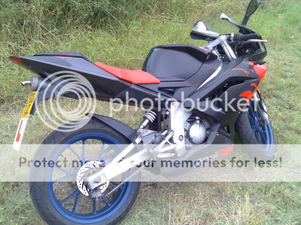

Went out for a blast with my mate today on my RS 50 and he was on his Speedfight 2 Iron-X.
Went from Enfield in North London up towards Harlow on the A10.
Quite a good blast up that way and got an indicated speed of 68mph.
Not sure how accurate that actually is but I think a 60 true speed is realistic Thumbs Up
Anyway had to slow down for my mate on his Speedfight all the time so we decided to hit some country roads so onto the A414 from Harlow it was Thumbs Up
Bike was running well and really enjoying all the twisties Razz

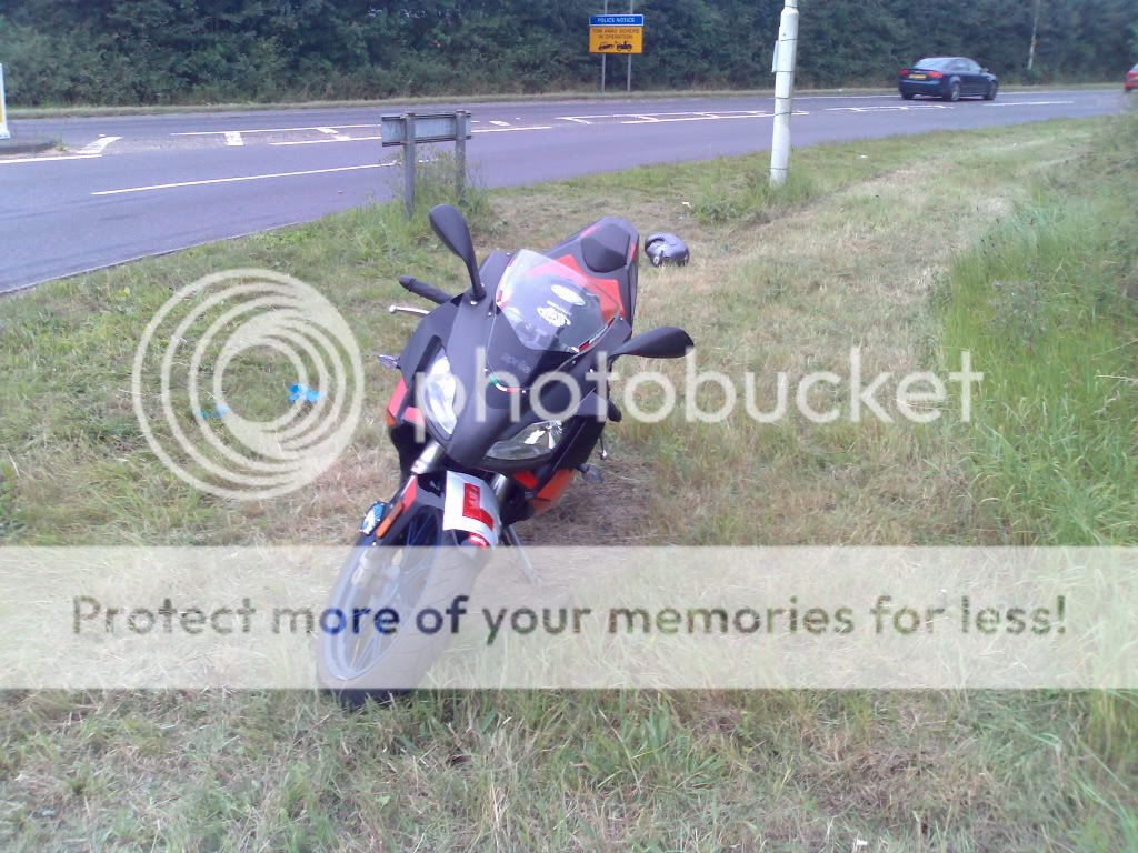

Coming up to a roundabout on the outskirts of Chemslford.
The roundabout with Greenbury way and Margaretting Road just outside Writtle.
Just as I approach the round about I kick down to 2nd and all of a sudden screeching.
So I'm like WTF Confused I pull over and check all the essentials. Petrol, Chain, 2 Stroke and everything I could check and fired it back up and it starts screeching again Neutral So I'm like really confused by this point and begin to think I've blown my top end Evil or Very Mad but then I clutch in and it revs without screeching. So I assume that the engine is fine and my gearbox has blown.
So called up the house and got my Mum to call me a recovery truck for £80.
But they took about 1.5 hours and this guy pulled over and had a look for me. He reckons the clutch bearing but I had never heard of this so I was confused. But he helped me stand it up right as it was sinking into the grass and stood around talking for a good hour and I offered him a drink for his help but he insisted not to take it. Top geezer Thumbs Up So my mate rings his Dad about it and he says because I can pull away in first with the noise but not get into 2nd it must be the gearbox.
So whilst I was waiting I thought I'd take a video and some photo's for all of your interest's Thumbs Up

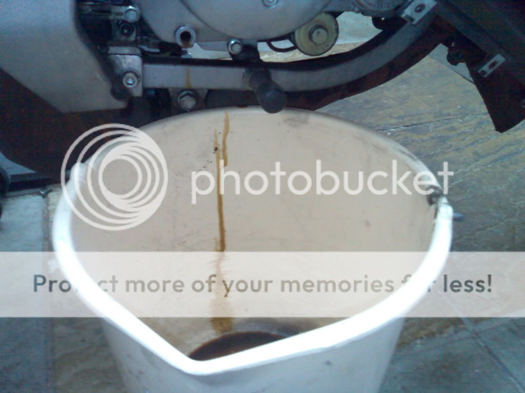

Got home and drained my gearbox oil but hardly any come out
https://i298.photobucket.com/albums/mm255/DeclanJ/13042006285.jpg
I think this could be the problem?
I'm going to fully drain it and then refill it. If the problem stays I'll check the clutch plates and hopefully that will sort it as I can't be forking out for a new box Sad

I expected the oil to come pissing out but about 75ml came out.

Think I have found the cause.
Whilst draining gearbox oil, the drain point on the bottom is leaking out gearbox oil.
Obviously the last owner hasn't done it back up properly.
I'm hoping it will just refill and work again.
