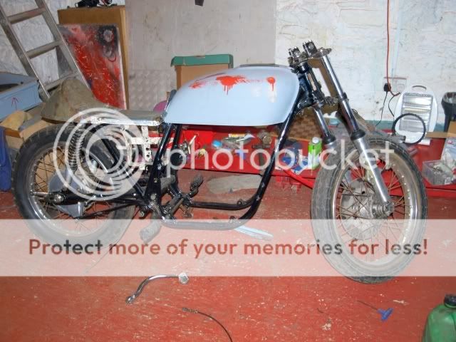

Today I got round to "starting" the project properly:

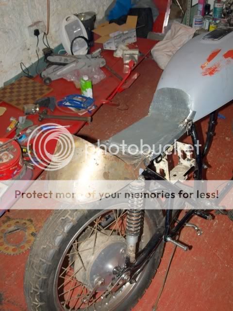

First job was to make a humped single seat, it's based on one that I had lying around:
Here is what it looked like when I started:
https://i155.photobucket.com/albums/s297/honda_tlr/DSC01201.jpg
I then cut the hump off
https://i155.photobucket.com/albums/s297/honda_tlr/PB283493.jpg
https://i155.photobucket.com/albums/s297/honda_tlr/PB293502.jpg
https://i155.photobucket.com/albums/s297/honda_tlr/PB293504.jpg
BEFORE:
https://i155.photobucket.com/albums/s297/honda_tlr/P9303352-1.jpg
After: (Yes I know it doesn't look like a huge job to do, but more work has gone in to making it than what it looks)
https://i155.photobucket.com/albums/s297/honda_tlr/PB293507.jpg

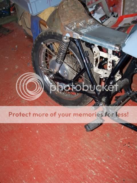

Rearsets: (well, improvised M10 bolts for now) Laughing
https://i155.photobucket.com/albums/s297/honda_tlr/PB293509.jpg
I have still got the front edge to finish off but it gives you some sort of idea what it's going to look like:
I'm ashamed to admit it took me around 5 hours in total, I don't have any specialist tools like metal folders or such like, just a grinder, welder, tin snips, and a few hammers, didn't even use a tape measure, it's all done by eye.
I had to do a lot of panel beating with a ball pein hammer and a sand bag, as you can just about see in the before picture, the seat used to curve upwards. and I also had to cut near the rear of the seat and move the sides in, as the frame is narrower where the seat is situated now, as I have also cut bit's of the frame under the seat.
The good thing is it's made to measure so fits both me and the bike, and has saved me quite a considerable amount of money.
Opinions/ comments are most welcome, I'd like to know if you think it looks "right" or not?
Note: The last picture shows where the rear-sets are going to be, compared to the std footrest it's quite a bit higher and with the seating position as it is it's actually much comfier with my feet higher up and backwards slightly, compared to in front and down ( Where the bolts are is where the rear-sets will be once made)
https://i155.photobucket.com/albums/s297/honda_tlr/PB293510.jpg
Thanks for reading, Jamie.

Why not just use the first seat instead of cutting and trying to fabricate a new one that looks exactly the same?
Jamie S
Joined: 28 Dec 2006
PostPosted: 22:04 - 29 Dec 2008    Post subject: Reply with quote
It was way to long and too wide, hence why I had to shorten it and make it thinner.
The front section was also rusted right though in some places
hmmmnz
PostPosted: 11:46 - 30 Dec 2008    Post subject: Reply with quote
gotta say jamie, you have more nouce and mechanical ability than 95% of the plebs on this site,
keep it up, i like seeing your projects Thumbs Up
i think you shoud cut of the part of the seat unit that is touchong the tank,
have it end at the base of the tank, only the soft padding should be touching the tank,
looks good though, almost flat track racer Very Happy

Bit of a pointless comment, but; if you made that hump out of aluminium and then polished it then it would look like a proper old-skool cafe racer Cool

i think by using the pillion peg mounts for rearsets you'll find you've moved your feet back too far....
i'd be tempted to look around for some modern rearsets (or make my own) and cut off the pillion mounts, weld my own tabs to the frame so they are mounted exactly where i wanted them ....
seatbase is looking good, but i agree with the other posters comment of not having it rise up the back of the tank, get the foam cut and covered professionally, i'd probably look at having the hump covered with material as well for a proper period look (i had to make a seatbase myself a few weeks ago, fun getting the folds in the correct places with minimal tools Mr. Green ) ....
keep us updated with your progress, lots of pictures please Mr. Green

What is the rear wheel clearance like aginst the seat unit when you are sitting on the bike.
