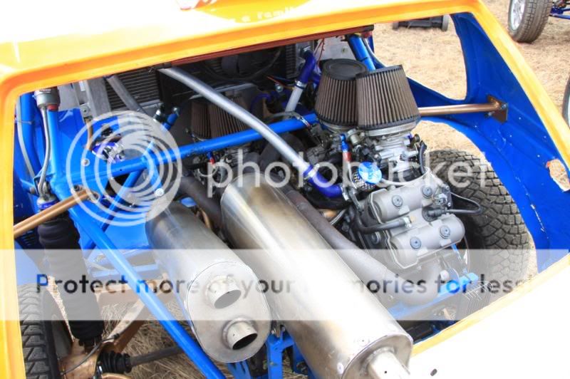

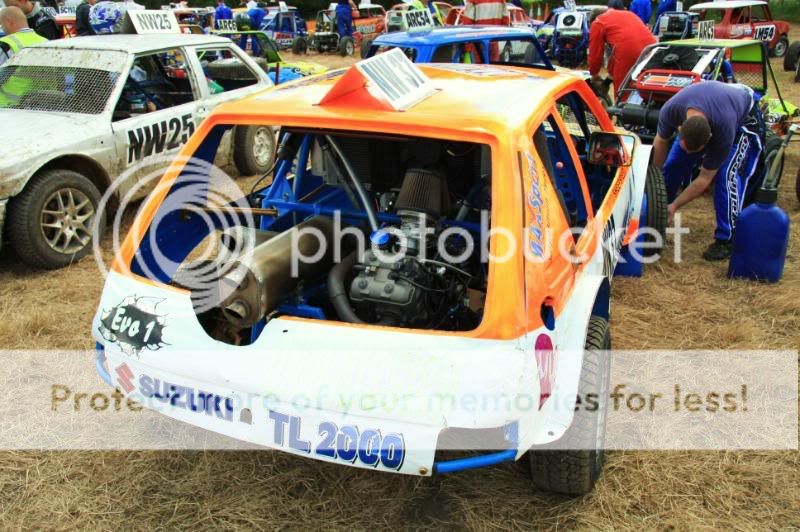

Not had a bike since i sold the Hayabusa in April 2007.
Thought it was about time i got that high revving feeling again so..... i decided to go back to Suzuki.
Check it out 8o)
https://i19.photobucket.com/albums/b165/JohnSmith220/LEEWOOD%20A/IMG_1828.jpg
https://i19.photobucket.com/albums/b165/JohnSmith220/LEEWOOD%20A/IMG_1978.jpg
https://i19.photobucket.com/albums/b165/JohnSmith220/LEEWOOD%20A/IMG_1827.jpg

Is that what I think it is Laughing
What are the specs? that thing looks hella cool.
PostPosted: 10:56 - 02 Sep 2008    Post subject: Reply with quote
Isn't 2 TL1000 engines a bit greedy?

GREEDY LOL, naaaaa ya wanna see some of them.
There are Fiat Cinqucento's with twin Hayabusa 1500cc in them and some with twin Blackbirds.

Hows the transmission converted to the wheels?
The crude way would be to just weld a sprocket, but with 2 engines?
Johnny GSX-R
Joined: 14 Feb 2005
PostPosted: 02:12 - 06 Sep 2008    Post subject: Reply with quote
2 sprokets on a shaft with drag bike chains which then go into a Berrisford drivebox and come out in the form of Granada Mk1 shafts. There's no diff, its a direct live axle.
2 engines, 2 boxes and 1 cable operated gear lever.
The drivebox is mounted on a sliding frame to allow the chains to be tensioned ect.
